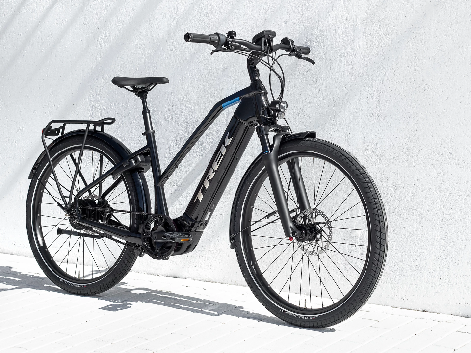

However the commuter Trek Allant+ 9S feels much more like it and, while noisy, it quiets down at higher gears. It just makes me wonder, what kind of tuning is done to the All Terrain compared to the Commuter... Their geometry does not look that much different to me.
I cannot tell you :) Still, I believe you would be very happy with the Allant +9s. I am very familiar with that e-bike type/specs (my "high performance ride" is Vado 6.0, which is very similar to Allant+ 9s, only derailleur not the carbon belt/IGH).

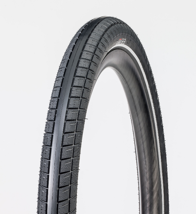

Not. It is negligible. The different tread could, however, matter. An aggressive tyre tread can "eat up" several km/h from your ride. For instance, the Bontrager E6 for the Allant+ 9s is a fast rolling tyre with good enough traction in rough terrain. Not sure what tyre is offered with the "all terrain" e-bike?

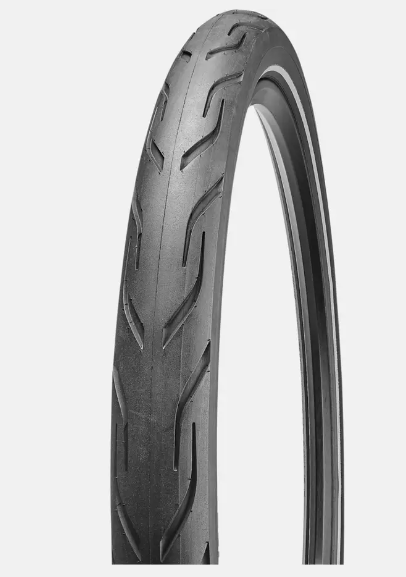

(During my warm season rides, I use Specialized Electrak 2.0 Armadillo/Gripton tyres that are very similar to Bontrager E6 in the terms of the rolling speed and traction).
Bontrager E6 Hard-Case Lite. (60-584). See the hard central tread for low rolling resistance, and the outer knobs for traction.
Specialized Electrak 2.0 Armadillo with Gripton compound. (51-622). The traction of this tyre results from the soft & fast Gripton compound.

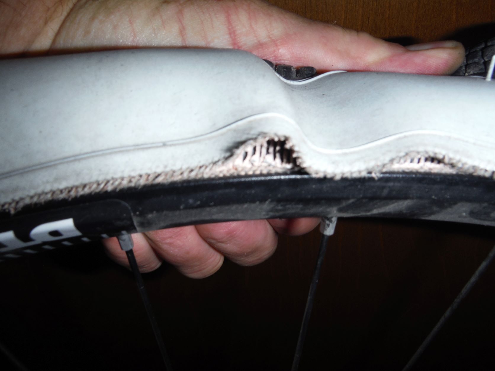

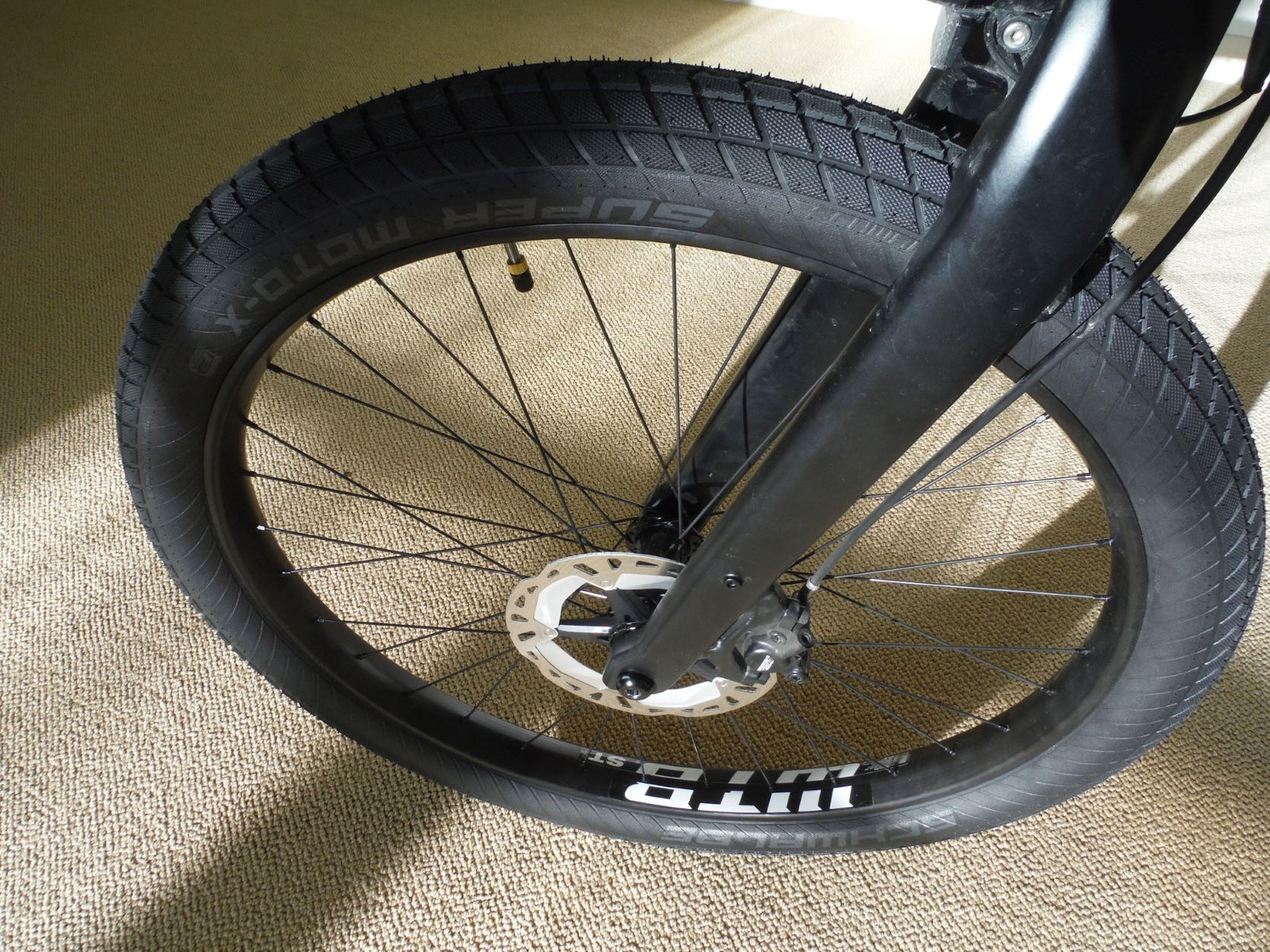

Rubber does make a difference. This bike just got new wheels and new tires. The Schwalbe Super Moto X tires are so much faster than the original whitewalls that were de-laminating. This is not my 'style' of bike; it weighs something like 41Kg. But the owner likes it. The 120Nm motor destroyed the cheep rear hub and the front wheel's rim was about to sheer at the valve.
