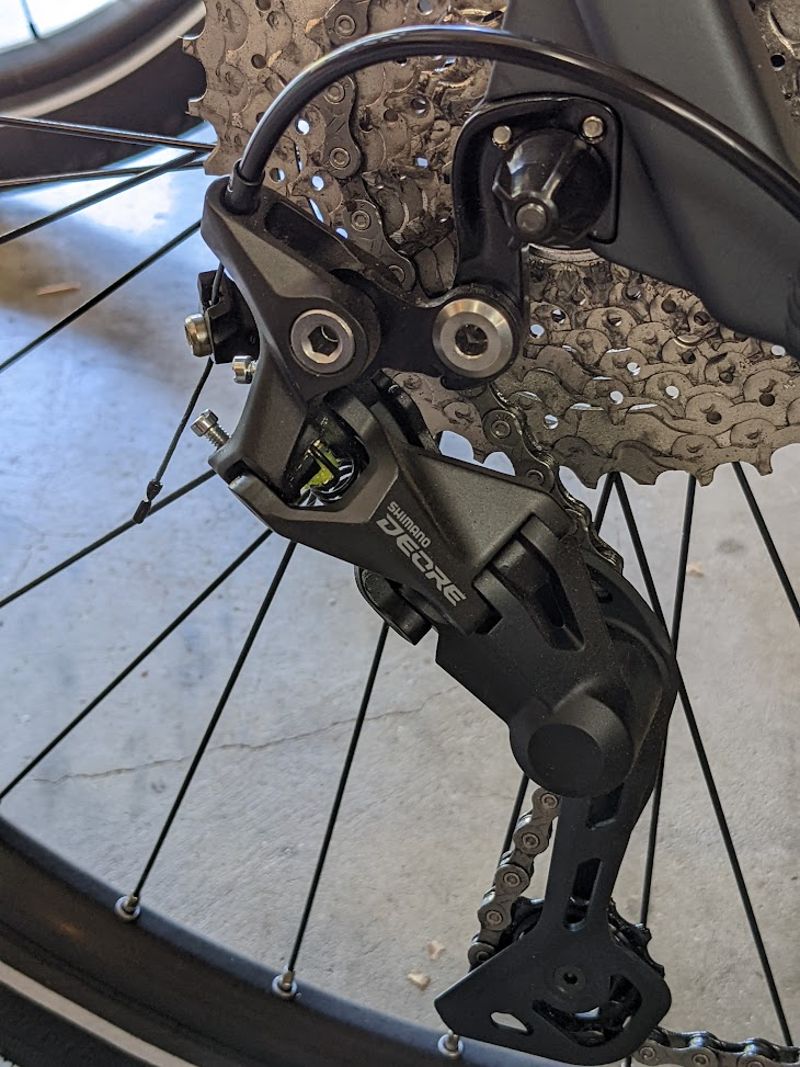

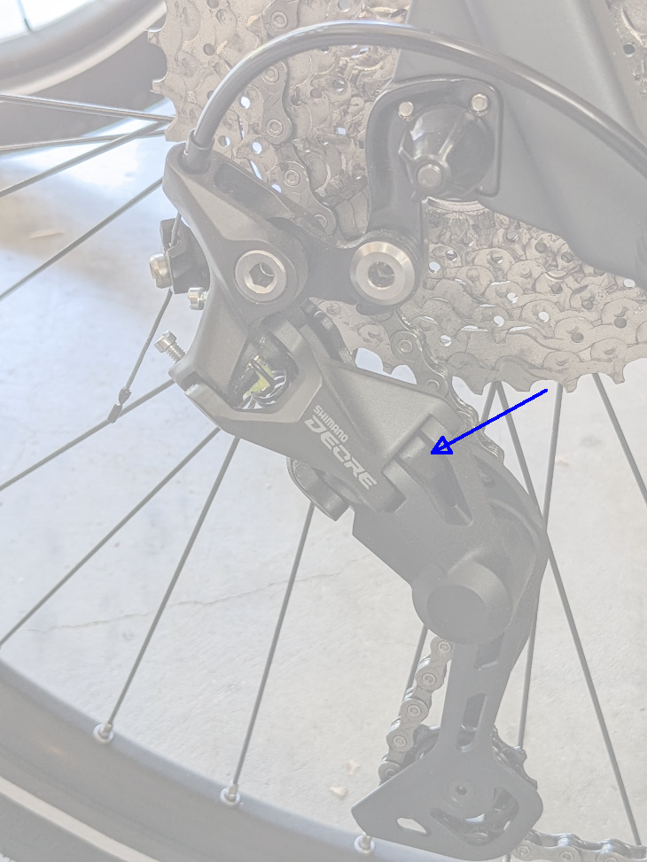

Attached a pic of the derailleur. I don't see a clutch there.
I cannot understand it. The Shimano Deore RD-M4120-SGS is describer as a "Shadow" derailleur, and Shadow is for the clutch in the Shimano systems.
What thing is it? Can you move it forward with your fingers?
In the photo that looks like it might be a separate movable part but its just the way the piece is made. It is solid.

Have you tried putting on a bit more chain lube yet? Things do look a bit dry on the chain and cogs in this photo. It's a long shot but it may help.
I'll give that a try. The shop lubed the chain last week when I tried to get them to fix the issue but it does feel a bit waxy and stiff.
