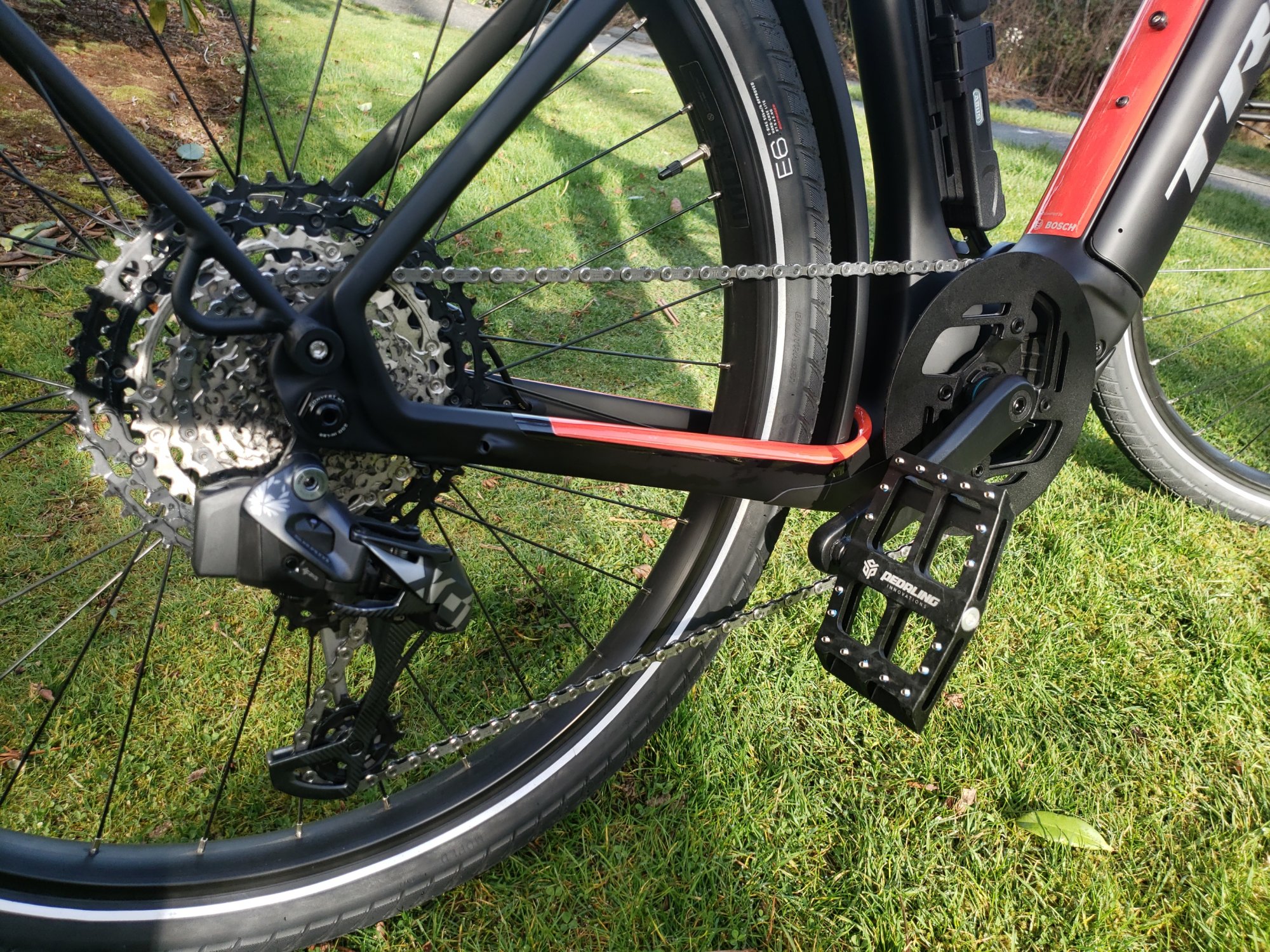

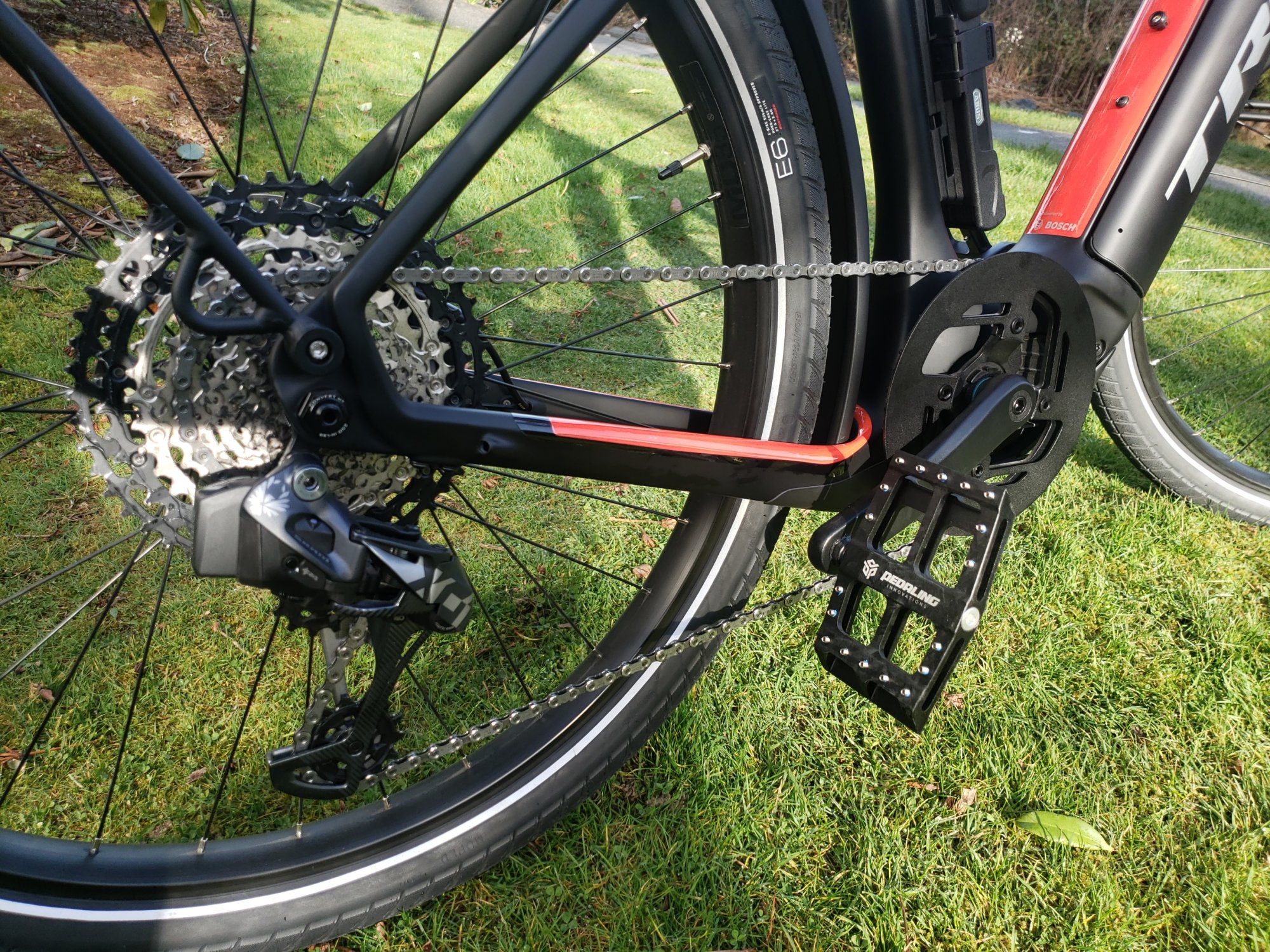

I just had the Sram X01 AXS upgrade kit installed on a new Trek Allant 9.9s. The bike's drive train is Shimano xt8100 12 speed. It is seamlessly compatible with the Shimano XT CS-M8100 12-speed MTB 10-51T,Micro Spline .
Alaskan-Great! Thanks for pointing that out. I was mis-informed by a bike tech that you can only use the AXS system with SRAM products. I have the Shimano Deore XT, and they stated that the upgrade kit could not be used. More points to ponder. Perhaps there may be a workaround?
Bob, the Deore XT is an 11 speed, is it not? The Sram AXS sytem is for 12 speed cassettes. I believe you can upgrade the XT with the DI2 - wired electronic system by Shimano.
Okay. I was told that the Shimano system has some bugs that need to be worked out and to avoid it if at all possible. I am also a big fan of the battery setup in the AXS system opposed to the Di2. Thanks for the heads up.
I believe the Di2 can be powered off a Shimano drivetrain battery. The SRAM AXS has its own batteries. That can be good or bad depending...
Yes, one of the members here did that on their Motobecane eBoost with the E8000. Certainly a great addition/upgrade to any E-bike with a Shimano motor system with minimal parts to complete the install to Di2.
