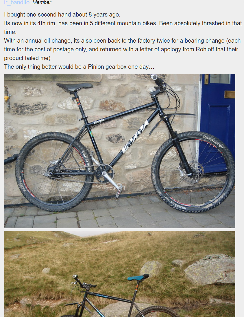

This guy does put his bikes through very punishing conditions and if he can vouch for a product, that counts for something.
There are a lot of people like him. I jumped on a Rohloff-equipped e-bike with literally both feet because I've ridden touring and mountain bikes with them and in my experience they were indestructible.
