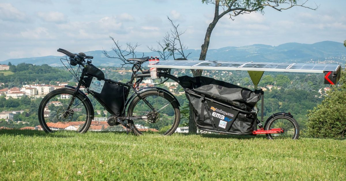

This thing weighs 251kg (549lb), has a 15,500Wh battery and has only 116Nm of torque!
Another perspective :)
