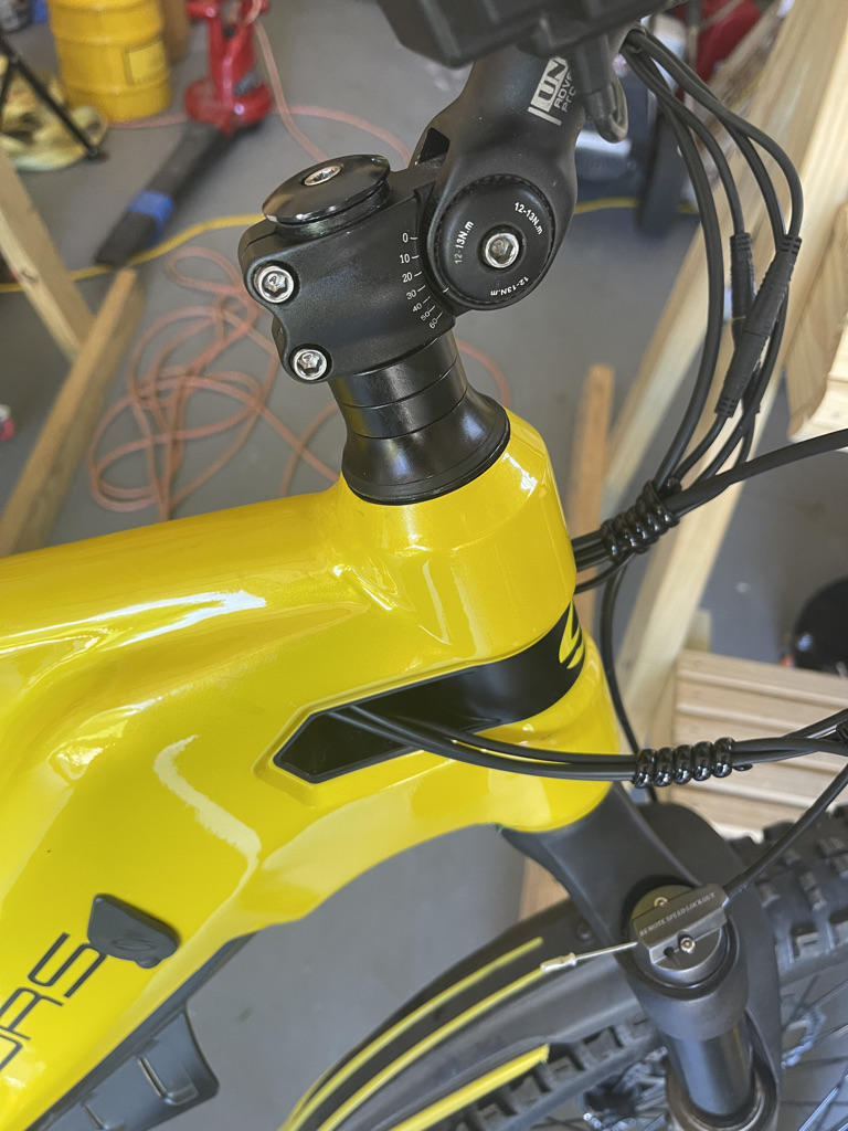

Is this play at the headset?
Yes. Here:
I had some play in mine when I first got my bike. Turned out being the compression ring not seated. It seats where the fork tube comes out of the head tube and the upper bearing. It's gotta be pushed all the way down. If you still have a problem, file a ticket on the Sondors web site for tech support . They have been fantastic on solving any problems

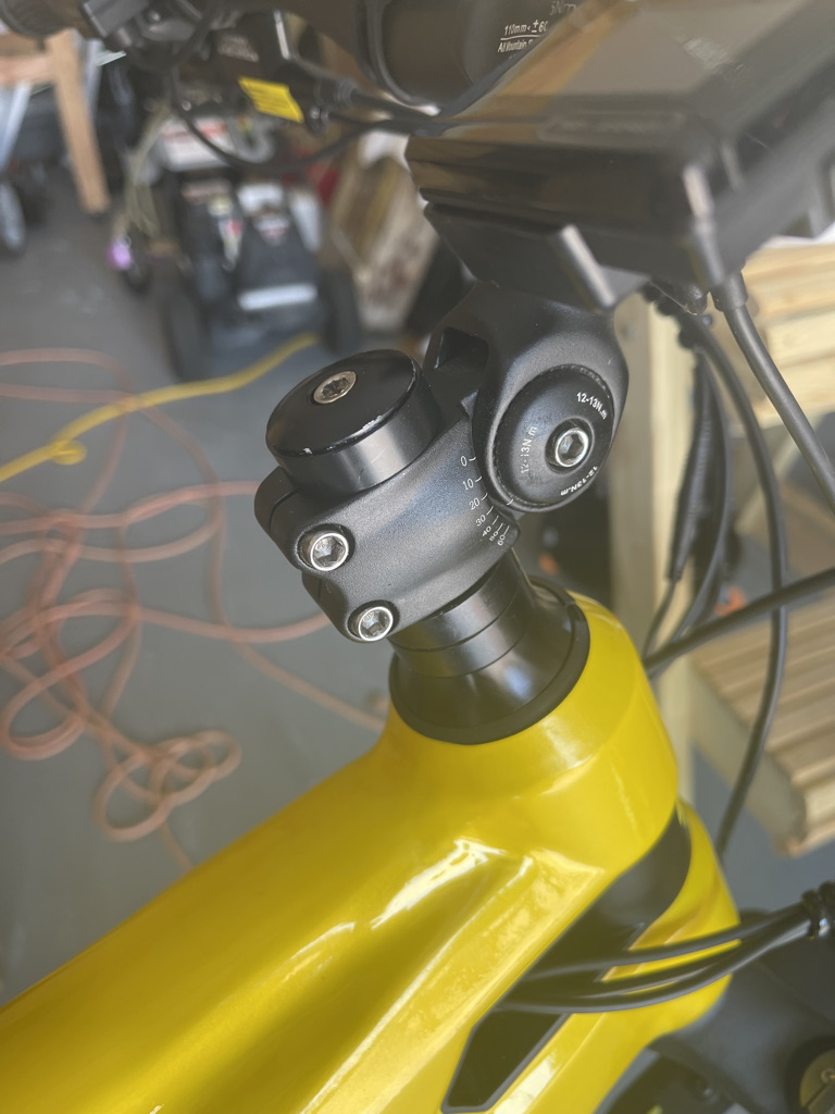

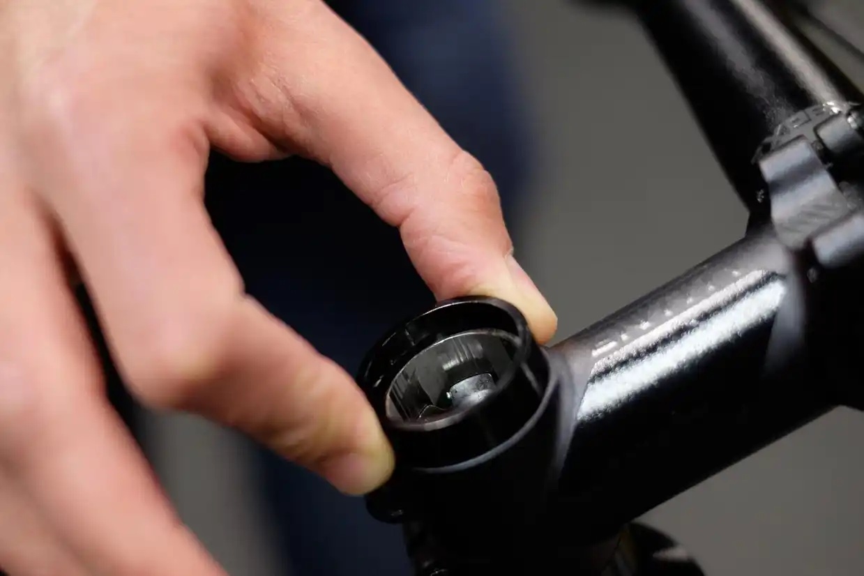

Howdy r.lee, I have had some rattling coming from that area and despite numerous attempts have not been able to resolve it. I have done as DeMedici and others advise by including 3-5mm of space between the steerer tube and the top of the stem/spacer. Apparently this is needed to ensure there’s enough space for the headset top cap to clamp down and pre-load the headset bearing. (see image) I'm not sure if this applies to your problem, but it may.
Thanks to all for taking time to provide the good information and pointers related to this issue. Sondors support also provided me feedback on spacer placement. Will work on getting spacers in the proper place(s) to relieve the problem. Thanks again, r.lee :).
Great. If you don't mind, please share the information you received from Sondors. Thanks

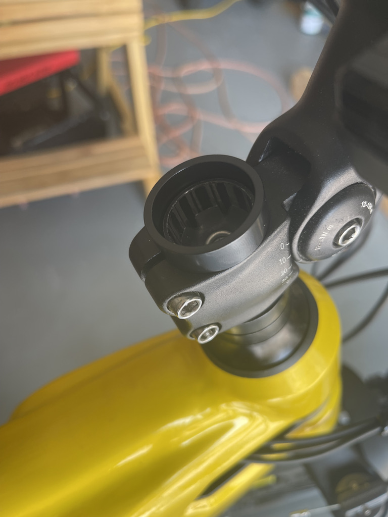

Thanks again for the responese. Problem solved, no play. Picture of the cap in place with the new spacer, plus a picture with new spacer before adding the cap.This picture looks very similar to the one Webopus posted.

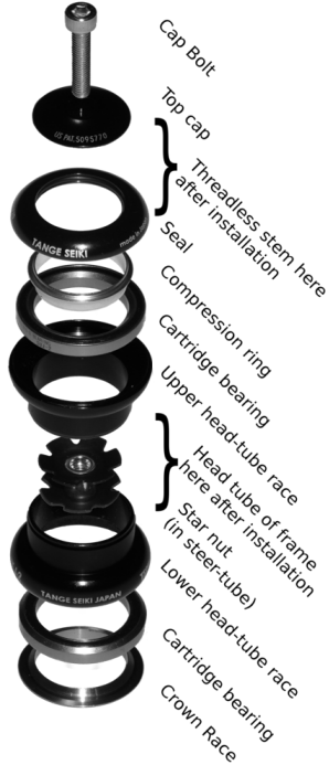

Are you still running the stock forks? There is something wrong for sure. I'd also remove the forks and throw some grease on the upper and lower race bearings and work from the bottom up on the head set to make sure everything is seated properly
Here is an exploded diagram on the head set components

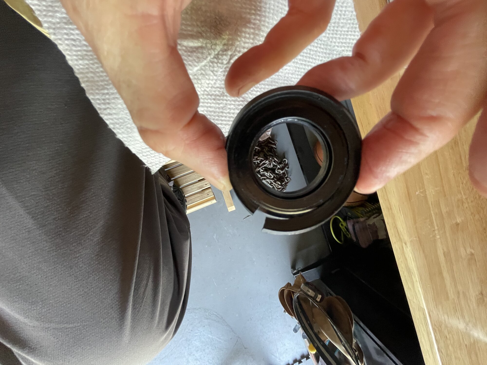

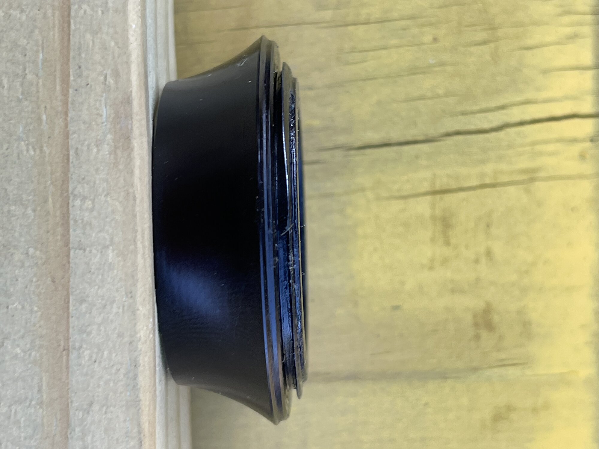

Cross-Up and others thanks for the comments and the diagram. To make this short, below is what I sent to Joshua at Sondors support. I think I damaged the piece that connects to the headset. Here is what I sent Joshua:
"Joshua,
Turns out the situation where I had some "play" in the Rockstar headset is not resolved yet. When I added larger spacers and tightened the cap screw the "play" went away, but the handle bar steering was way too tight. After looking very closely at the bottom piece (see picture from previous email) that is below the stem and the two spacers and joins the whole stem assembly to the headset, I saw that it has been bent/damaged some, so that the round rubber attachment does not fit correctly and snuggly. I probably damaged it during my efforts trying to take care of the "play". Bottom line, can I order this part and the companion rubber part, or a package that has both in it? Thanks for your help...
Here are pictures:"
In just a few minutes Joshua returned my email and to tell me he ordered a part already under warrenty.. Wow!!

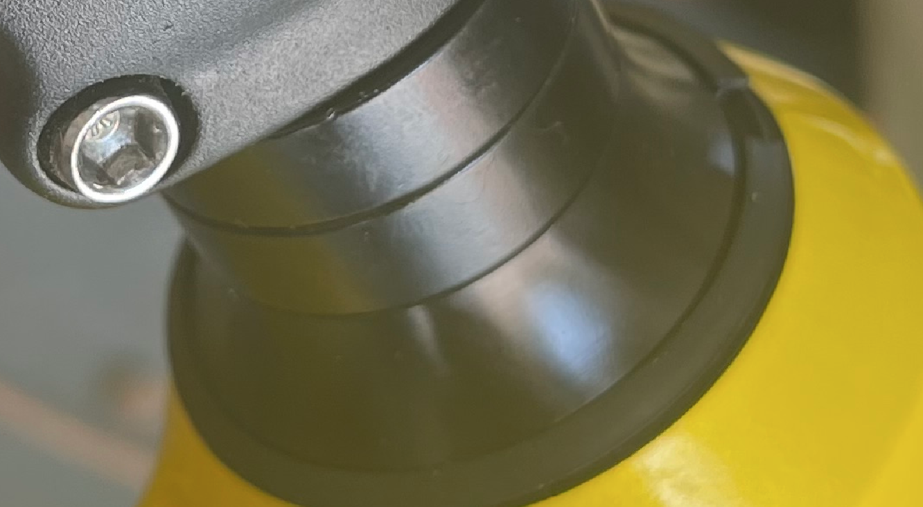

If you look close you can see the damage to the piece.
