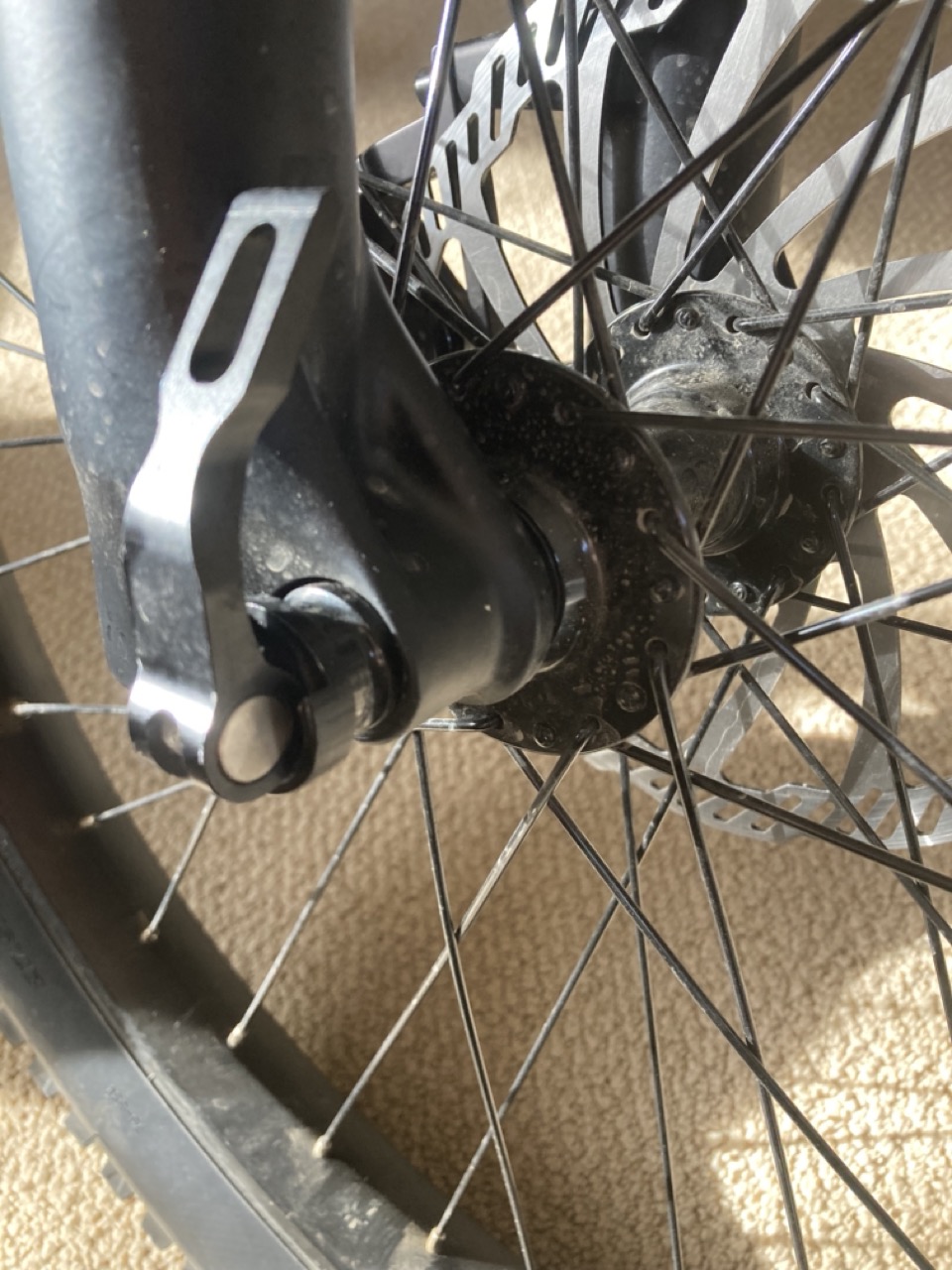

Just received mine. It’s got some minor damage on the body. I’m trying to put the front wheel on, but cannot budge that quick release/axle. I dont want to take a pliers to it in fear of damaging it. How can I get this thing off?
Hi - You may need to wrap it in something soft and use a plier to twist it. Please post an image of the quick release mechanism in its current state. Mine was slightly different than it appears in the Sondors assembly video. There was an aluminum sheath around the axle and it was difficult to remove the axle. I twisted the locking mechanism so far that it actually fell apart. Took me a while to resemble it. For me, this was the trickiest part of the Rockstar assembly process.
Can you show an example of your quick release? Was the sheath a temporary thing or it’s part of the axle?
The sheath was temporary. Only for shipping. You can discard it. You should be able to pull down on the black quick release latch and slowly turn counterclockwise to loosen.
