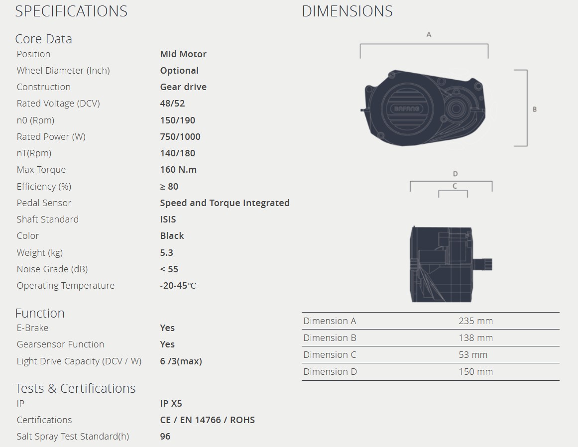

I spoke with a Sondors rep yesterday and she said that the entire line of Sondors Elite ebikes have the same motor which is only 95nm. The review for the Sondors LX on this website says it's 160nm. She told me that was wrong and 95nm is what she has on her spec sheet. I looked through this thread and did not find anyone talking about this. Is this a known thing?
Turns out 95nm is correct, I'm updating the LX review to reflect this. The Ultra motor is capable of 160nm of torque, but it's not putting out that much due to how it's configured on the LX (and presumably the rest of their Elite line).

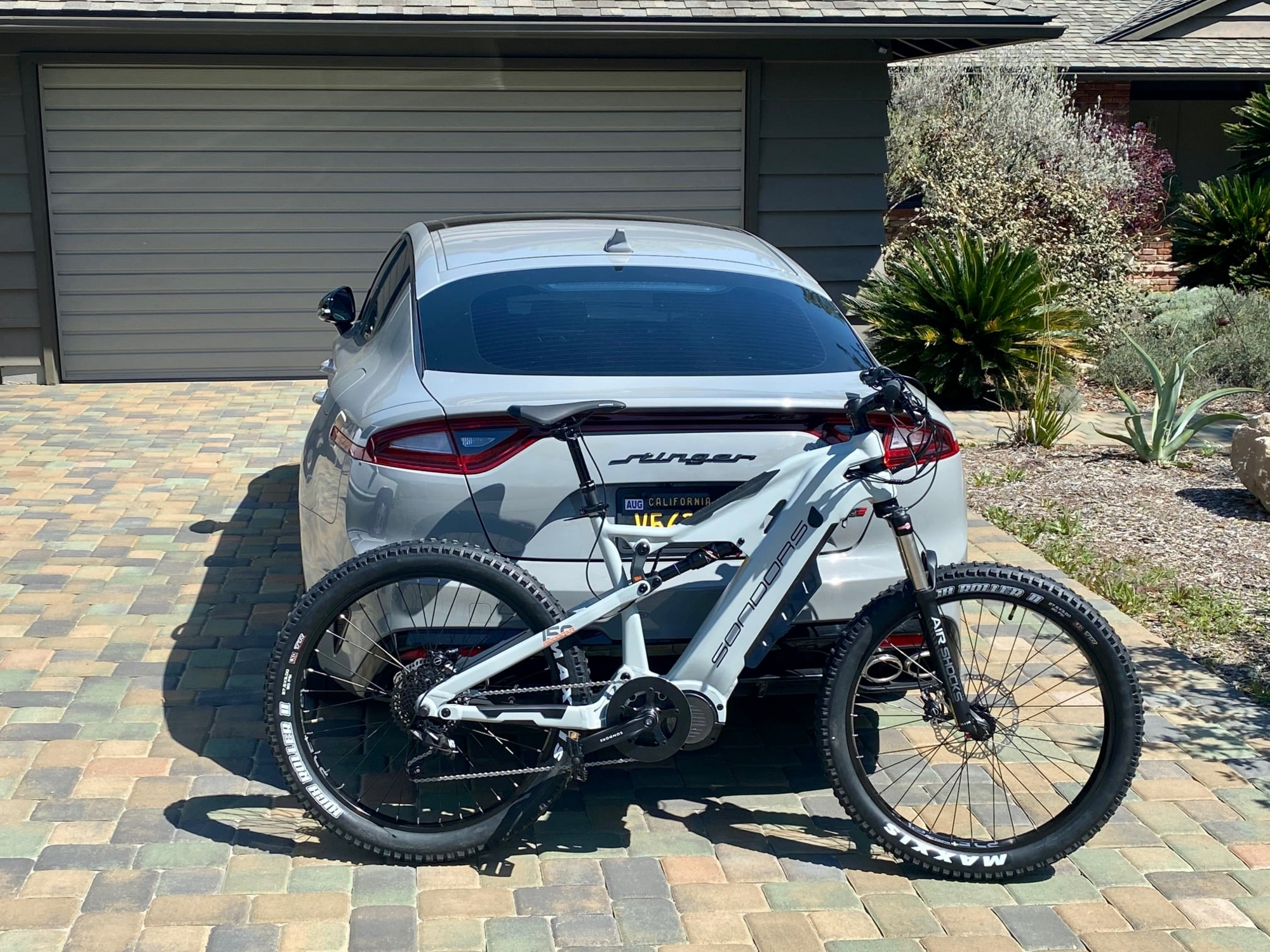

I am not a reliable source. Do not trust me. Here is what I found.
Low Saddle, Pedal to Saddle Height 78c
Low Saddle, Ground to Saddle 95c.
Max, Pedal to Saddle 95c
Max, Ground to Saddle 114c.
The battery charges to 90% when it is in the off position and automatically stops chagrining. Flip the battery ON for the last 10%.
The weight is 19.3Kg front and 19.65 to the rear. That is about 88-pounds. Sorry, it is hard to photograph an LED with a flash.
No fenders were included.
This bike is very loud, it whines. The motor continues to power forward for about 2.5 seconds after the rider stops pedaling.
Finally and anecdotally, I rode a bike path which crosses train tracks. Posts and fences are setup so that a rider must slow and weave so as to not plow at full speed into a train. This bike did not handle well with the weaves. It felt clunky.
Why should it be just 88-pounds when I put 225-pounds into the frame's suspension?

That motor is very capable of doing much higher numbers.
Watt Wagons has a version that runs 3000W, but you can only ride it for 1 hour.
When they say it's powered down to 95nm it's because they downgraded the controller to 25 amps.
But then you do the math even with that slagging of the power 25A X 48V = 1200W peak output. Rated at nominal 750W to stay within current laws.
Are you telling me 1200 Watts can only produce 95nm on that motor ?
They are the very first company to downgrade the ultra motor in such a large way, stock controller is 30amps so 1440W peak, can you seriously believe a difference of 240 Watts is pulling that nm that far down?
The upside is you will never burn this motor out on this Ebike as it's made to do so much more. That fact that he broke a chain shows the power of this motor, but if you have read enough forum posts on the Ultra that is the number one complaint on that motor, it eats chains if you really push it and don't figure out the gearing. He mentions throttling, it even being part of the cause of the break of the chain going up hill. Watt Wagons puts a 750W limiter on their throttle to prevent their way more powerful motor controller from killing it's components. But a Gates belt is one answer, but even then the CVT can't handle all that power it kills them on the instant power via the throttle. But it can handle the gradual build up of pedaling.
Here's what I think, Sondors went to Bafang and said what does 750W of power produce on the ultra for nm, the answer is 95nm. They probably also have limiter on the throttle at 750W just like the Watt Wagon again 95nm from a certain point of view. However if you go into the display and crank everything to the max and pedal like mad in the highest possible setting without the throttle, you are pulling up more than 95nm.
