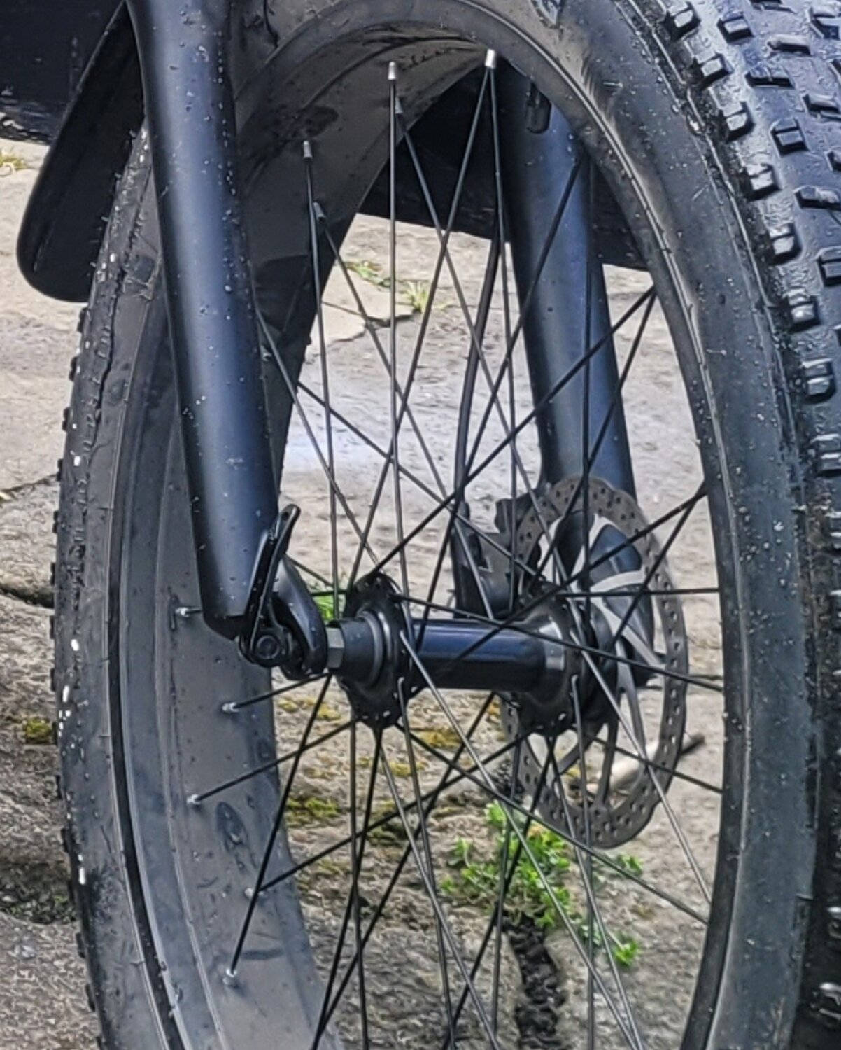

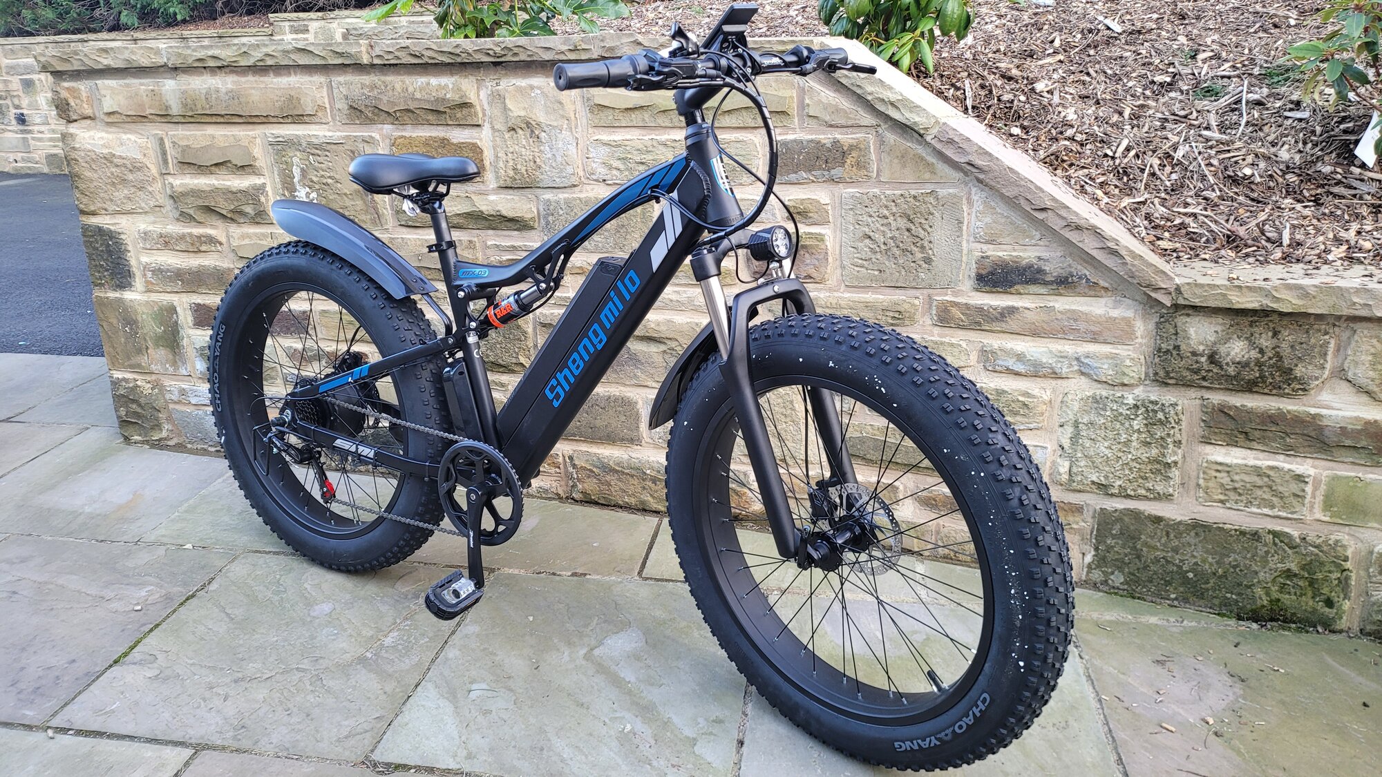

Hello I have a shengmilo mx03 I just wanted to know from you experienced guys if anyone could tell me how to find out if the blutos would fit my bike regarding hub size and axle size etc i'm pretty new to installing forks so I'll get the lbc to do it but I just wondered if these would fit or how I can find out any hello appreciated

The front wheel on the Bluto is secured with a 15mm x 150mm thru-axle. Your bike appears to have a quick release skewer. The two, QR & Thru Axle, are not compatible. At a minimum, you'd have to have your local bike shop lace on a thru-axle front hub to your fatbike. (And of course, fit the front rotor to the new hub) But before committing to all of that, you'd want to have the lbs ensure the steerer tube on your bike will fit the Bluto.
Does your frame accept tapered headtube?
If not, you'll need an adapter.
It's OK I didnt buy them even though they was a bargain, I might by a redshift handlebar stem just to stop vibrations I don't go crazy downhills just cruise
