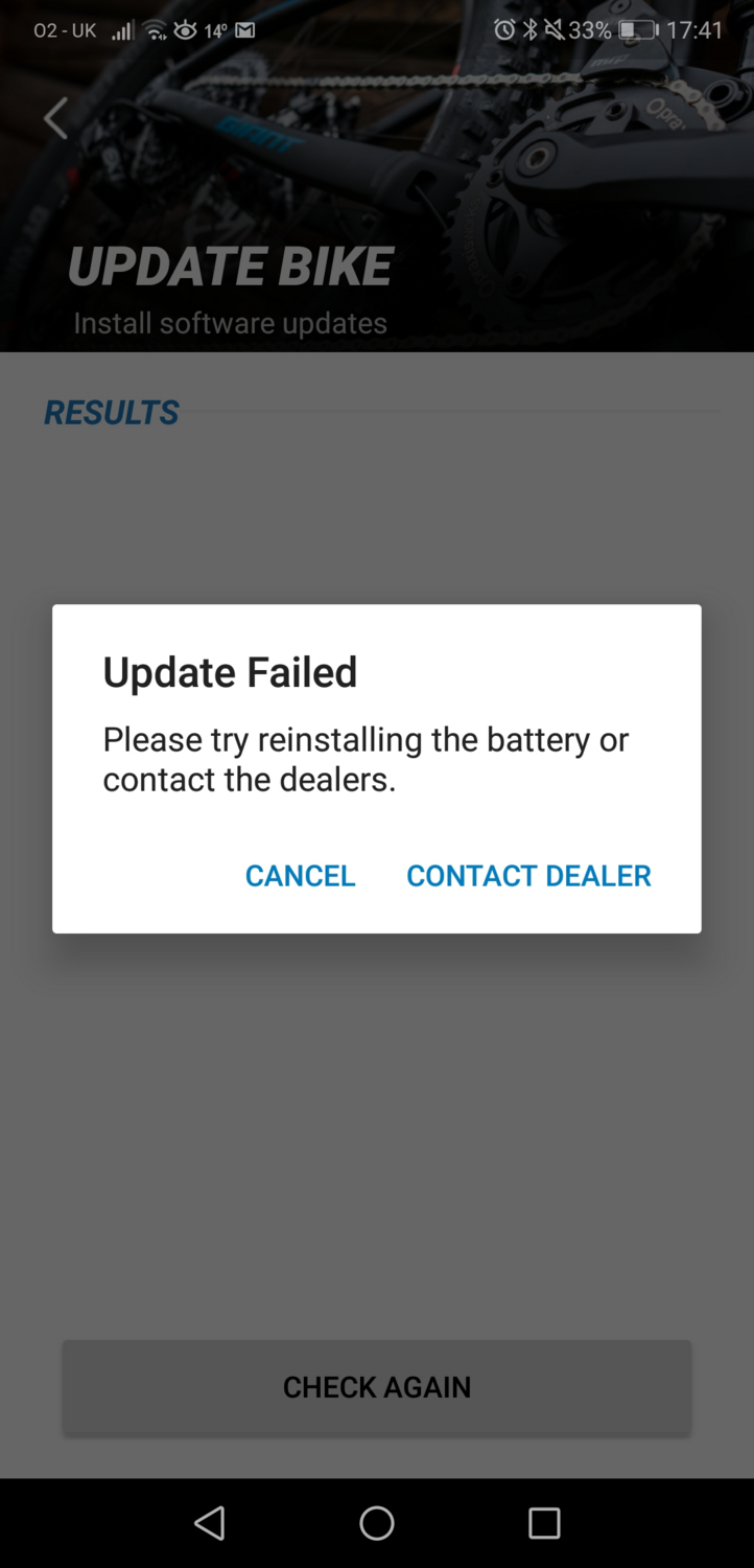

Stance e+2 2019, i have deleted and reinstalled app 3 times. Cannot complete the firmware update due to this message, any suggestions
You haven't said what device you trying to connect with but others who have experienced connections issues such as you have described with the iOS version (on an iPone or iPad) have found that connecting with an android based device with the Giant RideControl e-bike App installed and carrying out an update has solved the problem and then allows you to connect your iOS based device. If you don't have an android based device you may need to borrow one.
Currently using Android version 8.1 and have the lastest version of RideControl.
I thought that from your screenshot (I'm a iOS user and it didn't look like my interface), my only other suggestion is to try the reverse, borrow an iOS device and attempt the connect with that. You could also try removing the battery, sometimes a depower/repower helps. This is very buggy and poorly documented software, the dealers don't seem to know much about it and the only other option is to take it to a authorised Giant dealer who has a Giant Service tool and see if they can connect.
