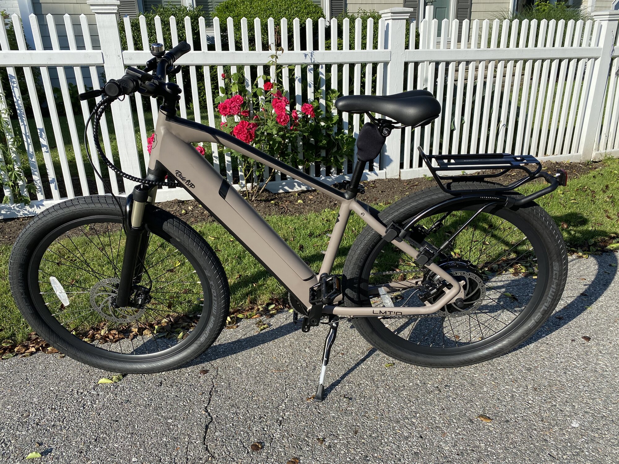

Day two:
Yesterday I test-drove my new LMT'D as stock and then added a few accessories. My ability to compare this bike to other ebikes is limited, as it is my first ebike. I've never tried a cadence sensor bike, so a torque sensor is my "normal".
I finished my last review/post saying that the LMT'D was nicer than I expected - that continues day 2.
Bike:
- It's heavy. I carried it up/down the 6 steps to my house as I test drove it and carried it back inside to make adjustments. 51 lbs is not trivial - even as a very light e-bike. It's not unreasonable, but it's enough weight to make you pay close attention to your footing.
- It's a chameleon. It is gray? tan? beige? Depends on who you ask and the sunlight. Looked gray inside. Looks beige to me sometimes.
- I really like the included components. The pedals, the hand grips, the seat, the tires, the gear shifters, the brakes. All work well and I didn't feel like I urgently needed to upgrade anything. This may be my first ebike, but it's not my first bike. Not by a long shot.
- It includes a few things not pictured or mentioned on the website: Wheel reflectors, rear and front reflectors, a water bottle holder.
- The display is bright, small and packed with information. Color is awesome. It's a generic Luna 500c unit. I like that it is small/discreet. It has haptic feedback (vibrates). My only negative on the display is that it lacks the Ride1Up opening logo and logo at the bottom of the screen - like the early 700 units. Kinda weak. Instead it says "Hello" on startup and "intelligent" at the bottom of the screen. Missed brand reinforcement opportunity.
- Hydraulic brakes. Are really nice! This is my second disc brake-based bike. First hydraulic. Damn. There is a HUGE difference.
- Air suspension. Is even nicer!! Again, a first for me. The air suspension needs to be dialed in and adjusted to the individual. DON'T LEAVE IT AS SET FROM THE FACTORY. You and I don't weigh the same. Shocks are not "one size fits all" with regard to the factory shipped settings. Adjust the amount of air (left side) and adjust the damper (right side). Good article here. I ended up releasing some of the air to get some sag under my weight and adjusted the damper to get the right rebound. You paid for air shocks. Make them work for you.
- Torque sensing. I really like how the motor just kicks in seamlessly/smoothly/evenly on hills. WOW! BUT.... on flats - torque sensing feels weird. It comes on/off a lot and if the PAS is too high, the motor is constantly lurching/stabbing the bike forward and then shutting off. A big part of riding a torque sensor bike seems to be - adjusting your pedaling style to have more constant pedal pressure (torque) - vs the strong downward force and ease/transition at the top/bottom of the pedal circle, which seam to cause the LMT'D's motor to pulse on/off. If I turn down PAS, the on/off assist is much less noticeable but I can still hear the engine pulsing on/off. I got used to this and found a PAS setting that doesn't leave me with the sensation of a motor on/off pull sensation and, I kept my pedal pressure more even. I'm still learning - interested in other's experiences. I can get to 28 MPH pretty easily - this bike is fast.
- Throttle. Press and go. Super torquey. Easy.
- Motor. Actually a lot quieter than I expected and much more quiet than the LMT'D review videos I've seen. Weird how the motor noise seems to be amplified in videos. It feels to me to be very torquey - no problem accelerating the bike into motion - via PAS or throttle.
- Battery. I like how well it integrates into the frame. After a lot of riding, I'm at 70% charge. I've bounced over bad pot holes and curbs. Battery stays put. Same color and finish as the down tube. Nice touch.
- Derailleur/shifting. Worked nicely and was well indexed out of the box. With the motor assisting I just leave the bike in 8th speed - Weird or Normal or Lazy? The motor and its serious torque make starting/rolling from 8th gear a non issue.
- Kickstand. I read a lot of reviews complaining about how the kickstand was mounted such that the pedals got locked up on it. That's how every bike I owned as a kid worked. This is really a complaint? For f*ck's sake.
