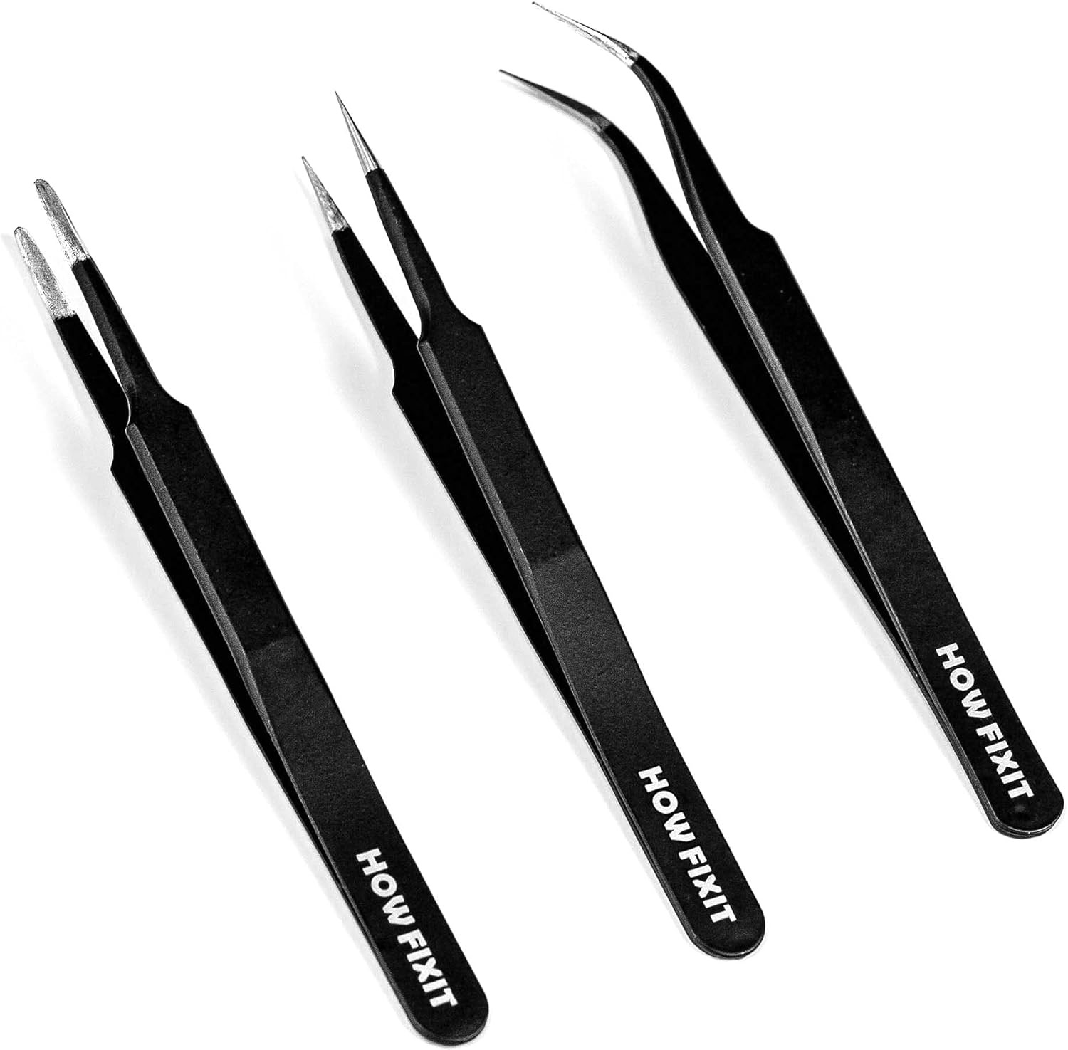

I just had to replace the battery on the original TCU as well for my Vado SL. I read about all the trouble people had getting the battery out, including unplugging the TCU completely and tapping it to get the battery out. I had a non-magnetic metal angled tweezer with very sharp tips like the one on the right in the photo. I was able to grab the battery with no problem, slide the new one in and push on it gently with the tweezer until it snaps in. By the way, the video online for the Creo battery replacement says a T9 Torx screwdriver, but the Vado SL needs a T-10 Torx screwdriver.
