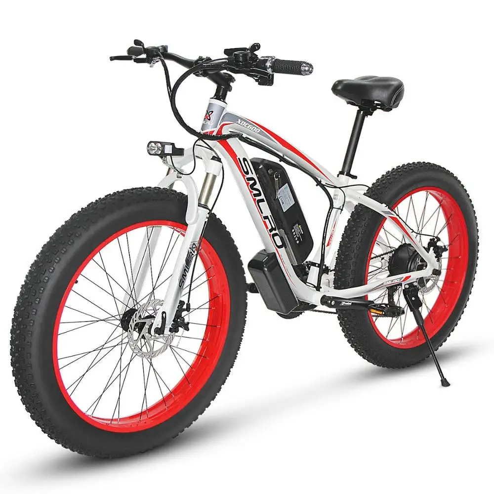

Found this on on Banggood, looks solid.
https://www.banggood.com/SMLRO-XDC60...r_warehouse=CN

Regarding the bike in your link, the picture is of a rear hub powered bike. They call it a 1000w Bafang at the top (I've never seen a 1000w Bafang hub drive), and a 500/800w in the specs. so there is clearly a mistake somewhere. That, and the bike is a 21 speed - which uses a front derailleur. That would need to be removed on my bike.
