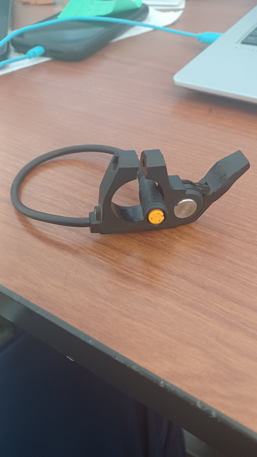

Does anyone know of alternative throttle for the milano plus? Ive looked everywhere but nothing. The throttle for my milano plus broke and they have been out of parts for months. Magnum ebikes uses similar components as NCM but also there are none. Its totally crazy this simple part would be out of stock for MONTHS.

If it's the spring that is broken, here's a video on how to do a repair.
If you want a new one you can order at Amegoev.com or less expensive on AliExpress or Amazon. Just be sure to get one with the right connector or be prepared to change it.
Actually pretty much any 3 connector throttle (twist, half-twist, thumb) should work as long as you get the connections right.
