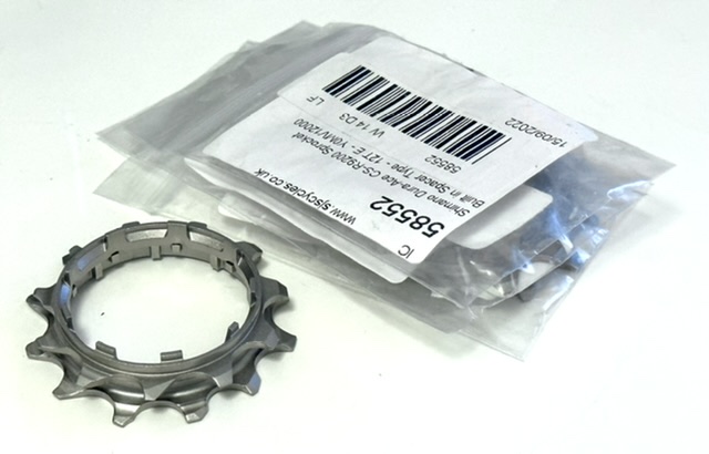

Do you have a link for these smaller cogs? In the past I've searched online for them, with very little success.
which ones do you need? I had to order a bunch from England - got three of each of my smallest two to spread the shipping costs out. shimano may have some sort of stupid policy about which ones can be sold in which region.
there are quite a few types. I got these 11t and 12t (For dura ace 12 speed) from SJScycles. fast shipping and good service.
