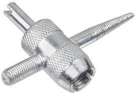

I've never had a problem with Slime clogging valves. I would think that if there's any Slime in there it would be pushed into the tube very easily by just about the smallest amount of air pumped through. Worst case, as Reed said, unscrew the valve core, rinse it (Slime is water soluble), run a qtip or something through the valve stem. Everybody's got one of these, don't they?
TT
Thanks for the reporting the solution! The feedback is really valuable.
TT
Got three or four of them and half dozen slime bottle caps that are themselves valve tools .... for when I can't find the real pictured tool.;)
