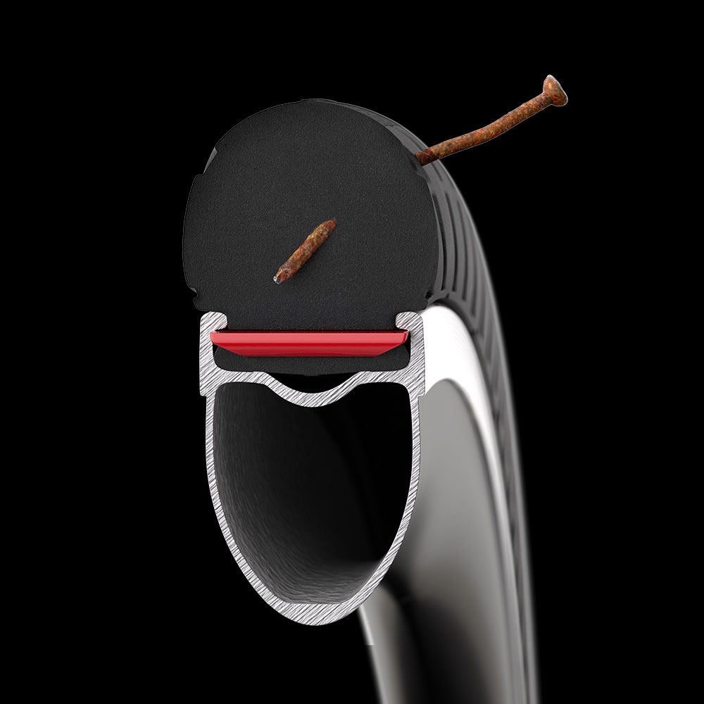

Hey folks. I have been thinking about the best strategy for puncture avoidance and field flat repair. I have a Super Delite on order (Enviolo w/ GX option). How daunting is rear wheel removal in the field on these Gates carbon belt driven R&Ms? I am contemplating Tannus tire liners to reduce puncture risk as much as possible. Would appreciate our thoughts on this. Thanks!

I'm all for it and very interested in it. BUT... I have also heard that these Tannus inserts wear out and must be replaced regularly. That means going through the tire change routine to swap in a new Tannus insert, perhaps more often than a flat would happen? At least, the replacement could be performed under intentional conditions, not randomly out in the field where a flat would occur. So perhaps you are exchanging more work for the seldom inconvenience of fixing a flat. Does anyone know how often these need to be replaced?
They are guaranteed for 7 years. I should work for the company.
Ha! But what I saw was something like, they should be replaced every so many miles, like 2,000 miles? Maybe I am wrong about that.
They warranty them for 5,000 miles. I seem to recall reading that they last over 10,000 before I bought mine. They claim that if you do get a puncture, you can run flat at low speeds without damaging your rim (avoiding rugged terrain). I'm pleased with the ride quality with the Tannus installed on my bike - but less than 500 miles so cannot attest to longevity.

David I wonder if we can hear from anyone who has tried these?

David I wonder if we can hear from anyone who has tried these? View attachment 58681
I have not used these, but I have read some ppl complain that they can feel mushy, can slip and if left to sit, they can result in "flat" spots, that you can feel when you ride. Plus they only come in road tread and for me I like to go off road at times.
yes I doubt they are a better all round solution than the Armours and it looks like nobody that has used them is responding so far but if you absolutely must not get a flat.....
These will get you home, where you can then use a bike stand
