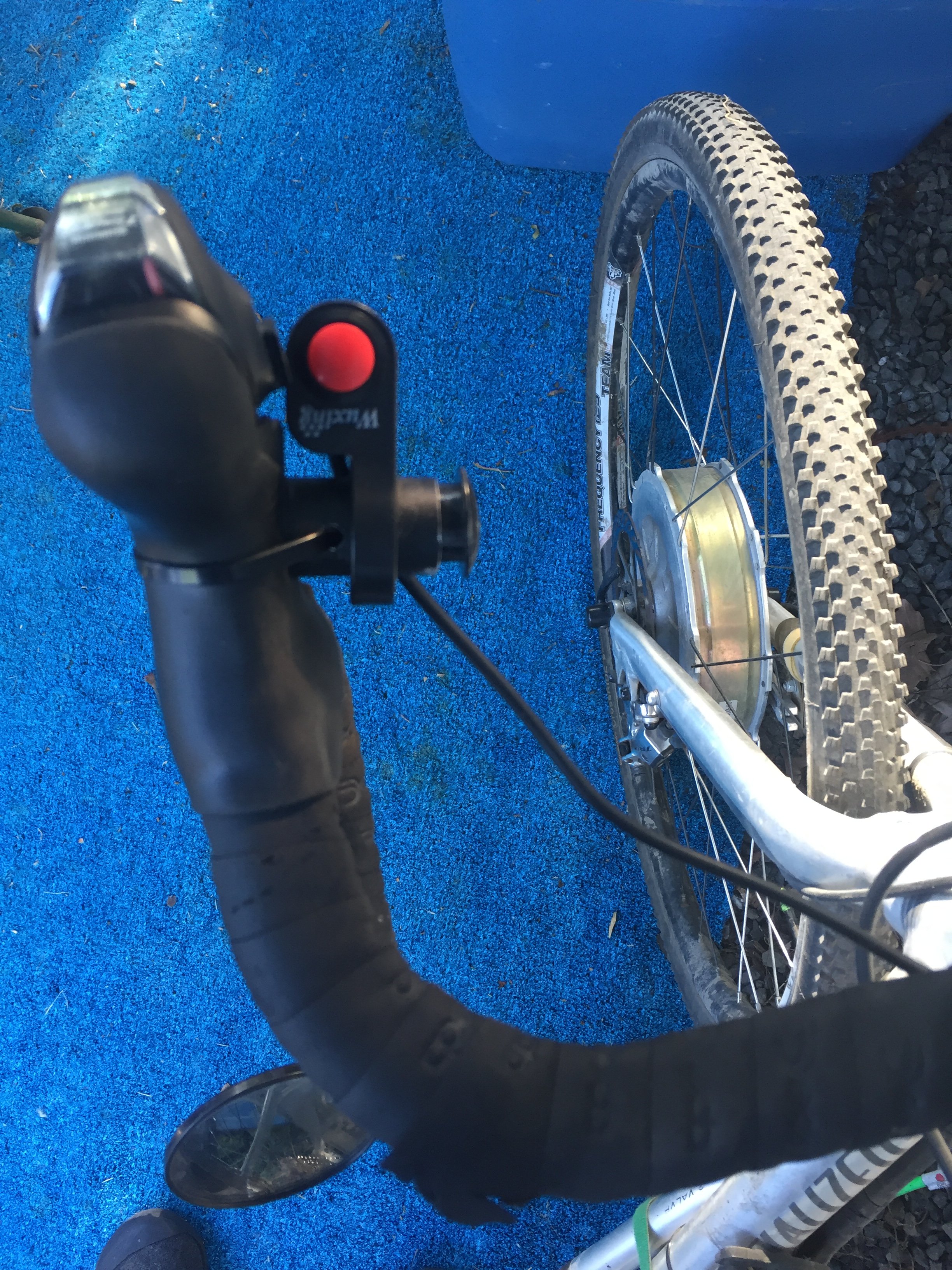

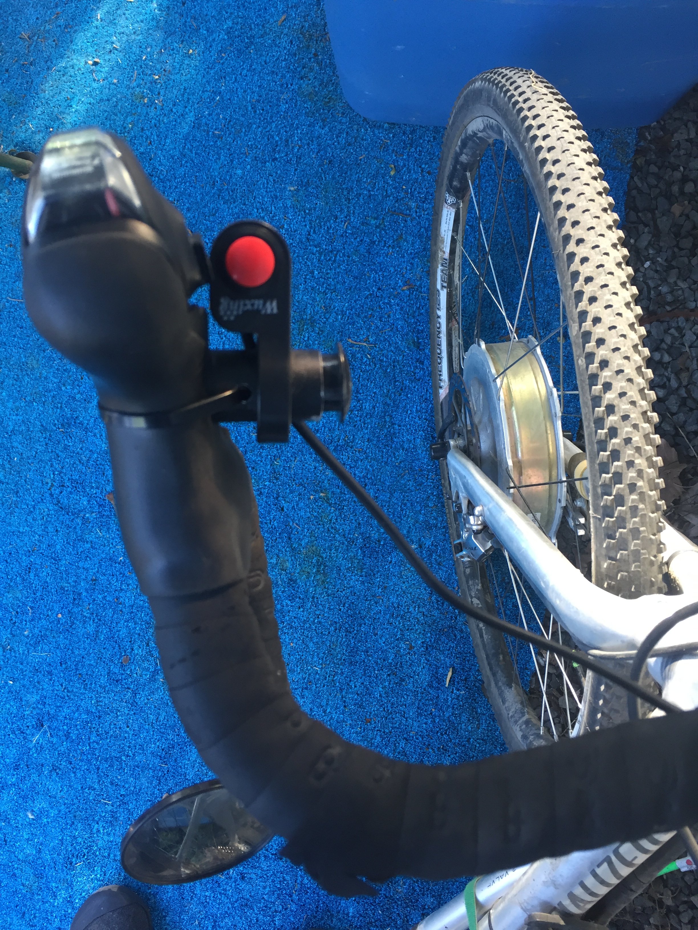

I have my regen set up so that it is separate from my brakes, the red button in the pic which is a momentary switch,
and use it before I use my front brake to scrub some speed. Used mostly on downhills and approaching stops. But when I need more I can easily grab my brake lever even while pushing the button.
You don't get a very big ah return using regen on a bike per battery cycle but every little bit helps. The biggest benefit is saving on brake pad wear.
