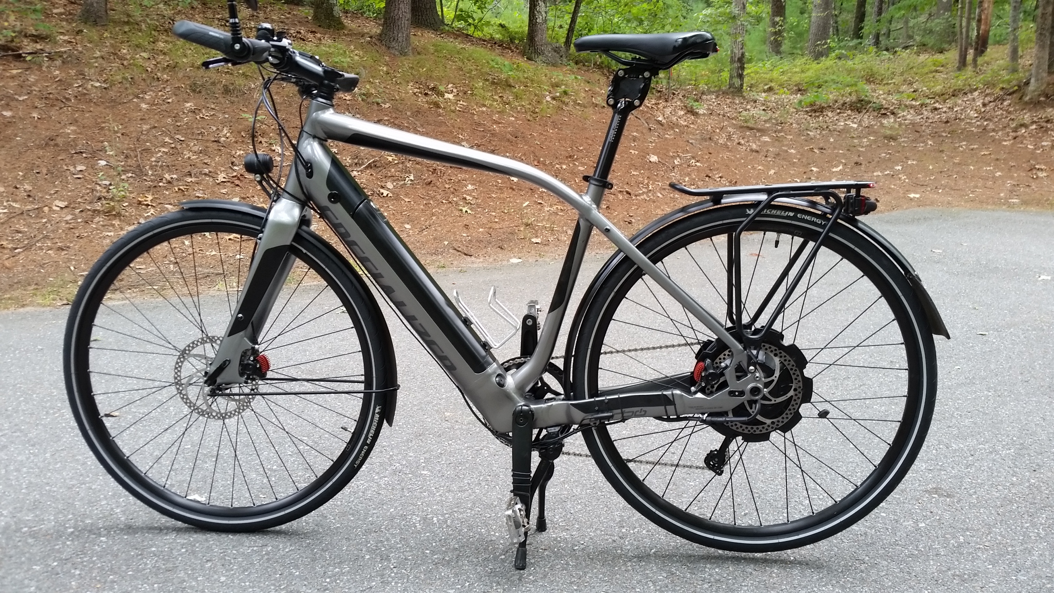

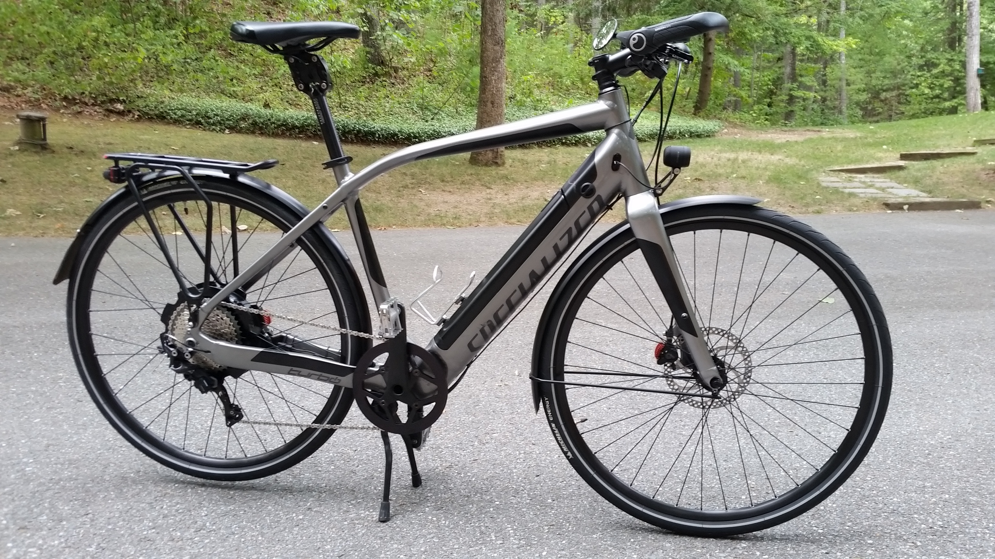

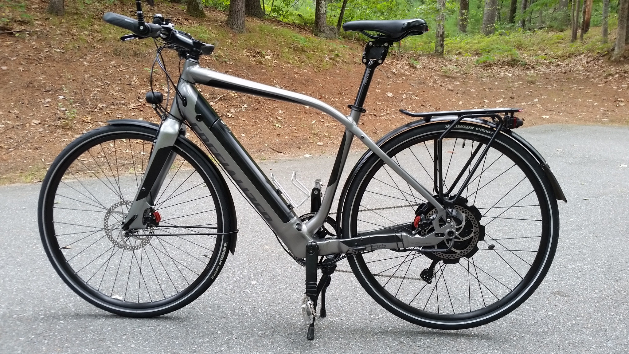

I now have about 1000 miles on my "2015/16" base Turbo purchased in November of last year. As I am taking more rides over longer distances of 30-45 miles, I am thinking of re-gearing my Turbo again. When I bought the bike, I changed from the original SRAM 10 speed 11-32 cassette and 48T chainring to an 11-36 cassette and 44T chainring, While an improvement, I find that my current setup is "almost but not quite perfect".
1. When cruising on the flats I sometimes find myself caught between 9th and 10th gear, which is tiring. My base Turbo (and the 2015 Turbo X) has a maximum assisted speed of 42 kph (26.1 mph). If I want to hold that speed using full Turbo or ECO70, it puts me at a cadence of 79-80 rpm in 10th (where I am "pushing") or around 95 rpm in 9th (where I am spinning a bit too fast). Neither is quite optimal. My best cadence is between 85 and 90 rpm. I could change to the 48T chain ring and use 9th gear, but then I lose the benefit of my lower 44 x 36T 1st gear. A 12 tooth (100 gear inch) 10th gear on my cassette would be optimal, but then I lose the "over 30 mph" downhill 10th gear that the 11 tooth (110 gear inch) gives me.
2. On longer rides at ECO40 when I am trying to optimize for distance, I find that the lowest gear of 44 x 36 (33.5 gear inches) isn't always low enough, necessitating hitting the "Turbo" button to help me up the hill. If I could get a lower 1st gear that would be great.

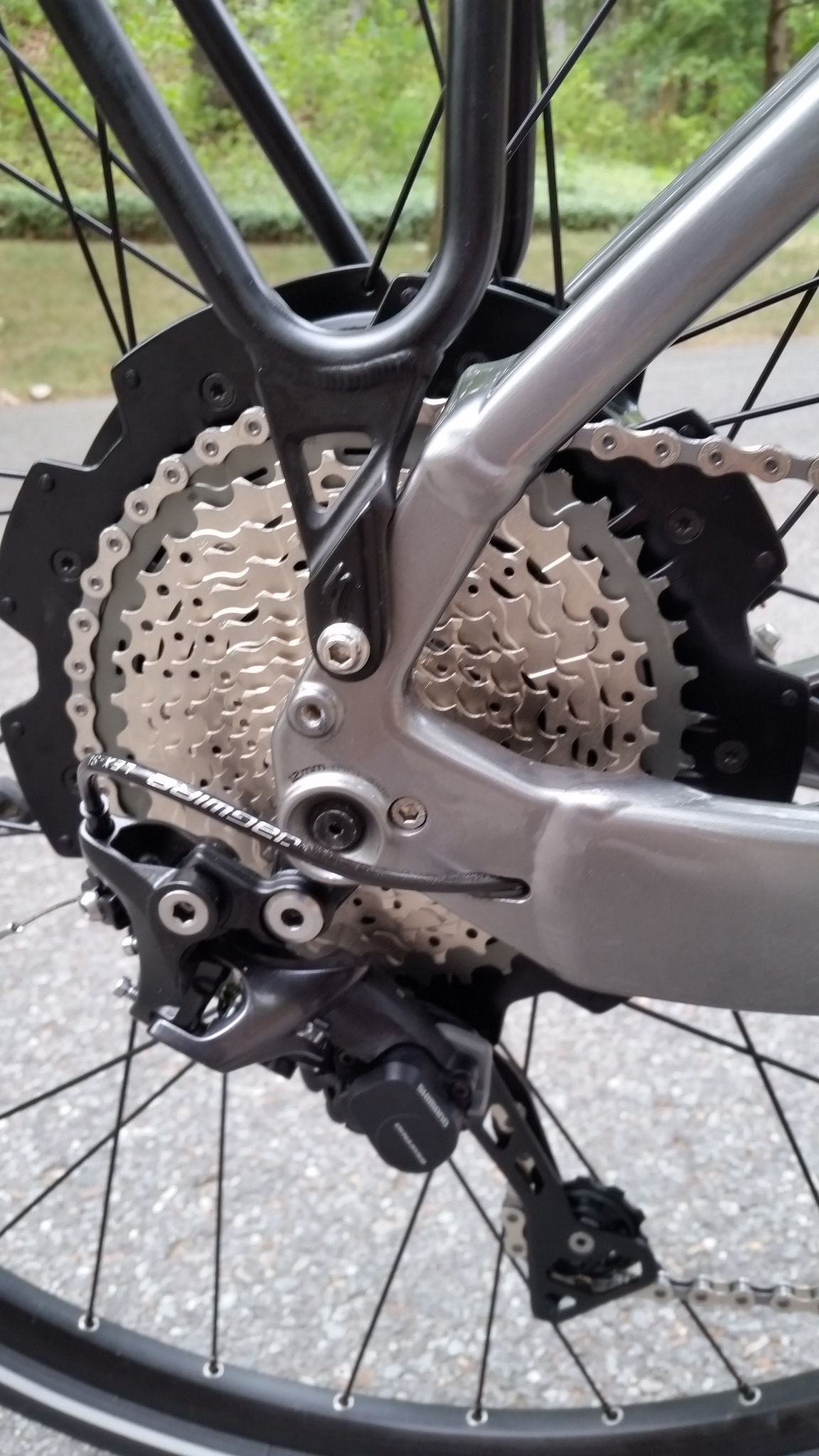

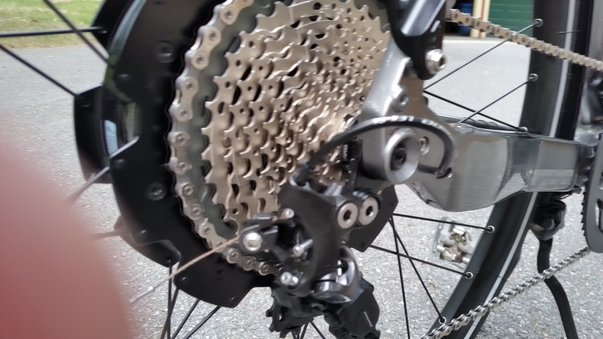

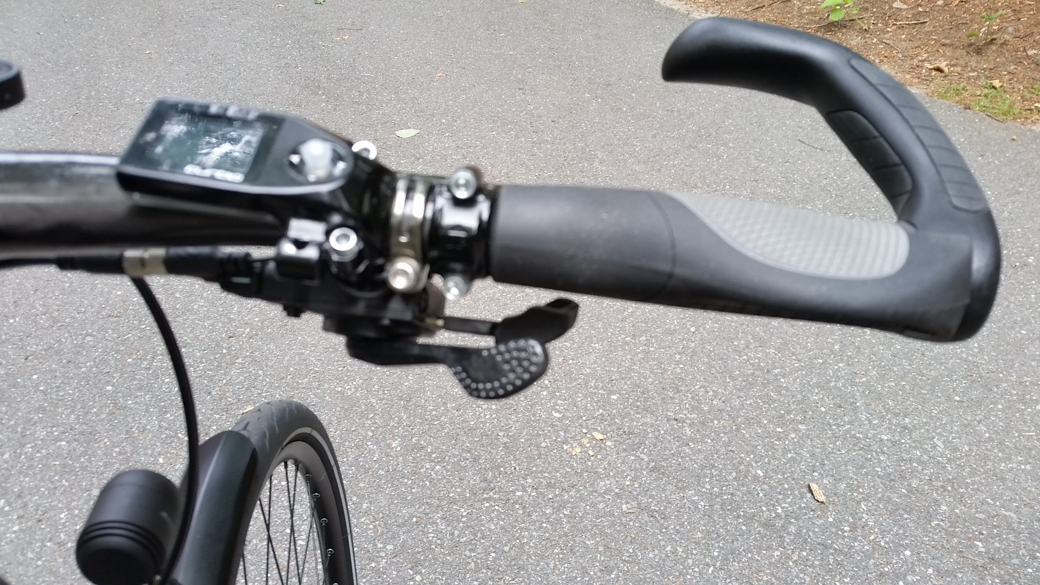

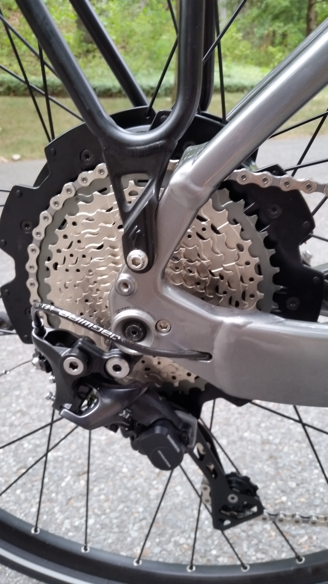

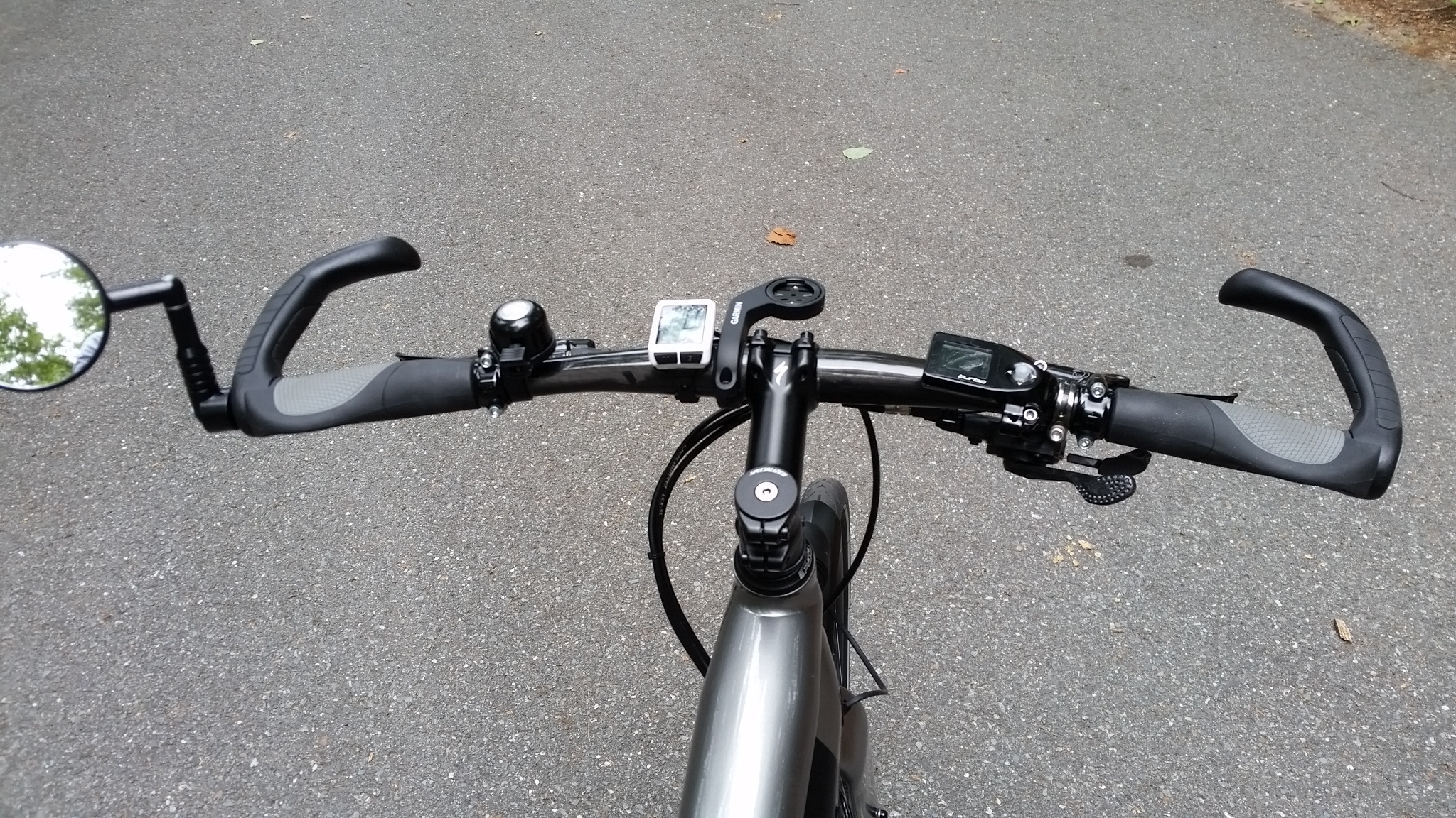

Since I can't find an 11-12-13-...-36 in a 10 speed cassette, I am looking into the Shimano Deore XT system used on the 2016 Turbo S. The 1 x 11 speed 11-42T Shimano cassette will fit the standard Turbo wheel. The SRAM derailleur and shifter can easily be swapped for the Shimanop Deore XT system. If I swap back to the 48T stock chainring, I get a 101 gear inch 10th gear which provides 26.1 mph at a cadence of 87 RPM, ideal for me. I would still have a taller 119" 11th gear and a lower 31.3" first gear. Total cost is around $210 to upgrade the chain, derailleur, cassette, and shifter.
The gearing changes can be seen in using the web-=based calculator below:
