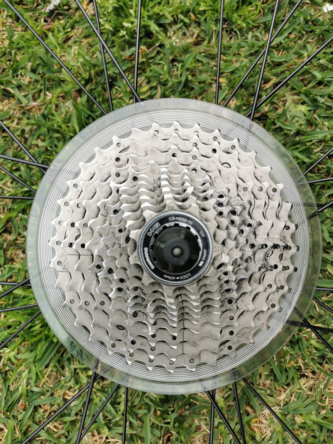

I finally found stock of the KMC e10 that fits my bike. During the swap took the opportunity to give the drivetrain a thorough going over. Problem is I don't really know what I'm looking for in terms of wear! Here's a photo. Any red flags there? It's done about 1700 km with one chain. I try and be gentle on it.
If previous chain was not skipping and below 0.75 wear your cassette is probably fine, 1700km is not much. It is hard to accurately measure cassette wear. Are you using gears 3to6 more than others?
