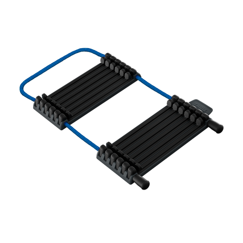

I had an Easyfold XT2 for a couple of years and found that even though the clamps have a rubber covering over time the rubber can mar the paint finish.
I originally bought a couple of Thule carbon frame protectors because I occasionally brought my carbon road bike instead of my ebike. I liked the protectors so much I ended up using one with my aluminum framed ebike too.
