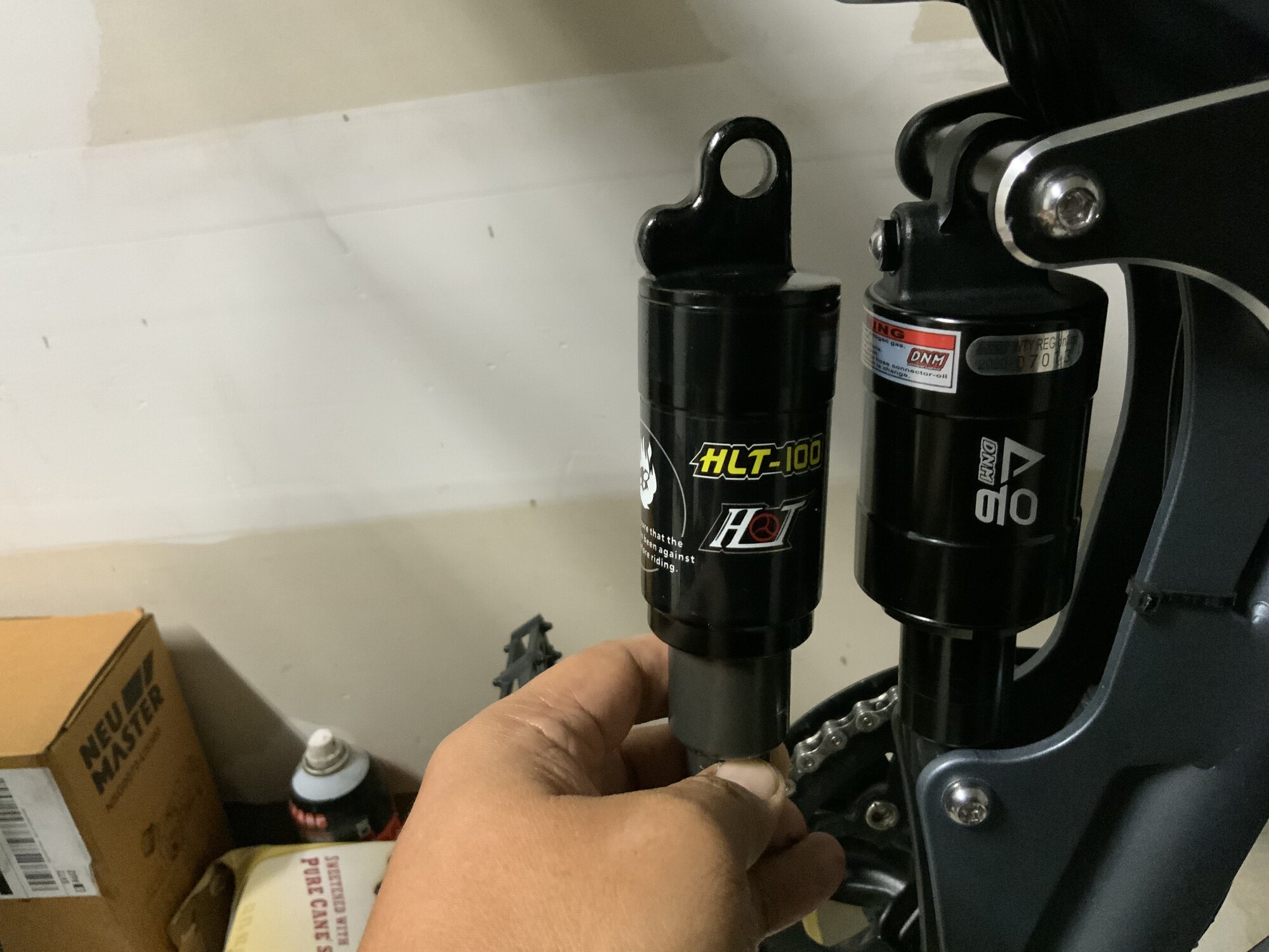

The rear shock which is an HLT-100 rated at 750lbs is starting to sag on my bike. I am 218 lbs. and ride the bike on pavement 90% all the time. I initially attempted to increase the size and replace it with a DNM-AOY-38RC gas shock, which is a lockable and adjustable. FYI, the shock we have is 150 mm. This is one is 165mm. The replacement shock will fit, but the problem is the wiring is touching the top of the shock and it might break the cables during riding. So, i found a 150 mm adjustable gas shock DNM-AO6. You will need to reuse the upper and lower aluminum bushings from the HLT-100.
You can see that the replacement shock has a larger air chamber and the pressure can be adjusted. The factory set it to 150PSI which is a tad too hard for me. I dropped it to 100PSI. View attachment 69222

with the 2020 wallke x3 version — due to wiring constraints on the rear shock .. we are limited to 150mm. I’ve tried multiple times to fit a a 165mm DNM or Rockshox.. nope. Had to send them back. The 2021 version has less wiring and you can fit a 165mm. Rockshox, fox or DNM would be your choices
The HLT-100 rear shock is not an air shock. Somebody posted up an opened up pic in a review, but it's a coil spring inside of an 'air shock' looking housing. There was a ton of sag with that junky shock, and has always been like that for me since day one (back in May).
I also swapped mine out for a KS A5-RR1 air shock a couple of months ago and I'm using 190psi/170psi on the high/low sides of it. Perfect for my weight and now the bike rides so much better and takes drops now like a champ.
