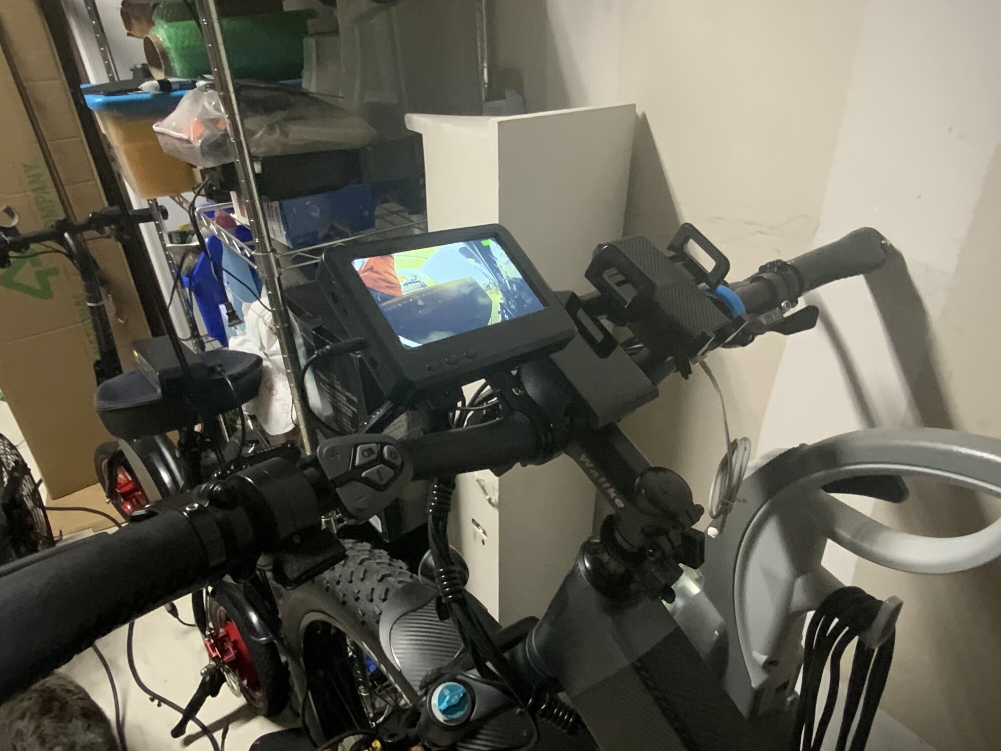

They look massive in comparison to the wallke bars , I think for now the base bars are working fine for me with an extender bar so I can add the extras
Holy smokes, that's a lot of stuff on the bar.
The main reason I changed my Wallke bar out is because I'm used to riding with a 780-800mm bar, so the 680-ish mm bar that Wallke comes with is way too small and didn't feel that stable on some of the trails I normally ride. Now the ride is much better feeling on my shoulders and more stable feeling on the trails. I purposely didn't spend want too much on my Wallke and bought a Wake Comp bar for $24 shipped on Amazon.

Upgraded the oem handlebars which is 26.25 inches.. around 667mm...
to 720mm ... much more stable steering and less crowding of the all the accessories I have installed

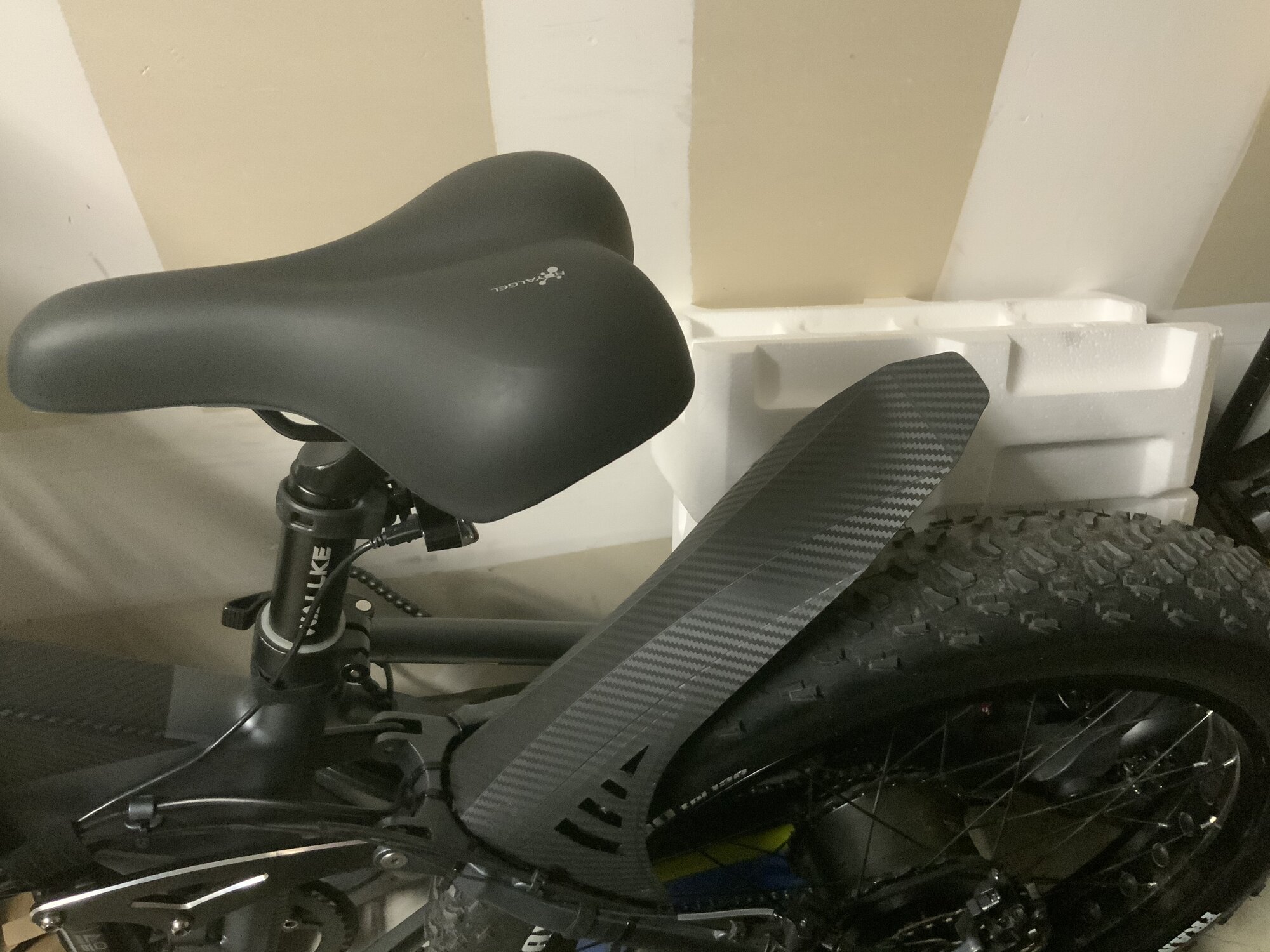

Since getting the bike on Sept. 24, I have been doing mods to the bike. My list so far:
1. Added front and rear fenders ( Ecotric Fat bike fenders SH-DNB002-B )
2. Replaced saddle to Selle Royal Commuter
3. Replaced pedals (K-PEDC Aluminum)
4. Installed Lizard Skins Chainstay protector ( Medium )
5. Installed Chain guide tensioner ( this prevents the chain from slipping off when riding off-road )
6. Installed a 1200 Lumens LED rechargeable bike light on the steering post.
7. Added a handlebar extender and moved the iPhone charger to it.
8. Upgraded the front rotors to 203mm ( Shimano SMRT66 6-bolt rotor ) - you will need a mounting bracket ( PM to PM - post mount to post mount brake adapter ) - improved my braking and no more scraping noise from the front on Tektro rotors when hard braking
9. Upgraded the rear rotors to 180
10. Covered the Wallke logos with some carbon fiber vinyl
11. Replaced the Tourney derailleur with an Altus derailleur
12. Changed the chain from KMC Z-series to KMC X-series 8-speed chain - you will need to order 2 chains. The current chain has 128 links. 8-speed chains are 116. Break off 12 from one donor chain and add to the replacement.
13. Added Missing Link chain connector from KMC
14 Added rear view mirrors and installed on left shock absorber
15. Upgraded the rear warning light ( Don Pergrino B2-110 Lumens bike light )
16. Added orange slime on front and rear tires ( i ran over the infamous goat head seed and punctured the front tire )
17. Changed rear shock from HLT-100 to DNM-AO6 adjustable gas shock

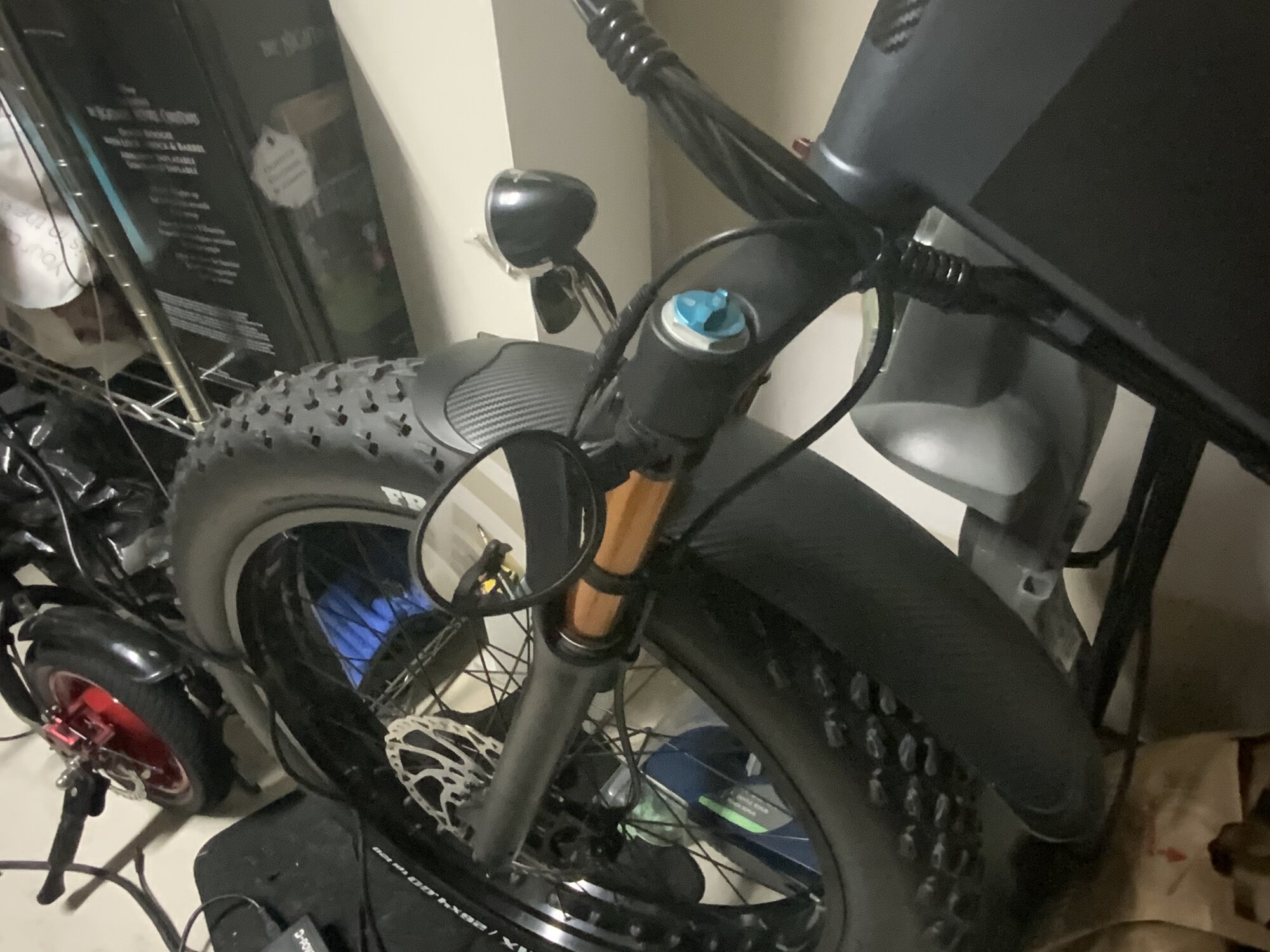

Thanx! How well does the shock mounted mirror work? Do you know the brand/model #? Are you happy with your other mods, e.g., do you like the parts you chose, such as the seat?
I have since added a rear camera system and use my mirror as a backup. Some cheap model mirror from Amazon The seat/saddle is called Selle Royal.. the same brand as the stock.. but this is wider and has better cushioning than stock. I also broke the rear fender and replaced it with a plastic mud guard attached to the suspension with zip ties. I broke the rear fender when I lowered it and I was downhill going 28... and made a left turn at the bottom of the hill, I let the suspension ride out the corner and the rear fender got caught on the rear wheel and was ripped apart.
I have since added a rear camera system and use my mirror as a backup. Some cheap model mirror from Amazon The seat/saddle is called Selle Royal.. the same brand as the stock.. but this is wider and has better cushioning than stock. I also broke the rear fender and replaced it with a plastic mud guard attached to the suspension with zip ties. I broke the rear fender when I lowered it and I was downhill going 28... and made a left turn at the bottom of the hill, I let the suspension ride out the corner and the rear fender got caught on the rear wheel and was ripped apart.View attachment 74333View attachment 74334View attachment 74335
Exxellent! Where did you get those fenders?
