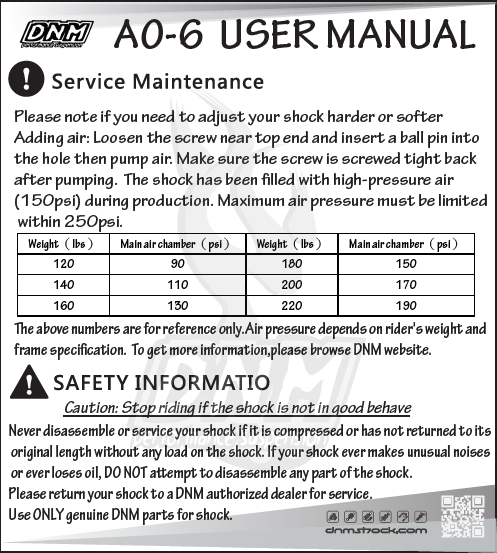

There is no definitive value as different frames have different leverages on the shock. You could start with the values given by DNM in their user manual..
Again these are guides (190psi in the case of a 220lbs rider which isn't a million miles away from the X-Fusion suggestion of 80% rider weight).
