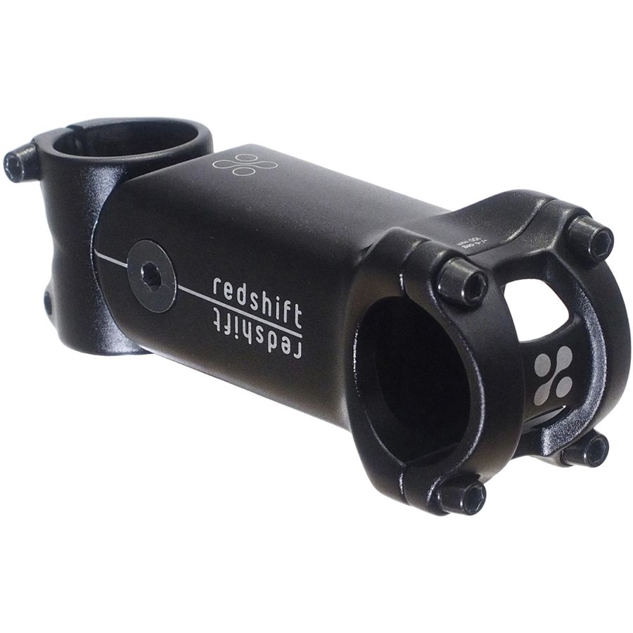

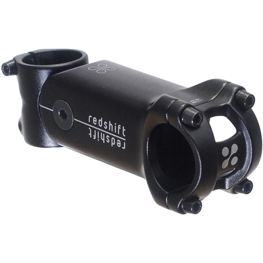

Personally, I have the Redshift Shockstop suspension stem on my steel-frame and fork, non-electric bike. It was one of the best adds I've made. Maybe this is due in part to the fact that it put the bars in perfect position for my stature and preferred ride position but I also think the suspension aspect has made a noticeable improvement to the ride quality. I have the bike outfitted with very stiff 35mm tires (Bontrager Hard Case Ultimates) and I ride around 80psi and to say they are firm is an understatement. The stem was a huge improvement to the ride quality and allows me to do more miles more comfortably.

The pictures are the Redshift stem on my Spot Champa and the Baramind bar and Bontrager Isozone grips on the Allant 9.9s.

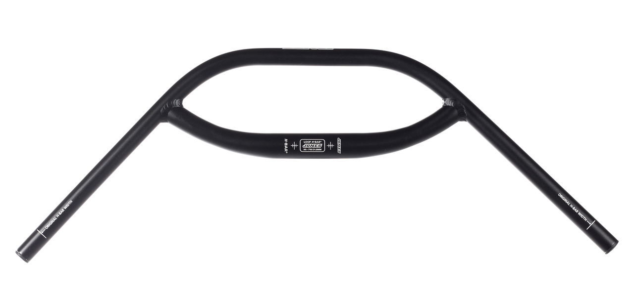

I've been experimenting with handlebars, grips and stems for many years on my conventional MTB's. Lately, I've applied what I've learned to my ebikes. With age, I find I need a more upright riding position for maximum comfort. Through trial and error, I found these products provide the best solution for my particular riding style.

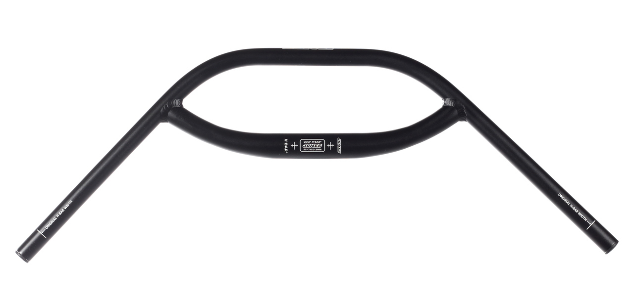

Jones H handlebars:
44868
The angle and height of the bars, in combination with the Bontrager grips below, provide the best riding position and maximize wrist comfort.

The Kinekt suspension stem appears to be similar to the Redshift Shockstop stem released in 2016.
44884
The Redshift gets favorable reviews but has a different design. It will be interesting to see the two reviewed together.
A quick price comparison shows the Redshift stem available for $149 and the Kinekt stem on Kickstarter at $139.
Jones H handlebars:
I agree that the Jones H-Bars are da bomb! I use the Jones H-Bar with 2.5-inch rise. Together with a couple of stem spacers it allows me to ride comfortably upright. The 45-degree sweep places your wrists in a more natural and comfortable position than a flat bar, and the Jones H-Bar allows for many other hand positions as well, a blessing on long rides. Another benefit is that there is plenty of room for accessories such as a bell, lights, reflectors, smartphone holder, GoPro camera and a handlebar bag.
