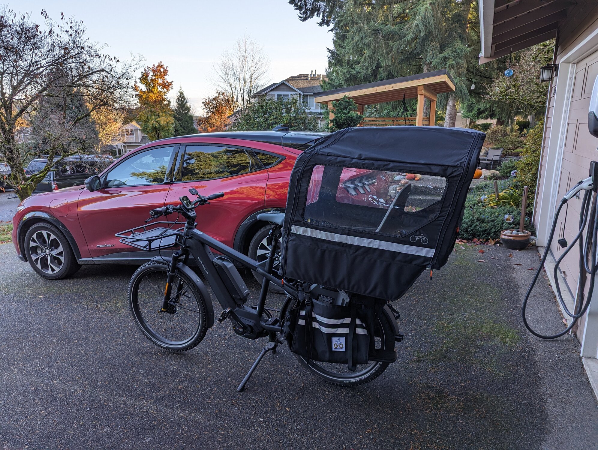

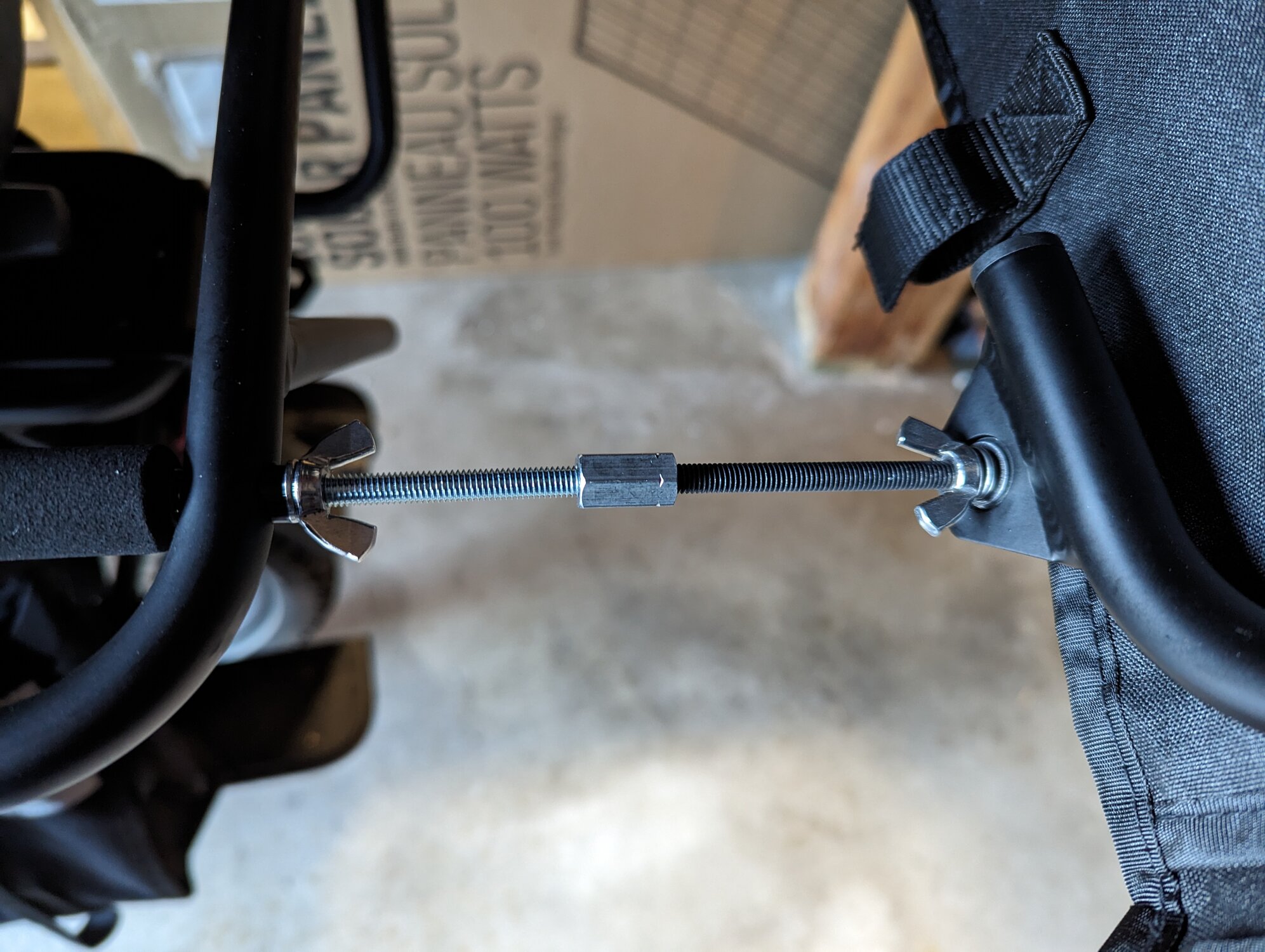

I put a Conestoga on my Multicharger this week. I had found a forum post from an owner in Germany who said that they just needed to swap out some bolts. They're all M6, so finding what I needed was easy. I couldn't find 20cm long bolts, so I used a couple rods and couplers. We did a lengthy ride the other day and it worked great! It's nice to be able to raise the sides when kiddo wants to look around and drop them if there's weather or to make napping easier.
I considered the Storm Shield but it looked a little less roomy and I'd like to preserve the option of putting on two seats if our family grows.

Incredible!
I ended up getting the Storm Box and Storm Shield. They do fit fine, but yeah there is only limited room for the reclining rear chair. I think it may be able to fit two chairs but not 100% sure.
