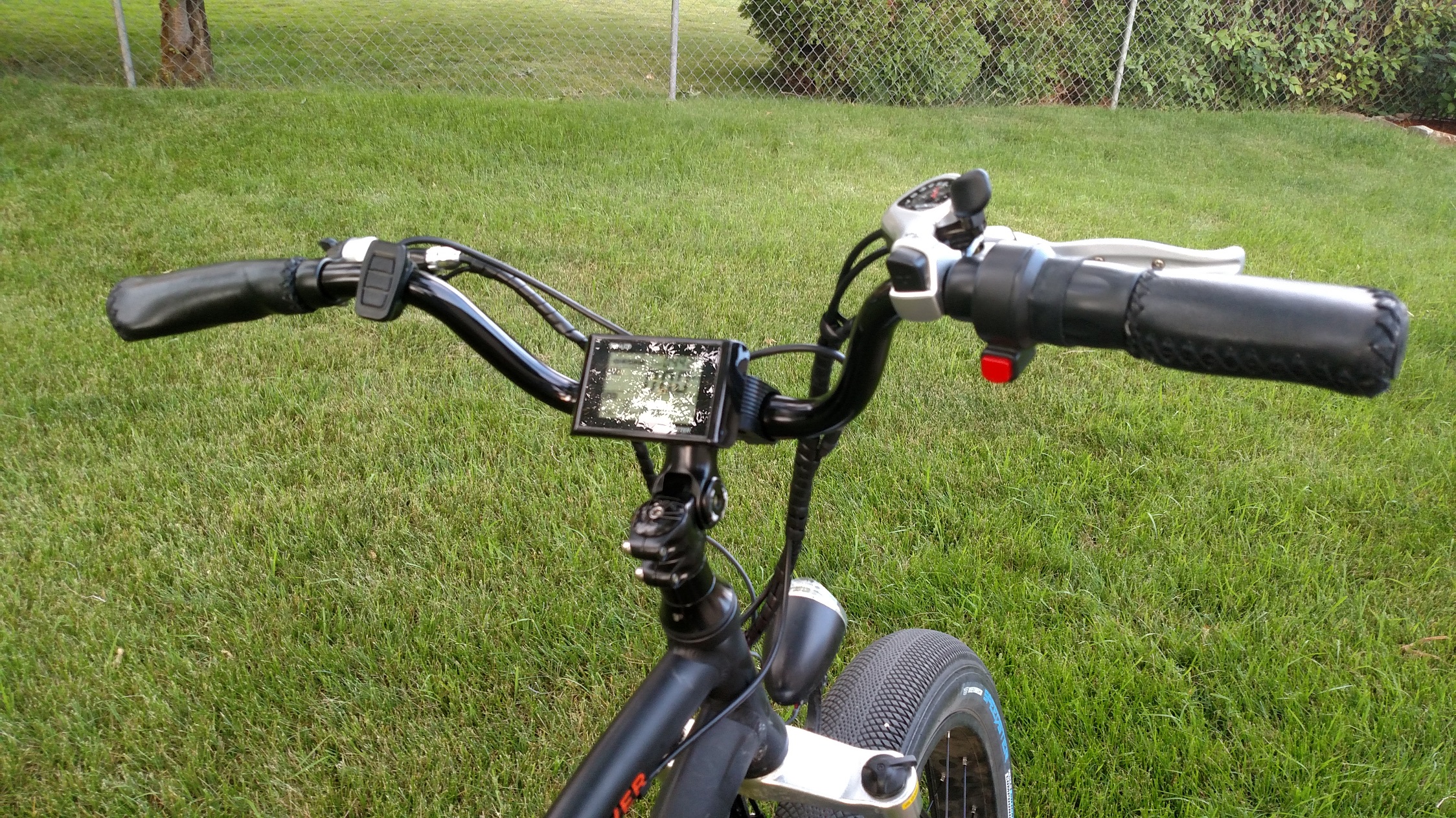

I decided I wanted to sit completely upright and put on both an adjustable handlebar stem and a 5 inch rise, 27 .75 length Sunlight handlebar on. It was an interesting project and took me about 2 hours. The hardest part was getting the handlebar grips on and off. At one point I thought about just cutting them off but the one on the right with the throttle is a shorter one and would be both more expensive and harder to get a replacement. I had to unwrap all the spiral wrap and reroute 1 wire. The only item that wouldn't reach properly is the 3 button controller. I now have to take my left hand off the grip to push on it. A little hassle, but it's not like I'm constantly making changes to the LCD display. The handlebars are wider and I do like the fact that I get extra leverage on the heavy front wheel. View attachment 6697
