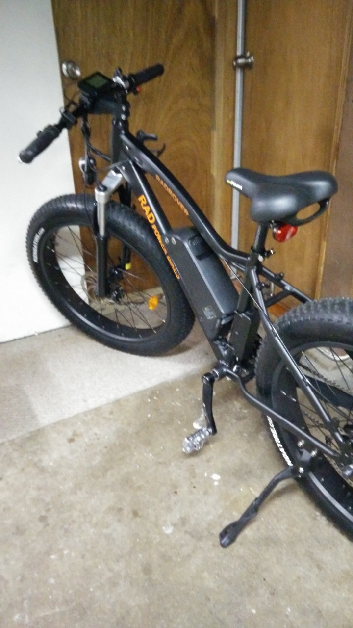

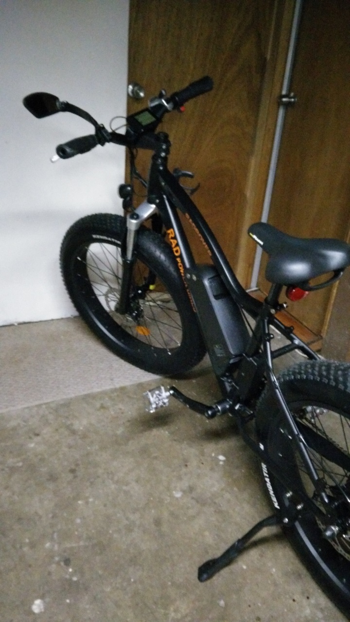

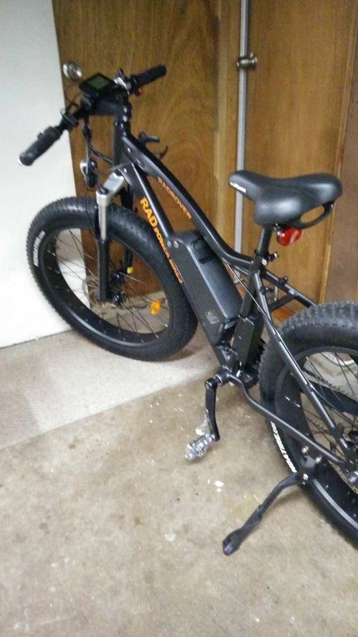

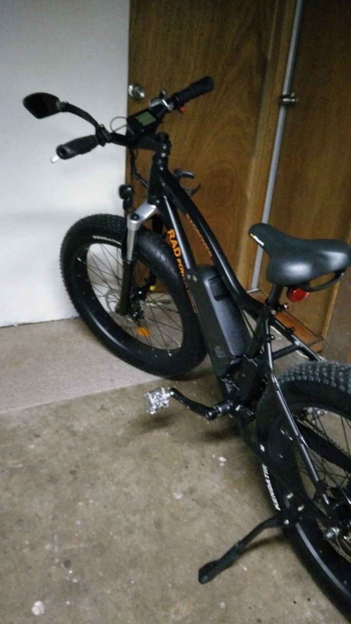

I want my handlebars a lot lower. I'm short 5' 6" so the stock position of the bar is too high. The stock riding position feels too much like a beach cruiser than I like. So far, I have reversed the angle of the handlebar stem and placed the 1/2 inch spacer above the stem instead of below. I think this lowers the hand position a bit over an inch.
I have a flat handlebar coming to replace the riser bar we currently have. This one: link. That should take my hand position another 2 to 3 inches lower.
An update for my flat handlebar mention in last post. Have it installed. Took about an hour, together with flipping the handlebar stem total. Based on my own maybe not that accurate measurement, with bike leaning against the wall which may vary a little depending on amount of lean, it took a little over 4 inches from the height of the hand position. That the total from both the flat handlebar & the flip stem.
Note that the 2 "before pictures," I had already flipped the stem. Overall, I'm pretty happy with the amount it reduced in the height and my new riding position. Like the way it looks too.

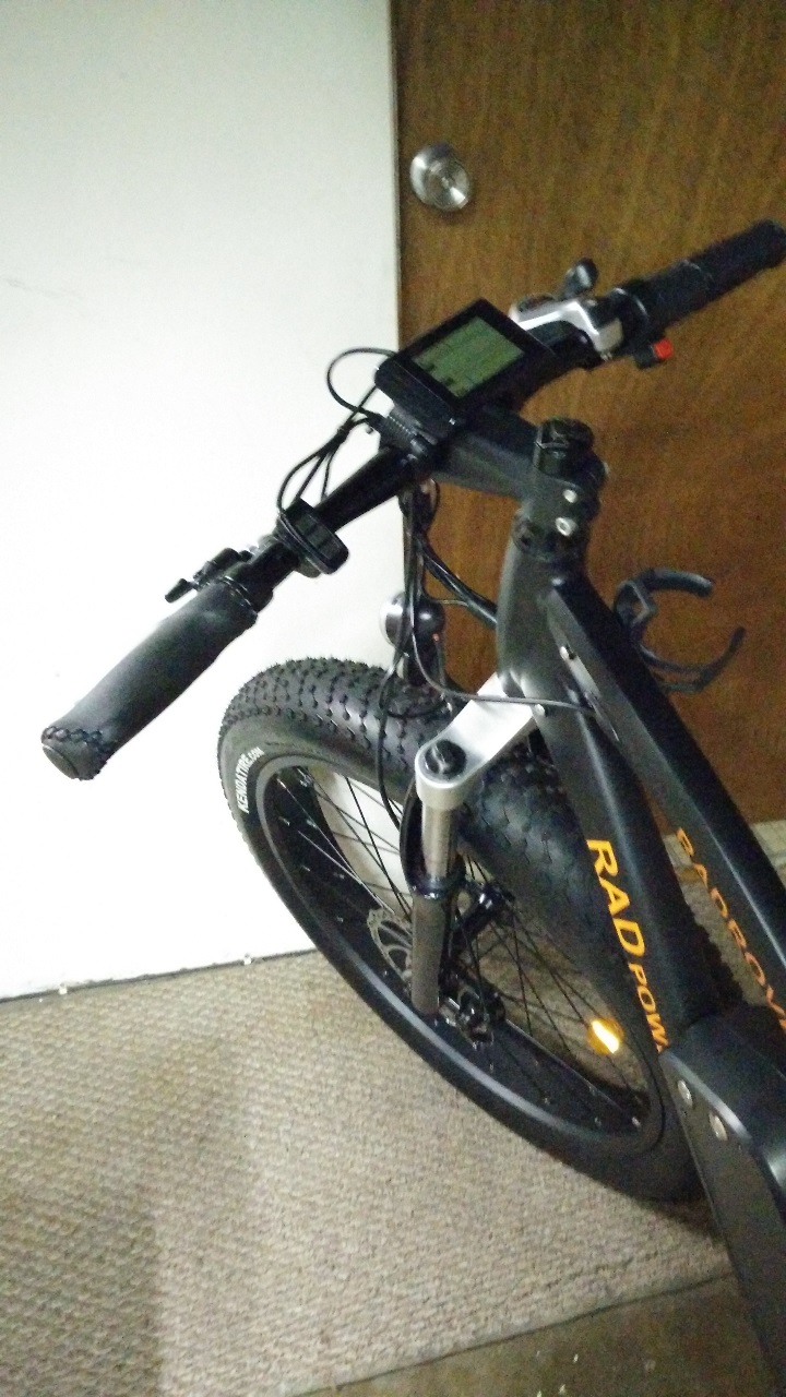

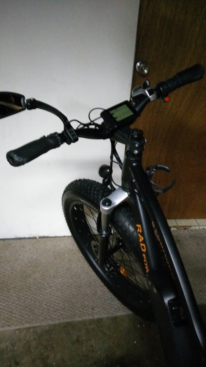

I decided I wanted to sit completely upright and put on both an adjustable handlebar stem and a 5 inch rise, 27 .75 length Sunlight handlebar on. It was an interesting project and took me about 2 hours. The hardest part was getting the handlebar grips on and off. At one point I thought about just cutting them off but the one on the right with the throttle is a shorter one and would be both more expensive and harder to get a replacement. I had to unwrap all the spiral wrap and reroute 1 wire. The only item that wouldn't reach properly is the 3 button controller. I now have to take my left hand off the grip to push on it. A little hassle, but it's not like I'm constantly making changes to the LCD display. The handlebars are wider and I do like the fact that I get extra leverage on the heavy front wheel.
Looks Sweet! It looks like your display is showing the grass in front of you???... Maybe just reflections... :) What tire is that on the front in the last picture?
Mark -
Mark, The LCD display is distorted because the sun is hitting it. For the summer months I wanted to do more of paved bike trail riding so I switched to the Vee Speedster tires which gave me a smoother quieter ride. I also gained about 2 mph.
View attachment 6462 View attachment 6463 View attachment 6464 View attachment 6465
Great work, thanks for sharing.
