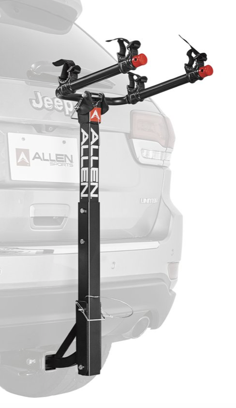

I'm seeking opinions. I have a bike rack like this:
Is this good enough to transport my Helios from Pushkar's facility to Washington DC (approximately 450 miles)? I'm not likely to transport the bike much after the initial pick up, and I'd prefer not having to buy something new.
Thoughts?
Personally I would not use a rack like that to transport an ebike let alone one with a carbon fiber frame. The bike will sway on that and I’d be very afraid of damaging it, especially for a 450 mile trip. I’d recommend renting or finding a friend you can borrow a rack from where the bike is supported by the wheels.

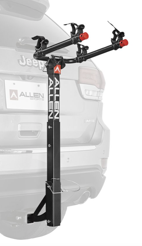

Thoughts?
That rack is rated for 70 pounds total between the two bikes. I would not trust it. It's a $99 rack. The 1-Up Super Duty for 2 bikes is $595. There is a reason that they cost that much. For a bike the cost of the Helios, I'd want something more.
