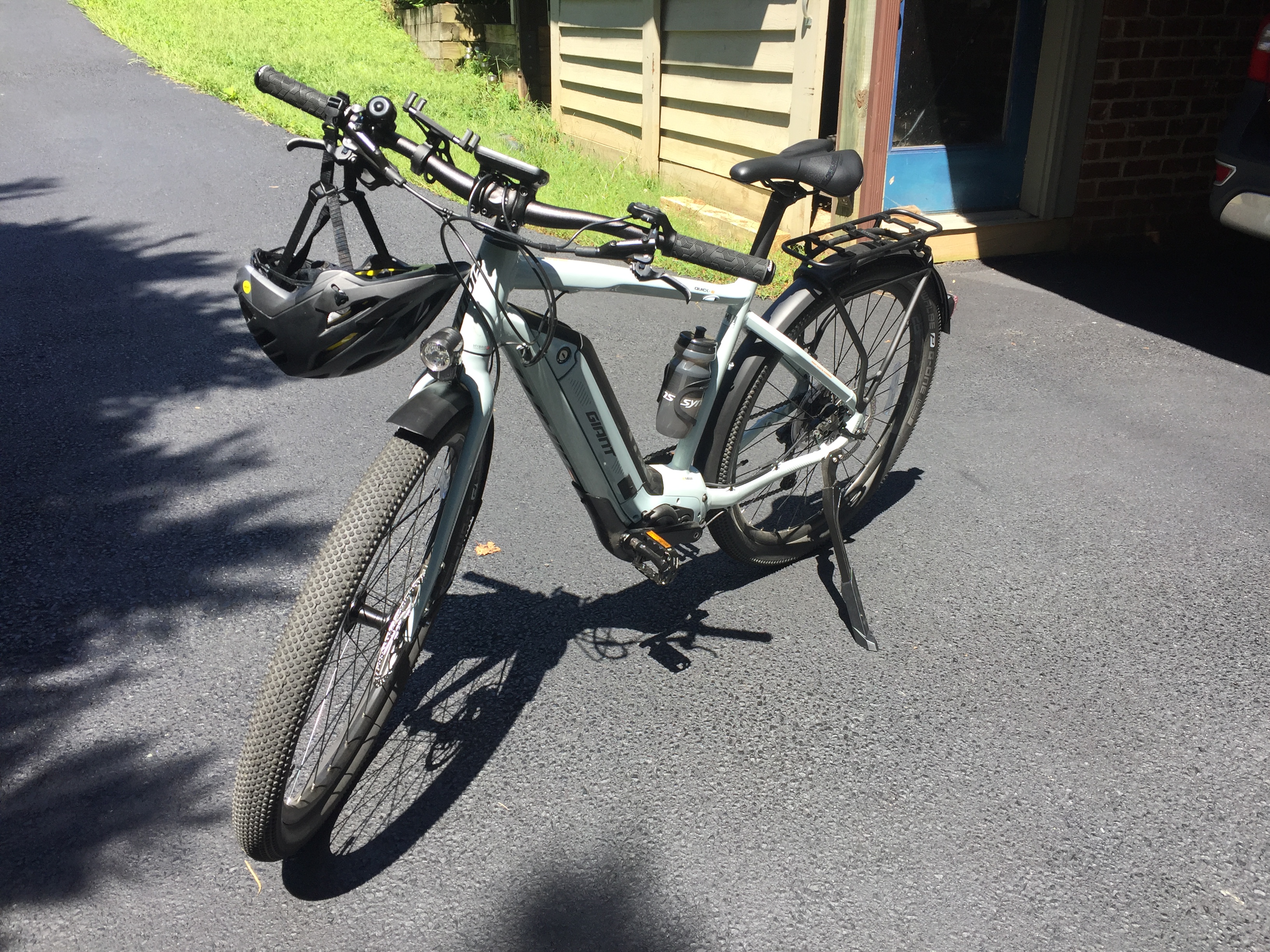

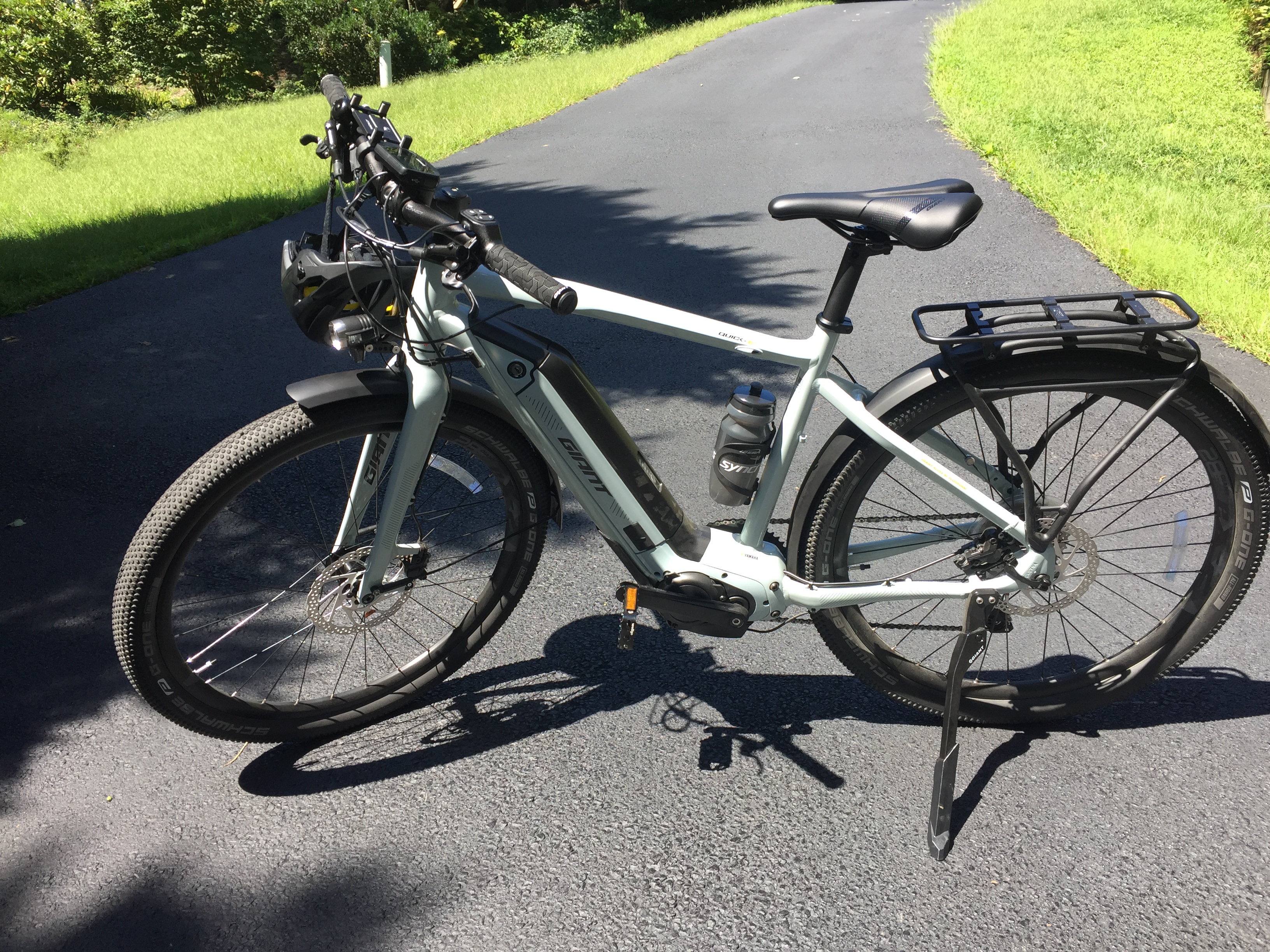

The 2019 Quick-E is a sharp ride. I have the 2018 with almost 1000 miles on it. I have no complaints about the bike. I was a dedicated Trek fan but I got the same impression as you. I just could not justify an additional $2K for brand loyalty. The tires on my Quick - E are just a little thinner at 2.0 inches but the new Quick - E has wider at 2.35 I believe, but I think they are pretty high quality. I ride along the river for part of my commute and I get headwinds, but not anything like those coming off the ocean. I hope you enjoy your ride. I certainly have.
