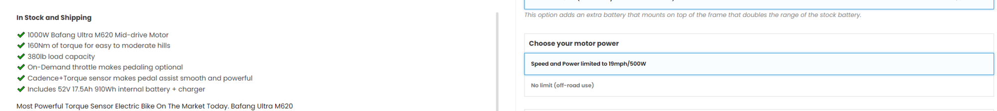

Hey guys, first time ebike buyer and I had some questions for anyone who might have the Juggernaut Ultra Duo 2.
A-bit about me, I've had maybe 2 bikes in my life, fat bikes. 6' tall ~330lb's with some load at times taking it over that.
(Sorry in advance if these questions are silly basic ebike/bike questions)
-So first question, the bike says it has a 1000W bafang ultra m620 mid drive motor -> but the speed and power can either be limited to 19mph/500W or unlimited? Can I switch between limited / unlimited afterwards? Or is it a different mid drive motor?(At the states our limit for ebikes is 750W, so i do not know if 500W is underpowered)
-Second question, I'm thinking of grabbing the camo color which allows for 27.5x3 MTB wheels. MTB wheels seem like the better bet for my things but would I be able to switch between 27.5X3 and 26X4 fat wheels afterwards without needing to change the fork? Do the wheels change the load capacity? (the bike says 380lb load)
-Third question, I've seen some issues with the bafang motors in the forums, don't exactly understand what the problem is with them. Is it something that will effect new models or is it just older models?
-Fourth question, if it's limited to 19mph and 500W but has a 1000W motor will it just do it's best to max at 19mph and stay there?
Thanks in advance.
500w isn't exactly underpowered - it's twice the power of anything available in Europe, but more is more... These are quite heavy bikes too!... On the programmable Ultras (uart based) you can set for both power and speed. But chances are you'll receive a canbus based motor, and it's not currently possible to change the settings on these motors like you can on the uart based motors. Well, you maybe able to change the speed setting on the screen settings, but not the actual power (watts) which is programmed on the firmware. This kind of answers your third question too.
If it only has half the power available I'd expect it to only have half the torque.
The Ultra motors peak at 1500w, so limiting them to 500w is losing out on a fair bit of potential.

So I got this message from support
Hi,
Thank you for your email.
Please be advised that some of our bikes have the feature to change the speed and power through the display.
You may check some information on this link https://biktrix.stonly.com/kb/guide...kes-does-biktrix-sell-zbB866x9HG/Steps/956643
If you are limiting the maximum speed on your eBike (from its original capabilities) due to regulatory requirements the bike will still be able to deliver the same low-to-mid-end Torque but as it approaches the maximum speed it will start reducing the power delivery.
Practically, this means that you will still be able to climb that steep hill albeit at a reduced speed. On a mid-drive bike, you would be able to climb the same hill at nearly the same speed (limited to max set speed) as an unlocked bike with proper gear shifting techniques.
Since the Juggernaut Ultra Duo 2 is a mid-mounted motor eBike, changing wheelsets from 3" MTB tires to 4" fat-tire is much easier than a rear-mounted motor eBike.
Thank you for your patience. Have a great day!
So they said nothing about being able to unlock it but it seems you are able to lock it to specific classes based on the display? So I think the unlimited is the way to go​
