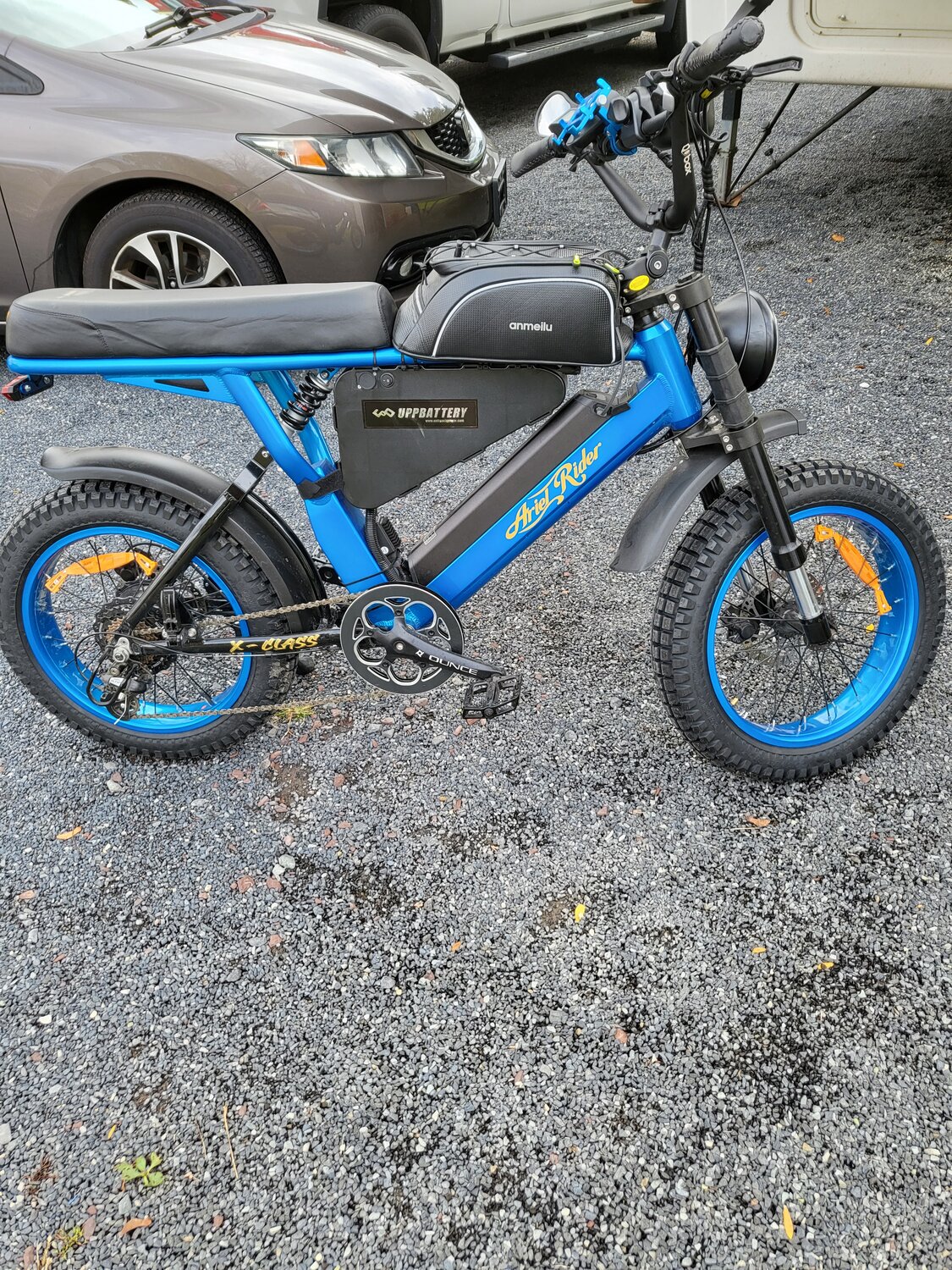

Bought 2 Ariel Rider Xclass 48v. For $1,499 each, added 2nd Uppbattery and blender for about $600 each.
Unfortunitly 48volt discontinued. Have at least 50 mile range. Yet to run down the batteries to zero.

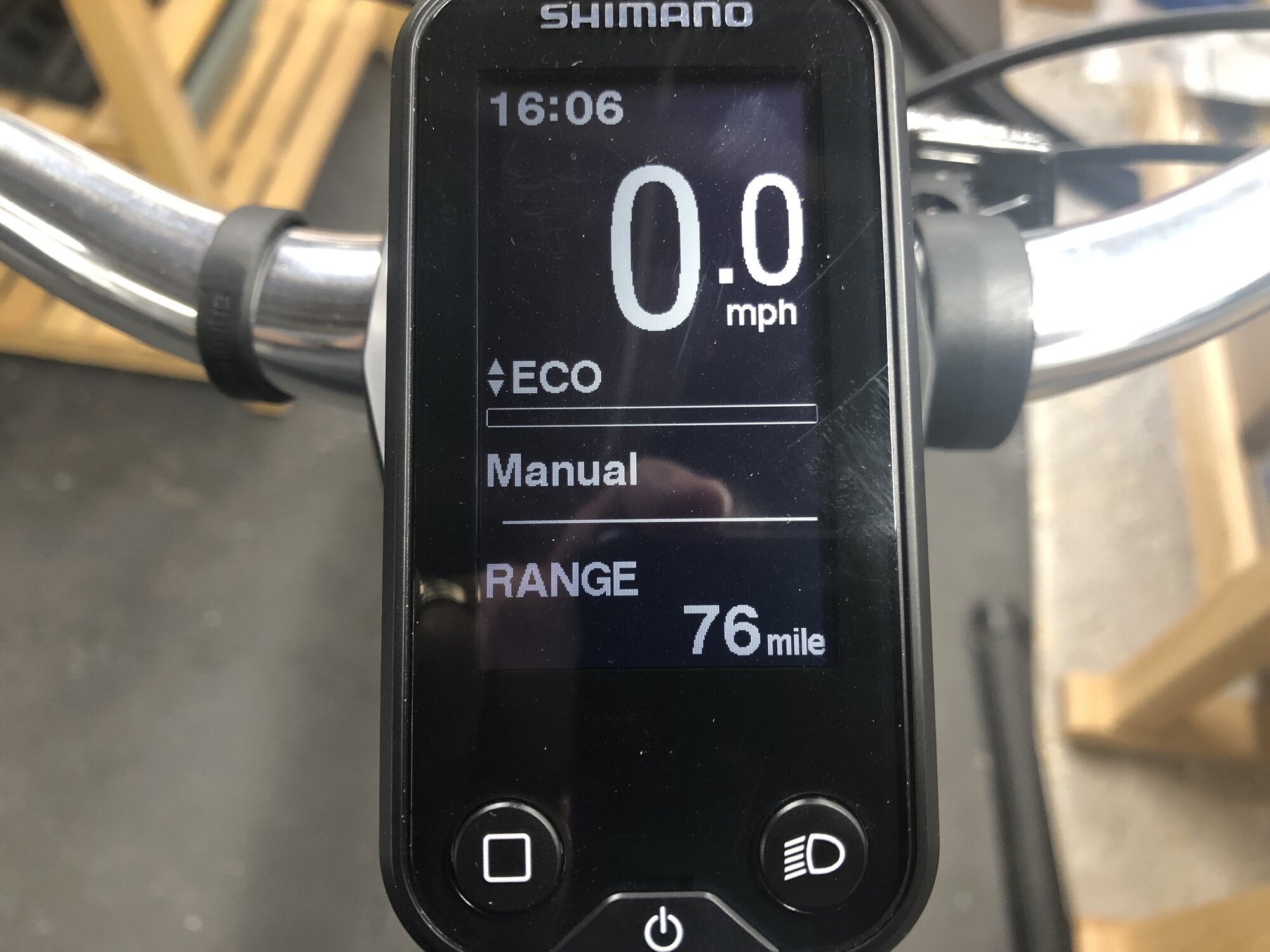

I have an e6100 cruiser and if I put it in eco mode, it says I can get 76 miles range. But it's above your price point. I also have a Giant, and a Specialized. Same thing!

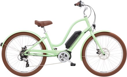

How about one of these?
Those bikes terrify me. I prefer being upright and eye to eye with most cages.
