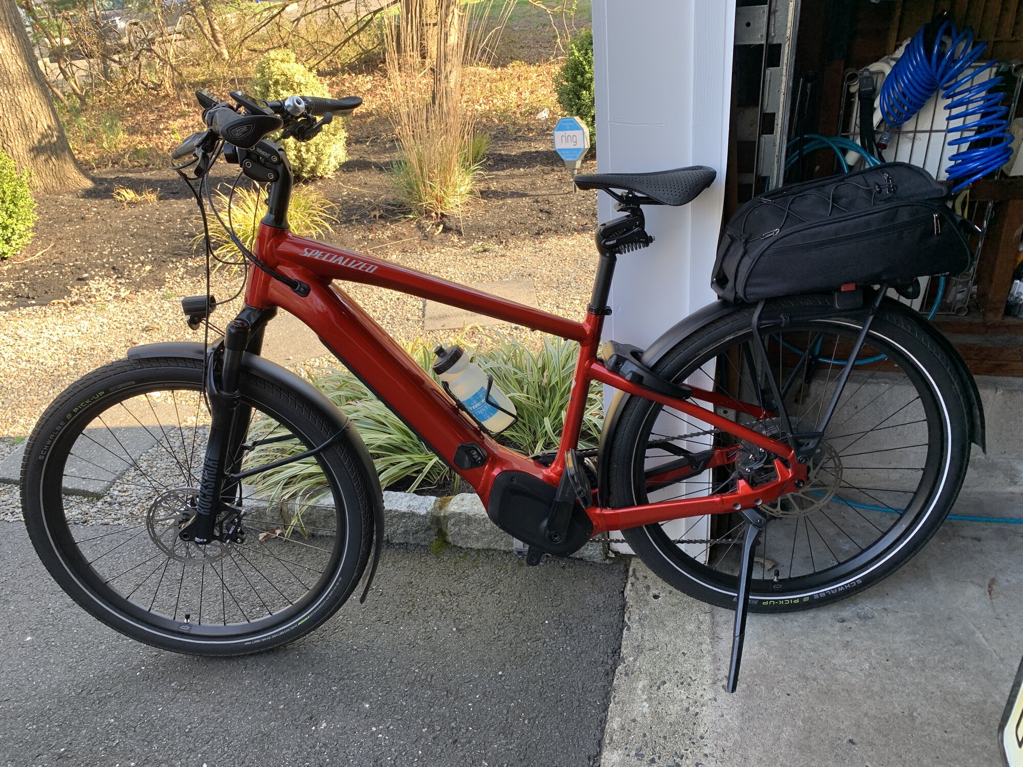

excellent progress! looks fairly believable now. do you have any way to adjust the handlebars up/down and forward/back?
concur on the replacement of the shorts, the pads do compress and wear out. also make sure you've fully healed before you push it, and only increase ride distance gradually. e-bikes make it VERY tempting to just keep going, since the motor is taking care of what would normally be ride-ending leg/cardio fatigue lol.

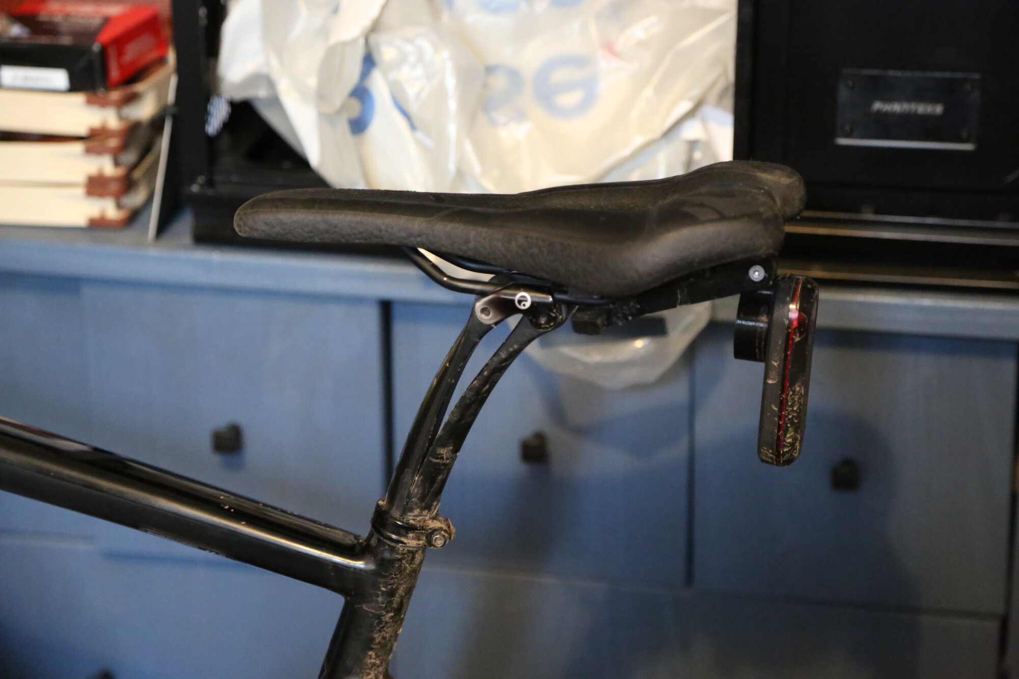

Excuse the dirty bike, but did a 62 mile ride yesterday and have not have the chance to clean it yet. This is most comfortable seat / seat post combination I have found. The seat post is the Ergon CF3 split carbon, which acts like a leaf spring and give the same level of damping as the futureshock. The seat is SQ Labs 60X, that give 3 different level the sit on and it very comfy. The Aussie bike fitter Neil Stanbury highly recommends these and I agree.
With all the positive comments about the Ergon grips, I'm surprised more folks aren't using Ergon saddles. Two years plus to date and all my other saddles are now vitamin D deficient.
I'm apparently too short (Medium Creo) to use Ergon CF3 split carbon post. It runs into the boss for the water bottle cage on the inside of the seat tube.
