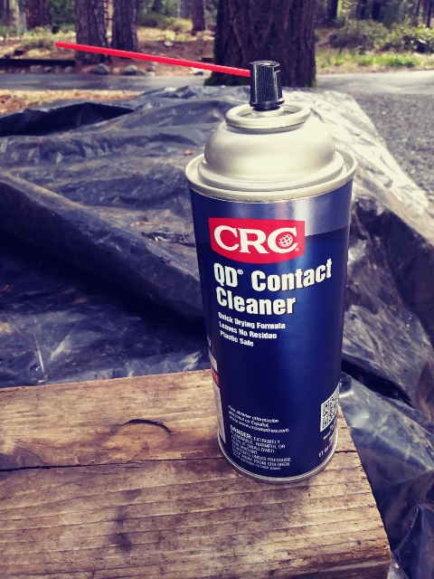

I'd suggest unplugging, cleaning and reinserting each electrical connection. Contact contamination, even from the factory, could be your problem. Connections that feel tight should also be unplugged and cleaned.
For our ebikes I use a 'plastic friendly' contact cleaner, see pic.
I also use a dielectric grease on the power connectors to minimize corrosion. I've read that some others use this on all their connections.
