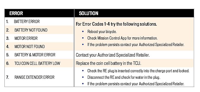

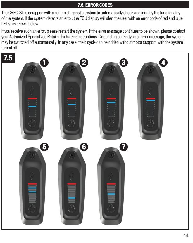

Is there any light pattern from the TCD (the top tube control panel)? The bars can show different color patterns that can indicate error codes. It is in the manual. If it needs any firmware update, that has to be done by the dealer - the user cannot do it.
there are no ERROR on the screen ,just three blue bars
