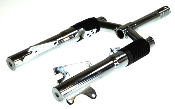

That fork looks like it could be replaced with something like this that has brake tabs
