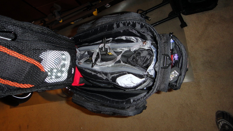

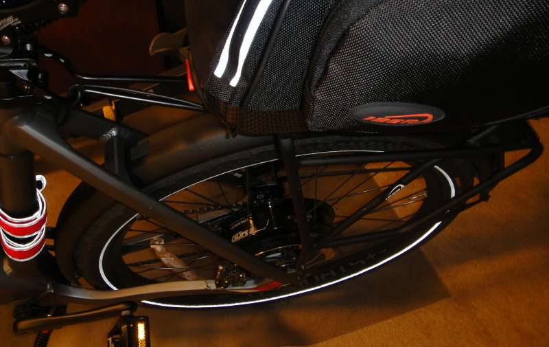

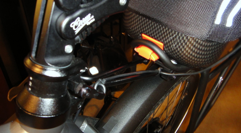

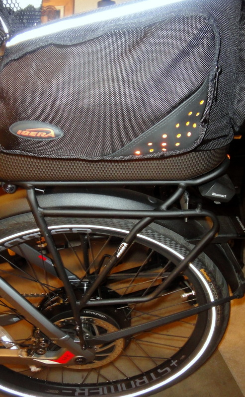

I got the "Ibera PakRak IB-RA5 Touring Plus Bicycle Carrier" and "Ibera PakRak Bicycle Quick-Release Commuter Trunk Bag" which fits the ST2S like a glove. You do need "Axiom Trekk Seat Collar w/Rack Eyelets, 31.8mm" to attach the rack.. I also skipped the disc brake spacer supplied with the rack and connected it directly with the fender mount screws.
You have to flip the seat post "bars" to just the right position to get it to fit without touching the fender but once done it is solid as a rock.

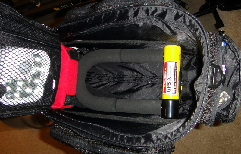

The trunk bag is HUGE. In the bottom is plenty of room to lay my "Kryptonite New York Standard Bicycle U-Lock" that I covered the U part with "DMI Foam Hand Grip Replacement for Standard Handle Canes" so it has some really great cushion on it when I use it against my frame.
DSC00135.JPG DSC00136.JPG DSC00137.JPG DSC00138.JPG DSC00139.JPG DSC00140.JPG

Great pics laptop guy. How many cane covers did you buy to cover the lock? 1?2? I have the same one New York lock. What a great idea! I have just been scratching my rear fender every time I place and remove the lock around the rear tire/ frame.
Thanks @goldendorp. I got 2 of them to get full coverage. Each 'grip' is about a 12 inch straight tube. For symmetry I put one on centered around the curve and cut the other in half trimming it to fit on both sides, I butted the trimmed ends against the yellow lock bar.
I had another u-lock that I had used a tube of pipe insulation from the hardware store which is one piece low cost alternative but the cane handle cushion has the exact diameter for the lock bar and the density and feel are so much better. Very heavy duty and meant to be handled all the time so it really seems like it will last forever.
They do take a bit of wiggling to get into place; a tip is to wet the inside of the foam and the metal on the lock with a lot of glass cleaner before slipping it on, then towel dry it when in position. The glass cleaner evaporates better than soap and once dry the foam grips are literally glued in place and will not move at all.
