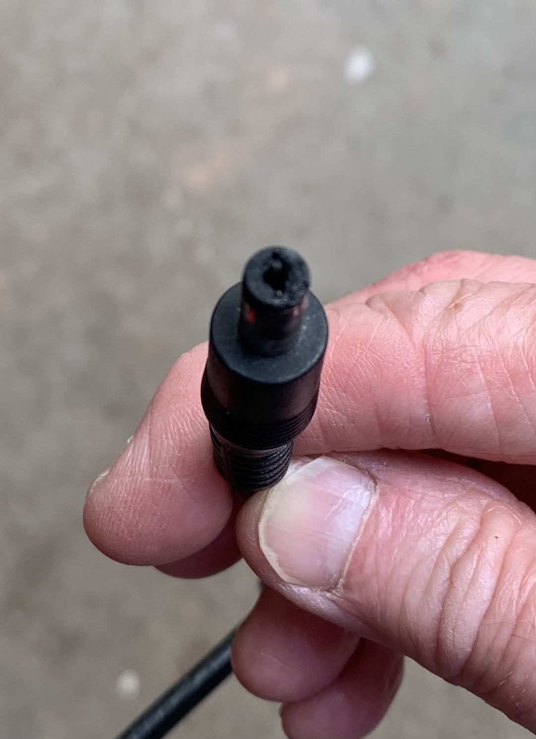

My sister sent me a photo of the cable end that inserts into her battery. She said it sparks when she plugs it in and the end looks charred. What can that indicate? She has her charger powered first and then connects the charge cable to the battery, as instructed for proper sequence. ( bad cable or charger perhaps?)
Sparking is pretty common, but charring isnt a good sign for long term reliability.
My charger always sparks, but no damage beyond very slight arcing marks on the pins themselves.
Im simply guessing that theres poor contact on the pins causing a hot spot.
She lives 3 hours away. I told her to take the cable to the nearest bike shop that handles ebikes and they might be able to point her in the right direction.

I'd say that plug looks far too burnt to have been plugged in properly.
The charge port in the battery itself is probably all burnt as well, and that's not good because a new charger won't fix that and the charge port probably needs to be replaced.

The manuals for all my chargers say to plug into AC first. Since I always get a spark when plugging in the battery, I reversed the process. Yeah, I get a spark at the AC outlet, but it's a whole lot easier (and cheaper) to replace an AC plug & wall socket, than a burned battery connector. I've been doing it this way for 5 years without damage to battery, charger or wall outlet.
IMO, since higher voltages are involved, charger manufacturers are recommending AC first to limit liability should someone get a shock.
She took her battery and charger to a bike shop. They've seen this before and suggested plugging into the battery first, otherwise they saw no major problems. She was worried about "burning down the house", so she used the outlet in the garage. No spark... Without being there, I am unable to say her other outlet is a problem and so I just said to keep charging in the garage and don't leave the general area while doing so.

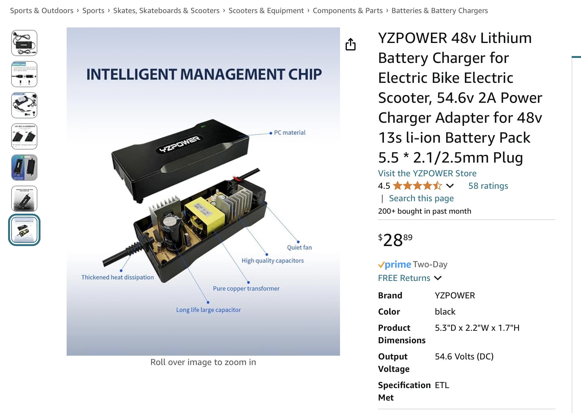

Someone on another site recommended this charger replacement. I’m 72, this motor kit was a gift to my sister, so I want to get it right. I know very little about volts and watts. This should work, right? Or is there a better one? The price is good. I thought these would be much more money.
If the battery is 48v, then yes. The plugs look the same.
BEFORE USE it would be a good idea to verify the polarity matches the old charger. Typically, the outer “ring/shell” is ground and the inner contact is positive.
Honestly, I like the chargers with a fan built in. I can hear the fan while charging. When I hear the fan stop, I check and view the current with my in-line watt meter.
