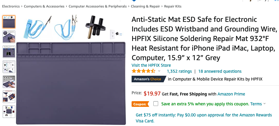

Consider using grounding devices when working with a BMS. The biggest reason EM3ev and others stopped selling BMS was due to DIY fellas killing the BMS with poorly understood electronic repair techniques. Static electricity can smoke a BMS.
