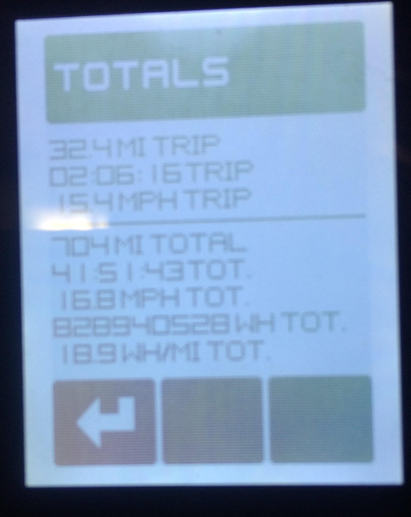

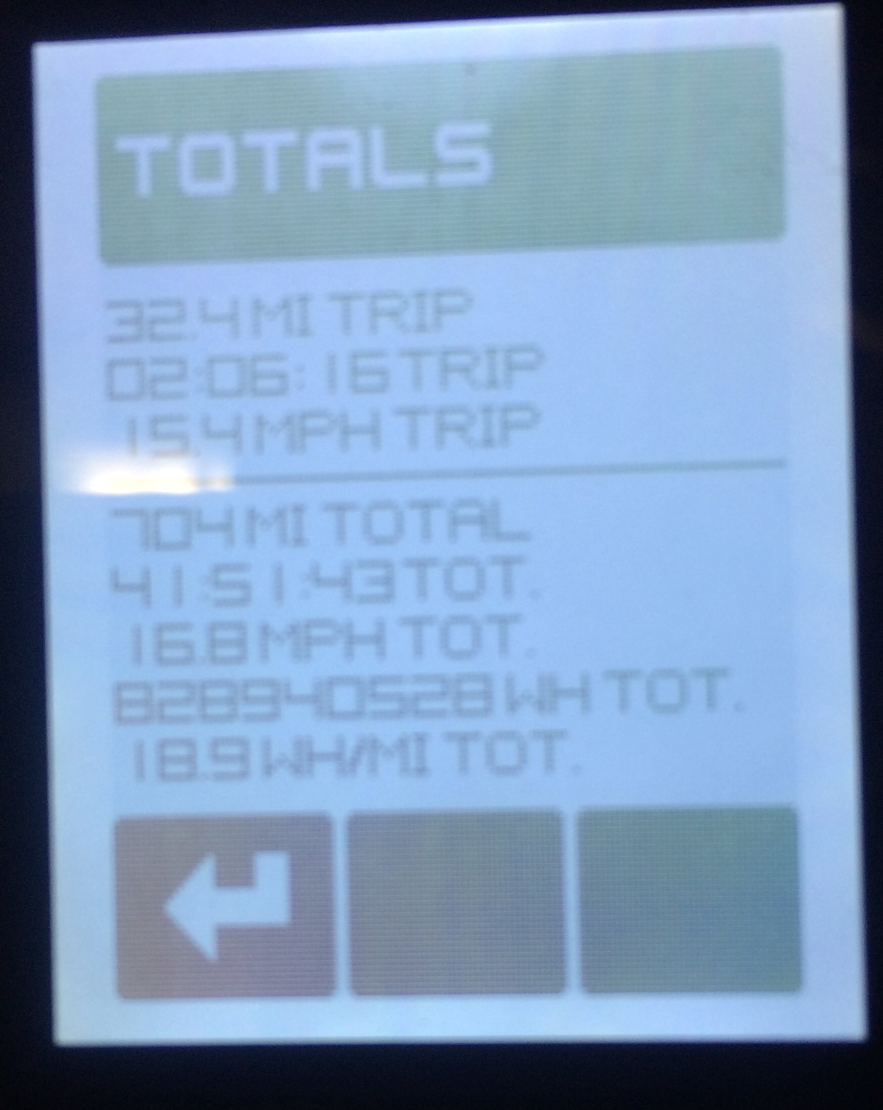

Hey 86, regarding your odometer comment. It's not entirely intuitive but the main "ride" screen on the bike does scroll through 2 other screens by pressing on it. Your on-bike trip odometer is there. See below.
Thanks, not talking about trip odometer but bike odometer. I did find it buried in the phone app but was just wondering why it isn't on the omni screeen.

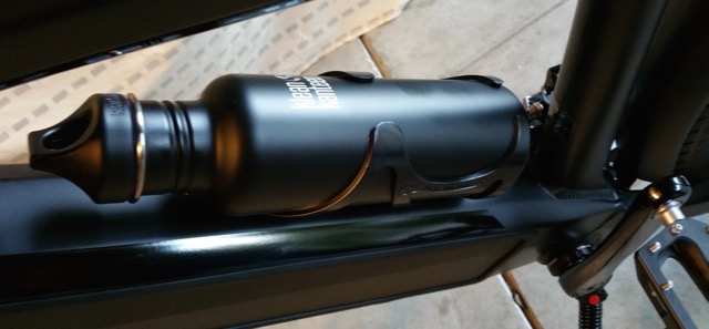

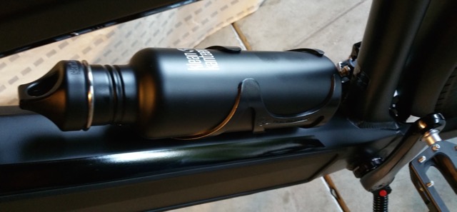

Can I ask what bottle holder you bought?
I have the Klean Kanteen in white. Did you know that you could buy a spout top for it: http://www.amazon.com/gp/product/B0083F0JKA
The holder is a very expensive item something on the range of $6US. It is made by Klean Kanteen specifically for the bottle.
How do you find the quality of the holder? I've read many 1-star reviews on Amazon saying that it breaks easily after normal use and the bottle can fly off onto the road. I must say that it looks nice, but I'm a little dissuaded from buying it after reading the reviews.
Pretty Cheap. However I do not reach for my bottle when riding.
