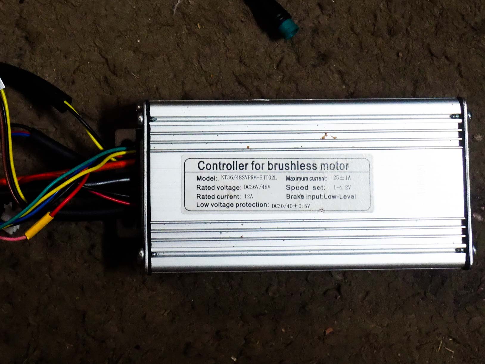

39V? That's what LVC would be if the controller designer used 3.0V/cell as a minimum. On this dual voltage model, it's 30V and 40V. In real life, I find voltage sag shuts them off about 2V higher.

harrys I have my controller set to shut off at 42 volts but the battery shuts off at 45volts quess its the BMS card doing this.
