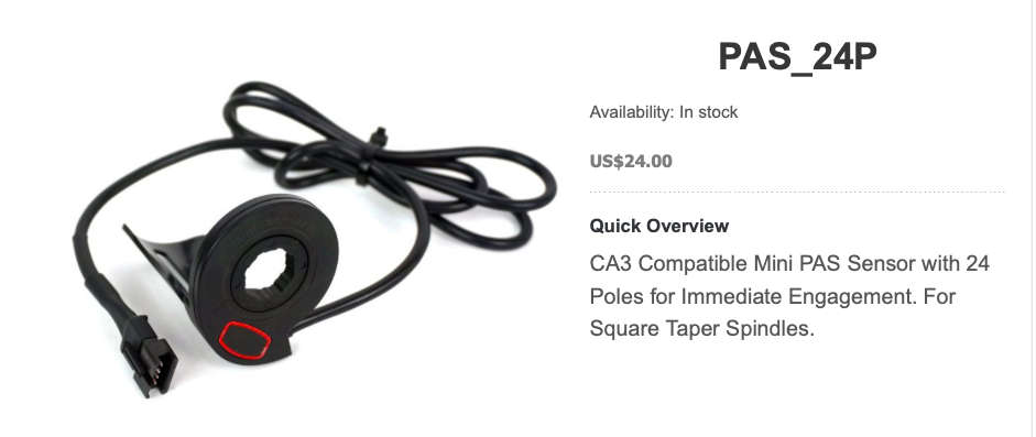

Yes, more magnets more sensitivity. Faster reaction. That is why most have gone to 12. 5 years ago 12 magnet versions were not as common. The market reacted.

Even more sensitive is this 24 pole. eBikes.ca

I have this PAS and tried it out for a few weeks - works great. The additional magnets does mean a faster and smoother engagement compared to the 12 magnet options and with certain controllers you can program the experience to be more natural as well. Great recommendation.
While I enjoyed testing out the PAS configuration first hand, I have always been a torque sensor rider (Bionx motors until this year) and just installed my ERider-T9N torque sensor connected to a Cycle Analyst 3 (both from ebikes.ca as well) - what a difference and I'm back to feeling like 'super human' when I push hard down on the pedals to go faster.
