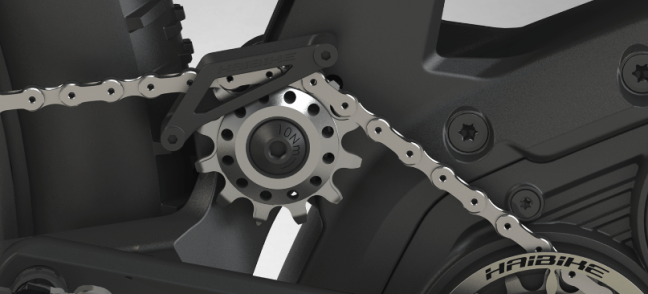

I have two CX-equipped bikes, a full suspension Haibike and a Raleigh hardtail. The FS has the SES pulley (pic below), the HTdoesn't.
The FS is much louder than the HT, which I attribute to the pulley. Even when the motor's off it's freakin' LOUD.
Addendum: I checked the pulley's bearings recently, they were clean, smooth and are now re-greased. Still loud - maybe it's the chainguide.
Did you mess with the
Derailleur in Rear
It's probable then it needs adjusting just like a Regular bike : Chain noise is usually Rear Derailleur : It doesn't take much. If it's not centered it gets noisy
