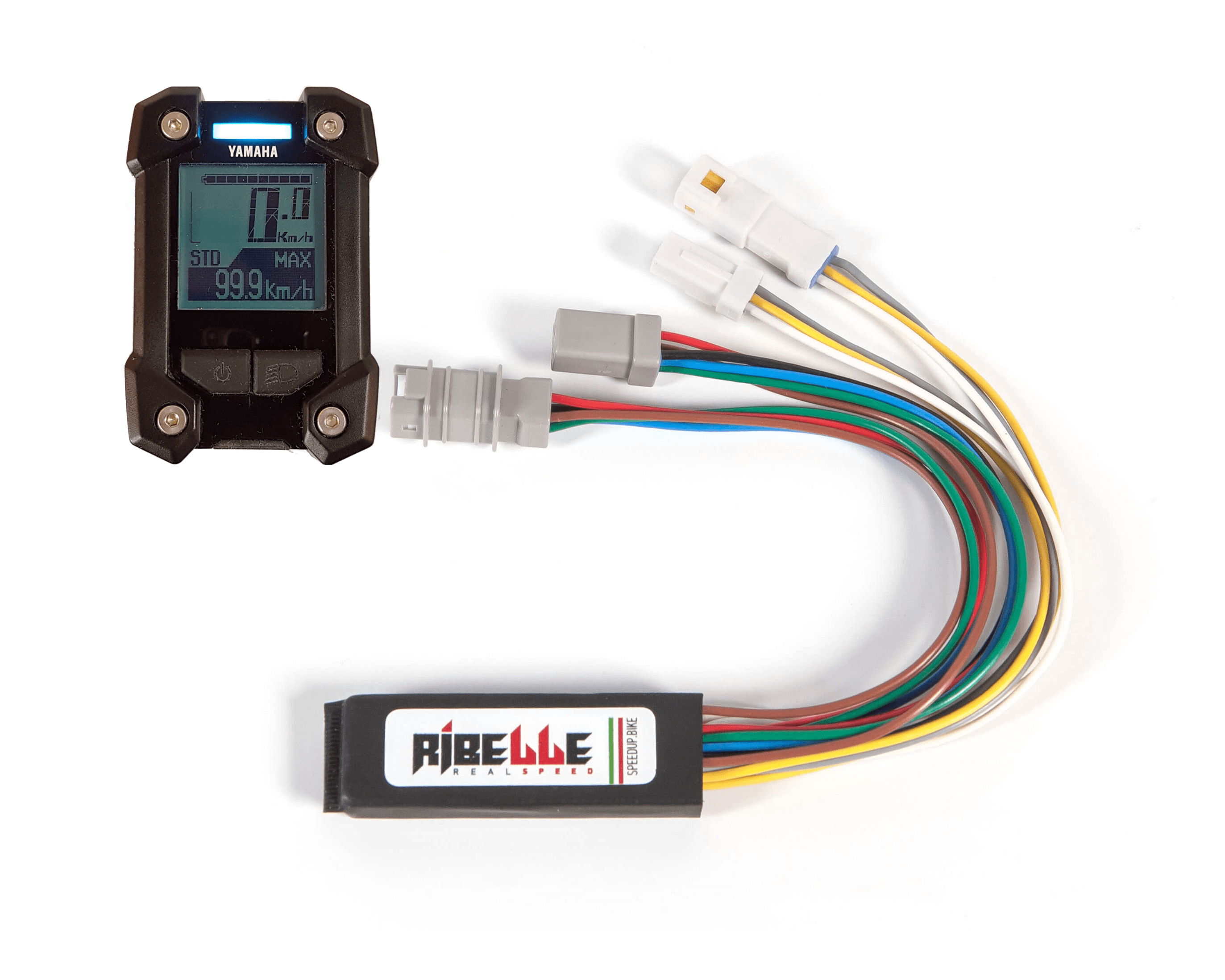

Rebel HT #3 (Medium 27.5") arrived today from BBB. Came with larger display and PW motor like my other 2 bikes. I'm actually fine with this as I wanted interchangeable parts between the bikes. Also, if you want to tune the speed limiter it's about half the price vs. the PW-SE:
PW-SE is pricier:

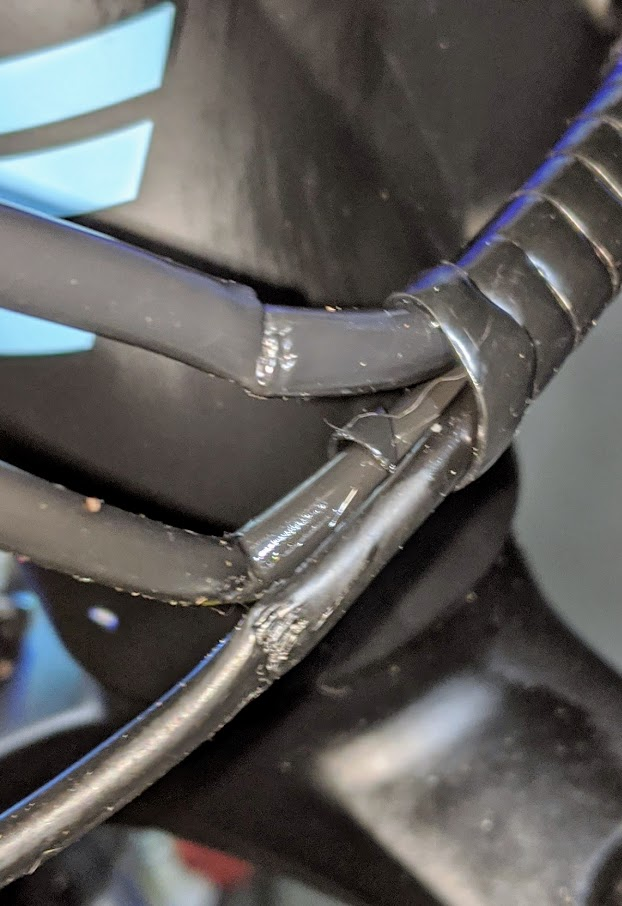

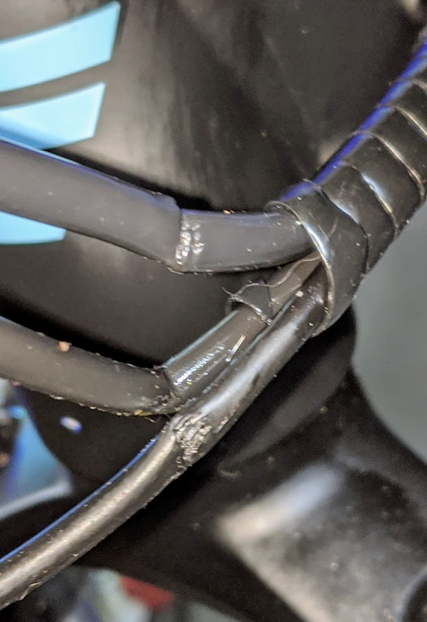

Got my third BBB $777 deal bike today (got it for a bit less) - a Med Rebel Lite 29er.
The first two bikes were PERFECT (27.5 L and M) - no blemishes that I could see, batteries charged right up and everything worked perfectly; even the shifting was dead on and required no adjustments.
First thing I noticed about this one, however, was that there was no resistance on the rear brake. I thought maybe the orange pad spreader came out, but upon squeezing the lever another time I started to see brake fluid on the floor.
Upon closer inspection, there was a cut across the brake line, electric wiring and shifter cable housing that must have occurred in packing or shipping (pic below). Of the 25+ bikes I've had shipped to me, only one had damage - a 2016 Haibike HardLife ladies model I got for a friend from Lenny's - and it proved to be mostly cosmetic (top cap and fork crown rubbed against each other when shipping). This however renders the bike unusable...
I just emailed BBB and hope this can be resolved with minimal fuss, but it's gonna be a PITA regardless :confused:

Upon closer inspection, there was a cut across the brake line, electric wiring and shifter cable housing that must have occurred in packing or shipping (pic below). Of the 25+ bikes I've had shipped to me, only one had damage - a 2016 Haibike HardLife ladies model I got for a friend from Lenny's - and it proved to be mostly cosmetic (top cap and fork crown rubbed against each other when shipping). This, however, renders the bike unusable... I just emailed BBB and hope this can be resolved with minimal fuss, but it's gonna be a PITA regardless :confused: View attachment 46486
Sorry to hear about your recent issue... BBB has a 30-day money-back guarantee.
PW-SE is pricier:

Thanks, if I have to ship it back I expect they'll foot the bill, as well.
I'd prefer to fix it, however. I can do it but need the parts, particularly the electric wiring.
Like I say, it's a PITA no matter what I have to do to deal with it. I've been lucky with my many online ebike acquisitions so far, so I guess I was overdue to experience something like this.
