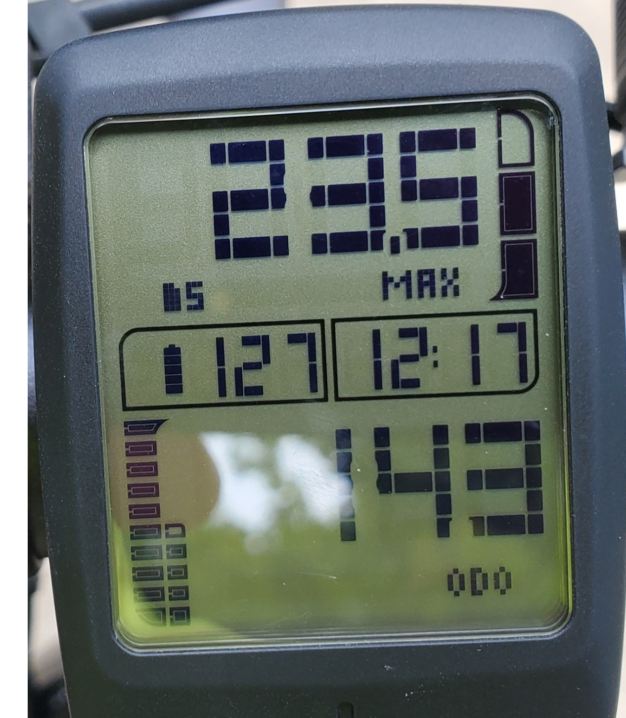

I had incorrectly stated in a post above that the TCD had a mileage estimate. The figure reading '127' middle left is remaining battery percentage. When using the range extender, apparently it reads as 100+%. So I guess 127% of the 320 WH battery. Odd. I would have thought it would read as a % of 320+160 and would therefore always be 100% or less.

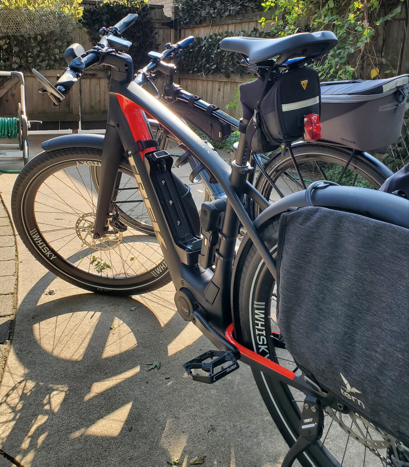

I ordered and received a Racktime Talis trunk bag (purchased on Amazon but shipped from Europe). A few pics:

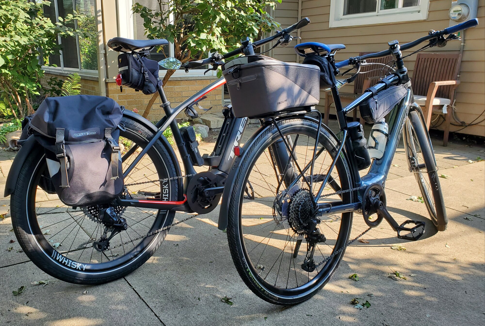

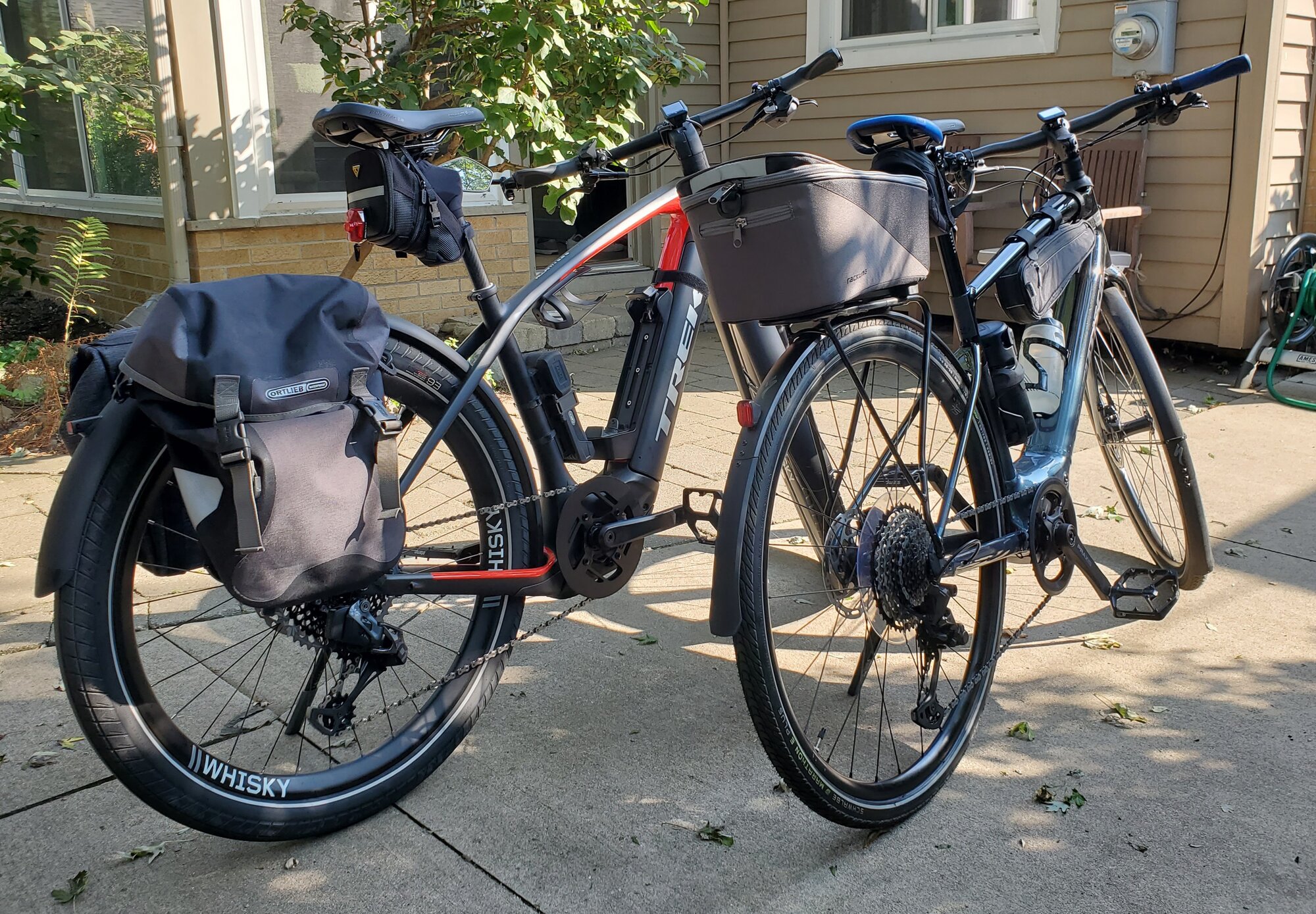

Still lacking time to write up a good summary of observations riding these two bikes. But here are some recent side by sides:
View attachment 66768View attachment 66769View attachment 66770

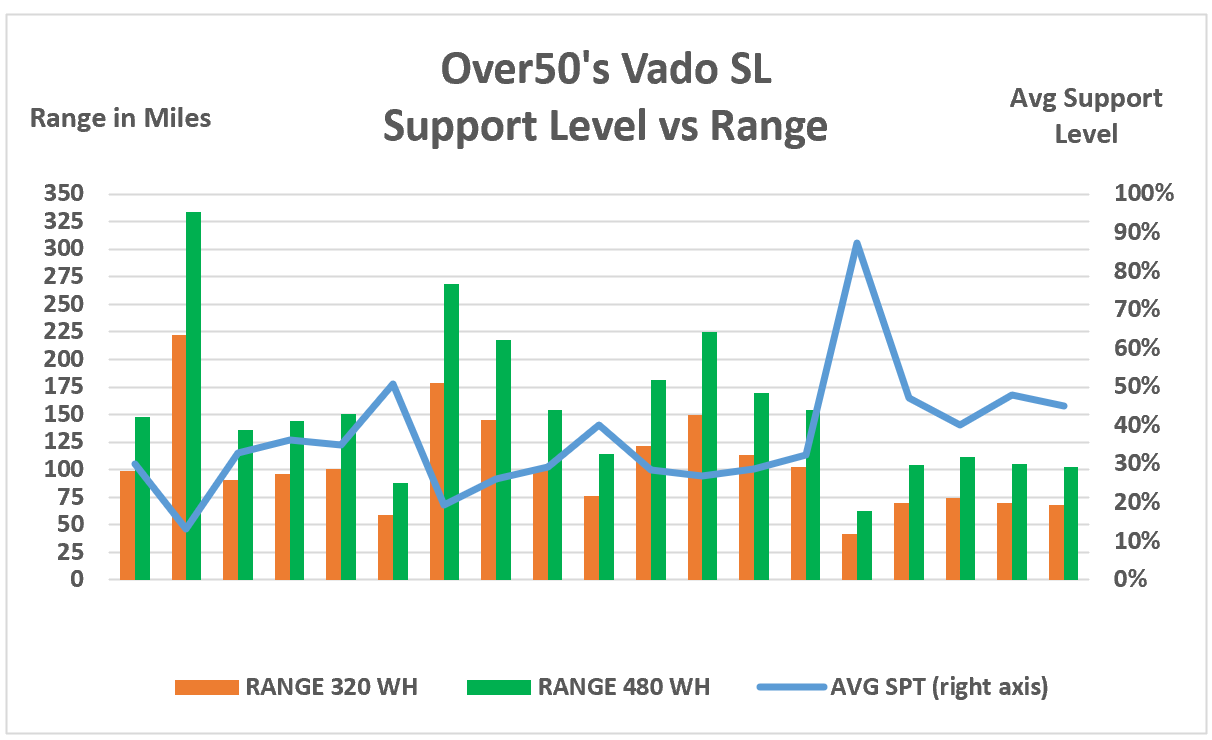

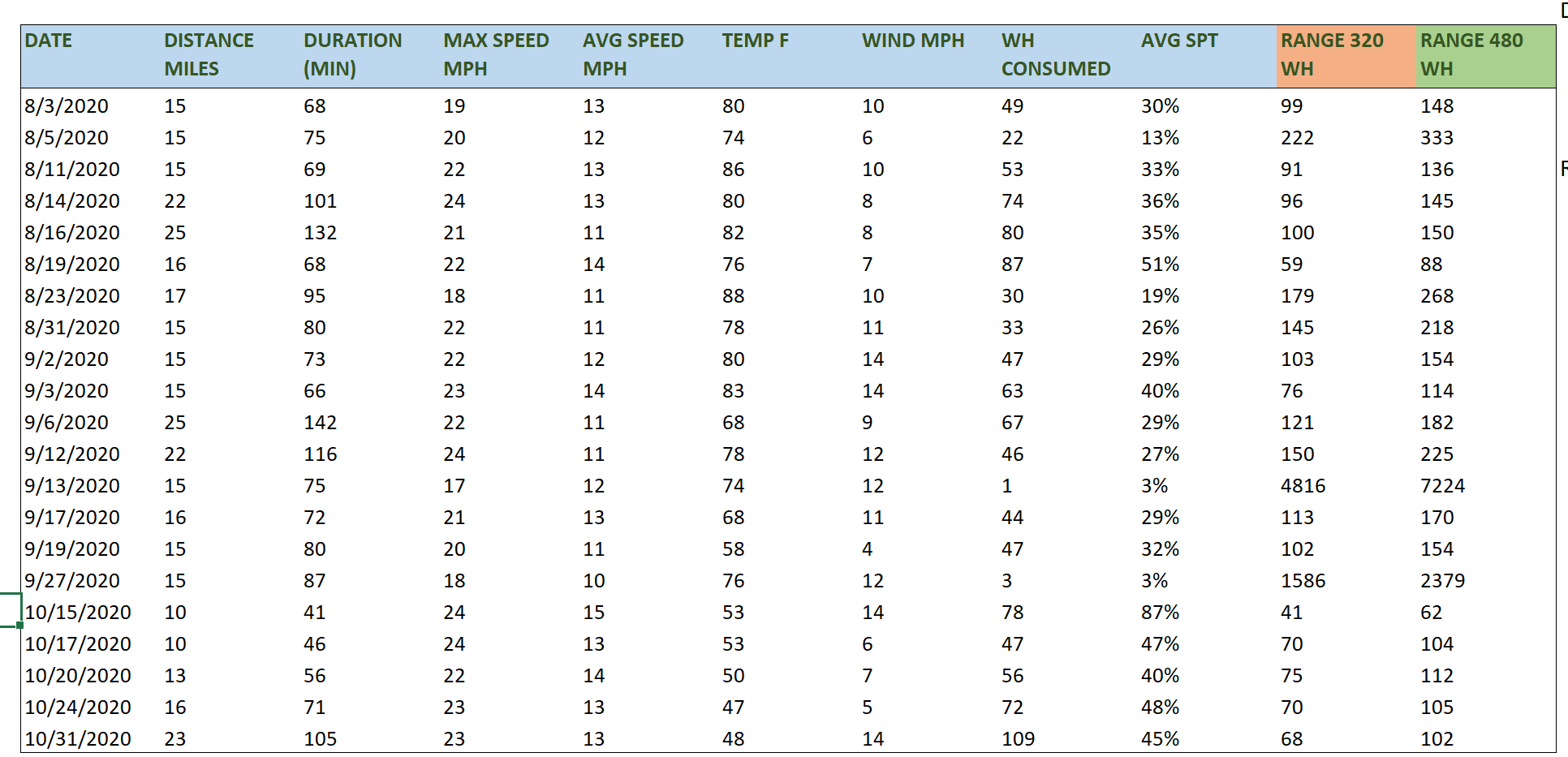

Since there is another thread about Vado SL range, I put some range observations into a table. I don't list elevation since I'm a flatlander:
Removing the two observations where I burned only 1 and 3 WH, practically using the bike without power, the average support level to range (inverse relationship) looks like this:
How did you get all of that data into the tables? Any automated procedure or pick and prune?
Some more musings on range: I felt I needed another observation in a high assist level. I only had one and that was riding at 87% average assist. So I headed off, in the interest of pseudo-science and rode 20+ miles with average assist of 127%. I reordered my data by average assist rather than chronological order to more clearly display the relationship (inverse) between assist and range. I also chose to show the range as stacked columns to give a cleaner chart:
While the range is not stellar, 127% is really easy riding and I have plenty of range on 480 WH to conquer my 35 mile commute (moderate winds). So that is good to know for future commute planning.
