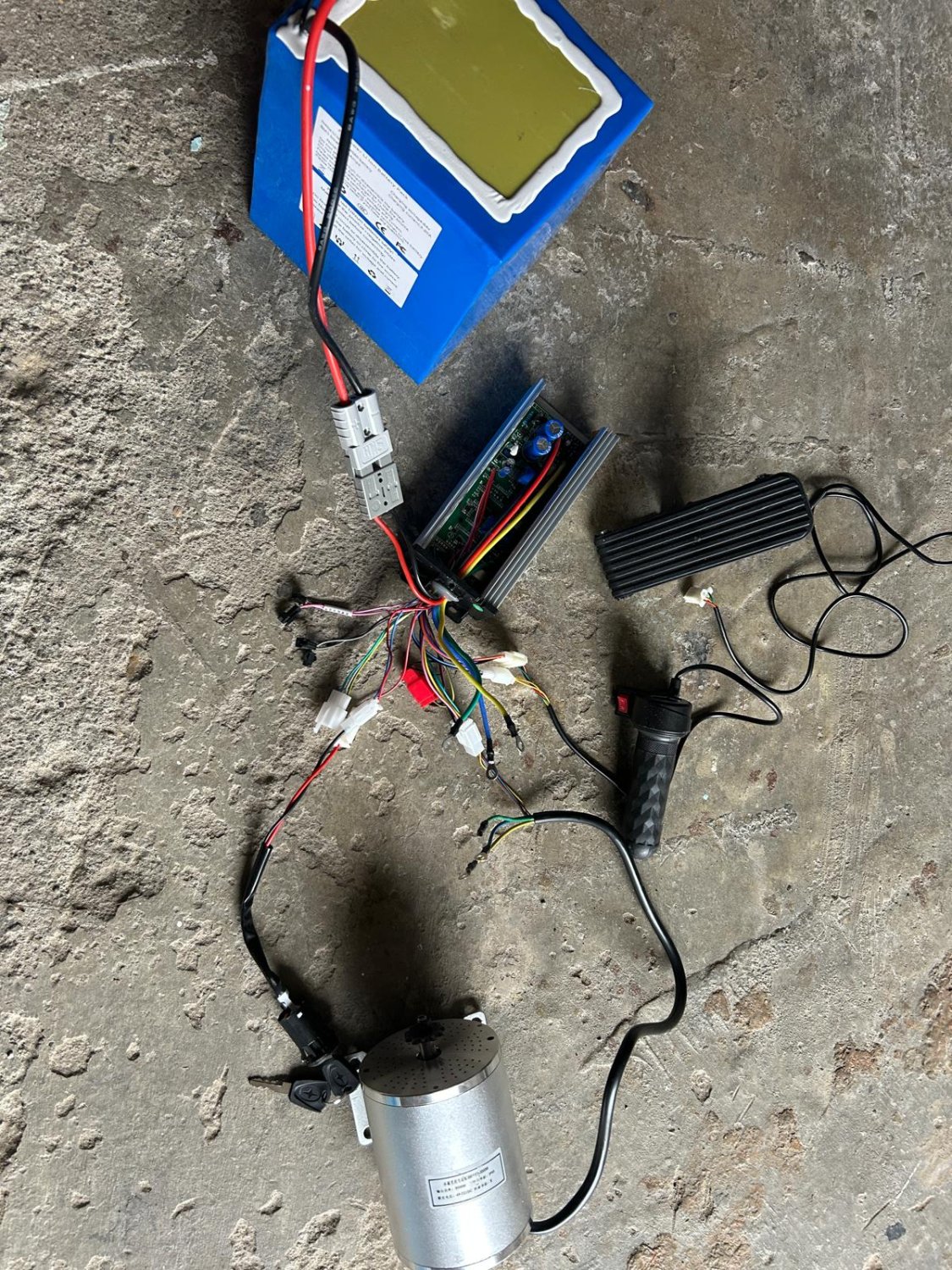

I have added some pictures of how the setup is. Are we missing something? with this setup the engine does not run and we hear or smell nothing,
there is 80+ volts on the entire pcb. We can only connect the throttle or throttle lever of the steering wheel. Neither work. (the phase wires were connected, not in these photos)

Try this flow chart.
If this doesnt work, then probably a bad motor. Again, as previously mentioned, you shouldn’t have any shorts between the phase wires and the motor housing. That alone would be enough for me to send the motor back.
