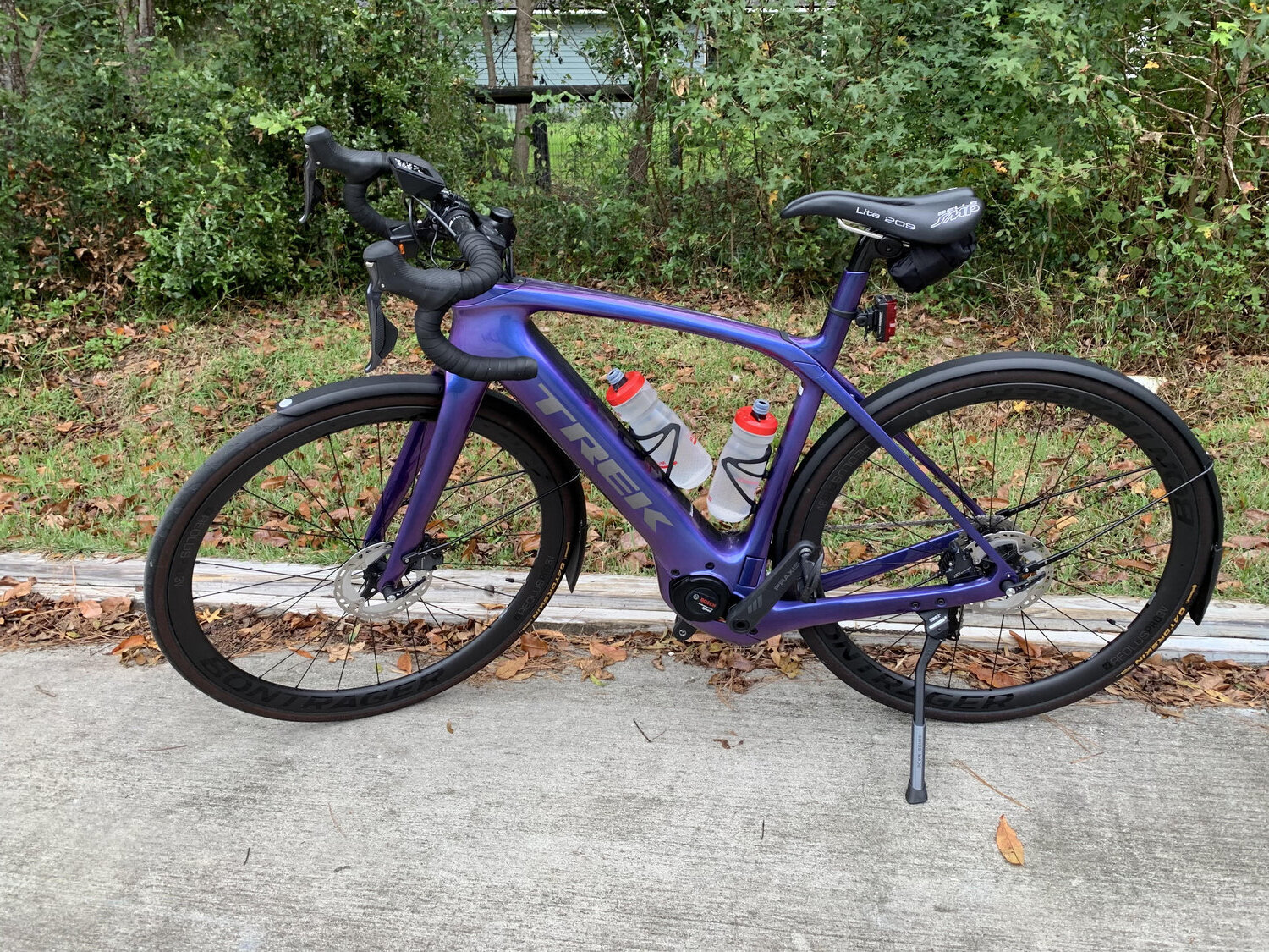

drodg got me thinking. My wife really likes the purple, but purple is not available until August if ordered now and as we know that can slip to even later. In her size, even the default charcoal grey/black is backordered until August but ... a LBS had her size in stock ready to go. I suggested she consider it now if she wanted to ride this season. So, what could be better than a Domane+ HP? I guess 2 of them!
They look great. When I ordered the purple in January the delivery date eventually went until July.. So I ended up getting the grey and really like the color. I have not ridden it hardly as I went to NC this past weekend and did some mountain biking with my teen grandsons. I am back home now and cannot wait to get some miles in this week.
