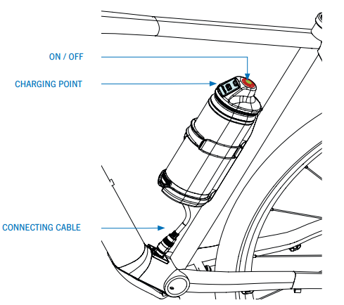

Continuing with the experiences and learning of the Orbea Gain D50, I have come to the conclusion that it will not be bad to have a battery extension system. We have optimized the administration of the energy available in the main battery to the maximum, we have gotten physically fit, we have reduced our mass and that of the ebike as much as possible, but now we want to make long-lasting and more demanding routes, and always count on our support levels.
It is in these cases where we need an additional battery.
Mahle/Orbea has developed its own battery extender, and I'll start by summarizing its features:
Total capacity: 208.8W/h (5.8A)
Voltage: 36 V
Cells: Panasonic
Charging time: 3 hours
Maximum discharge ratio: 1.9 A
Water resistance: IP57
Color: Anodized black
Charging and ignition display: Iwoc One button Charging port protected by a rubber cover.
Dual charging: The Range Extender and main battery can be charged at the same time by connecting the Range Extender to the main battery and the X35 charger to the Range Extender.
Certifications: EN 15194.2017 Bicycle mounting: Specific X35 bottle holder with Quick Lock rubber band. Exclusive mounting on the seat tube *(diagonal tube on the Optima).
Weight: 1645 g with bottle holde
The Mahle Range Extender works like a portable internal battery charger that charges the main battery while it is turned on. It operates differently from other systems in that on the Ebikemotion X35, only the main battery provides power to the motor, while the Range Extender charges the main battery, regardless of whether the motor demands current from the main battery or not (such as at speeds greater than 25 km/h, when there is no pedaling or the bicycle is not moving).
The Range Extender provides charge to the main battery at a discharge ratio of 2A, while the motor can demand current of up to 9A. Therefore, the Range Extender is not capable of supplying enough current to the motor by itself, and all this current comes from the main battery.
So far so good and very nice, but 1) the price of this battery extender is extremely high 2) they are not available on the market today.
This has motivated many desperate enthusiasts like me to look for a DIY solution.
Of all that I have read and seen on the web, Yako's experiments (see attached YouTube link) are the ones that have shown a functional and tested DIY system.
I'm going to stop at this point, and I would like to know your opinions, experiences and comments in general.
Will continue...

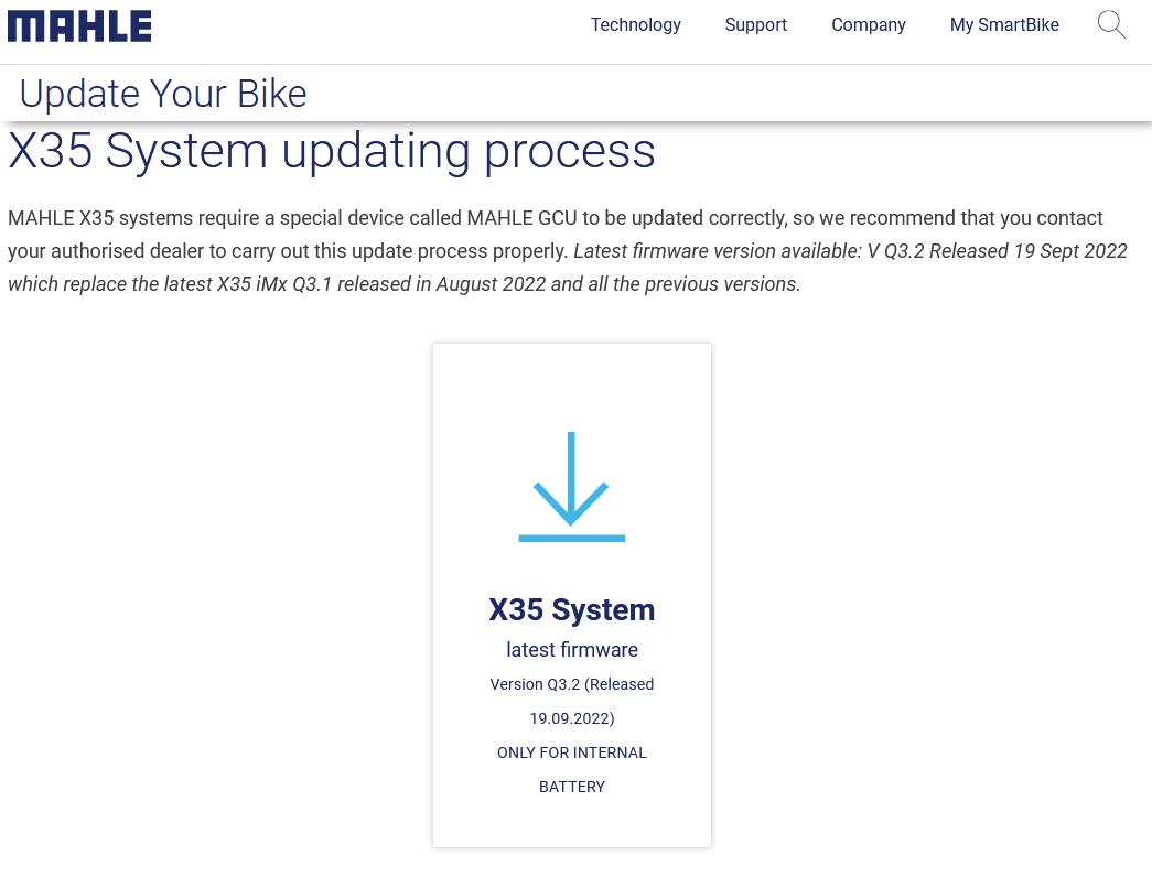

Hello everyone,
Looking at the Mahle page, I see that there is a recent update to the X35 system firmware. Unfortunately there is no information about what is achieved with this update, so I would like to know if anyone has any experience with it and if you can share their experience and knowledge. Thank you very much.
  • 2022-11-01 15_43_13-SmartBike system update - MAHLE SmartBike Systems — Mozilla Firefox.png
