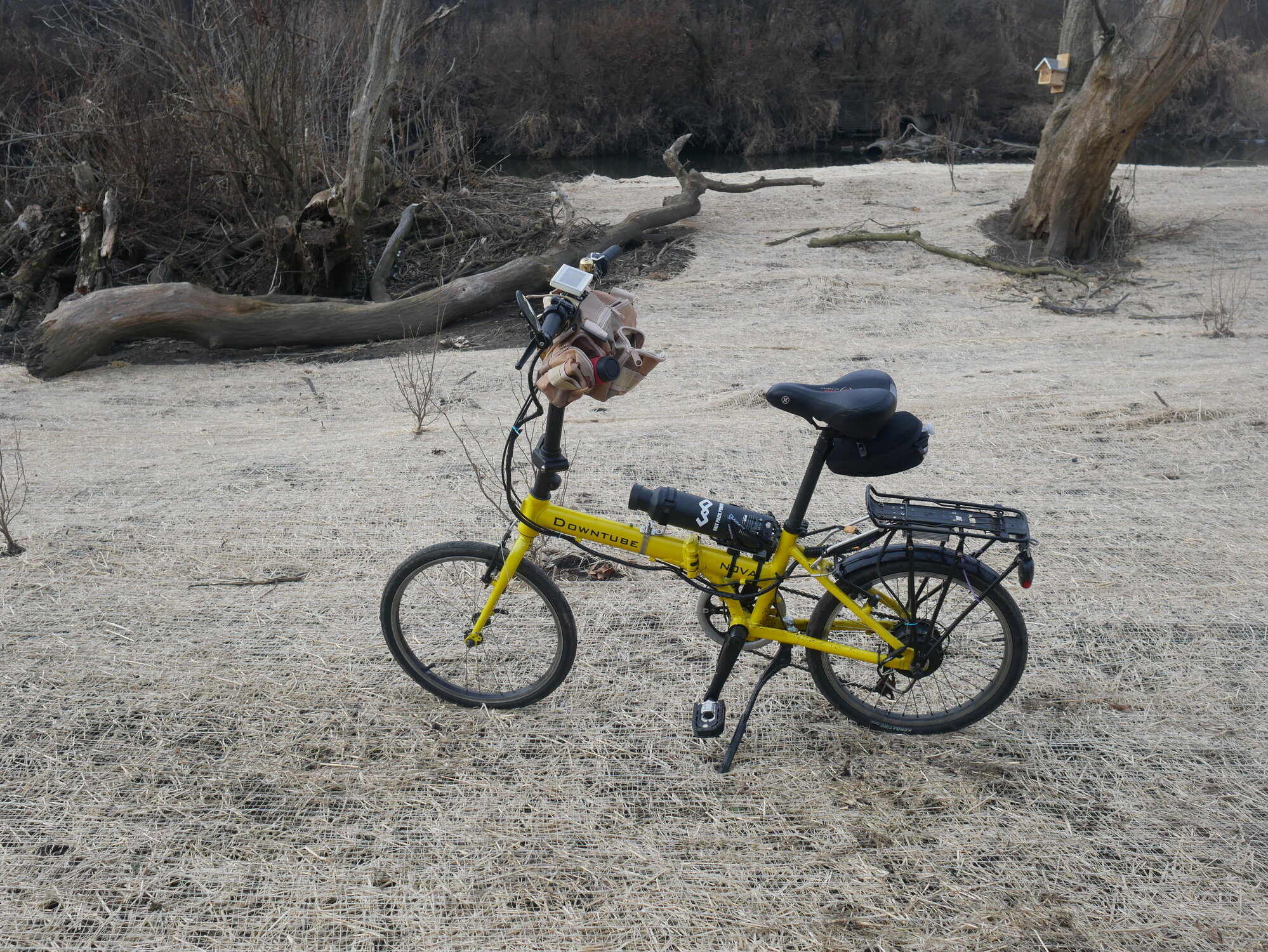

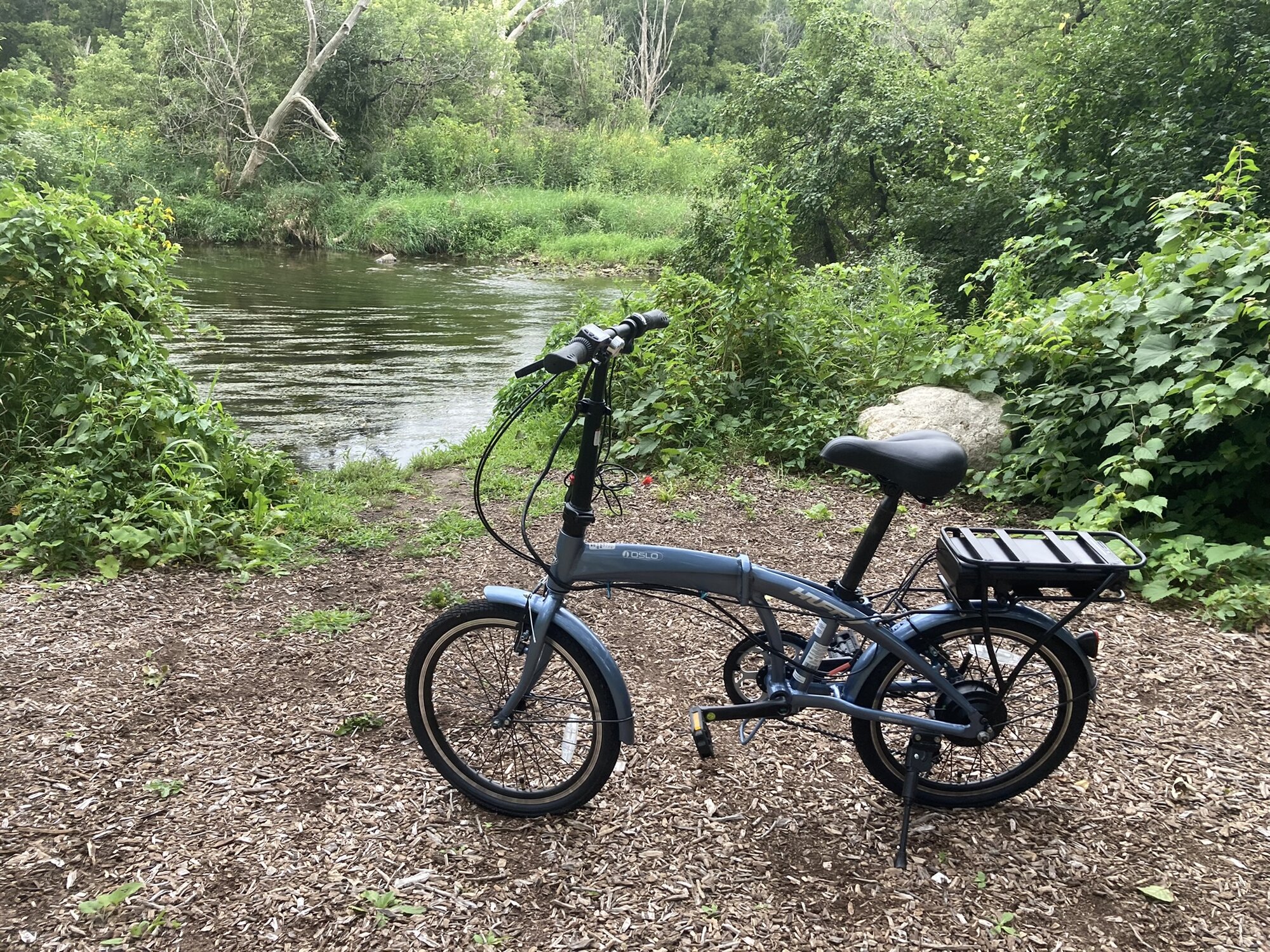

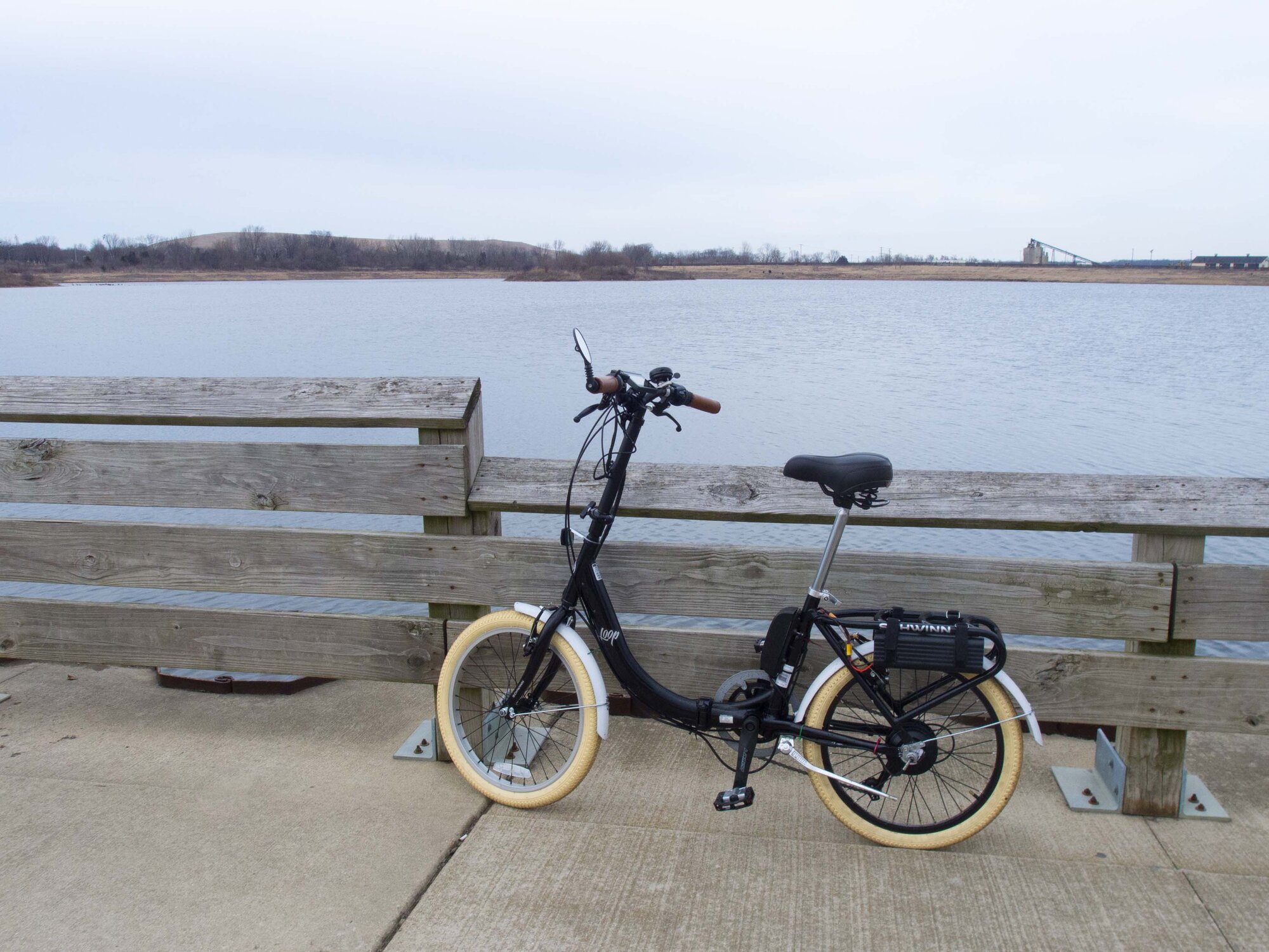

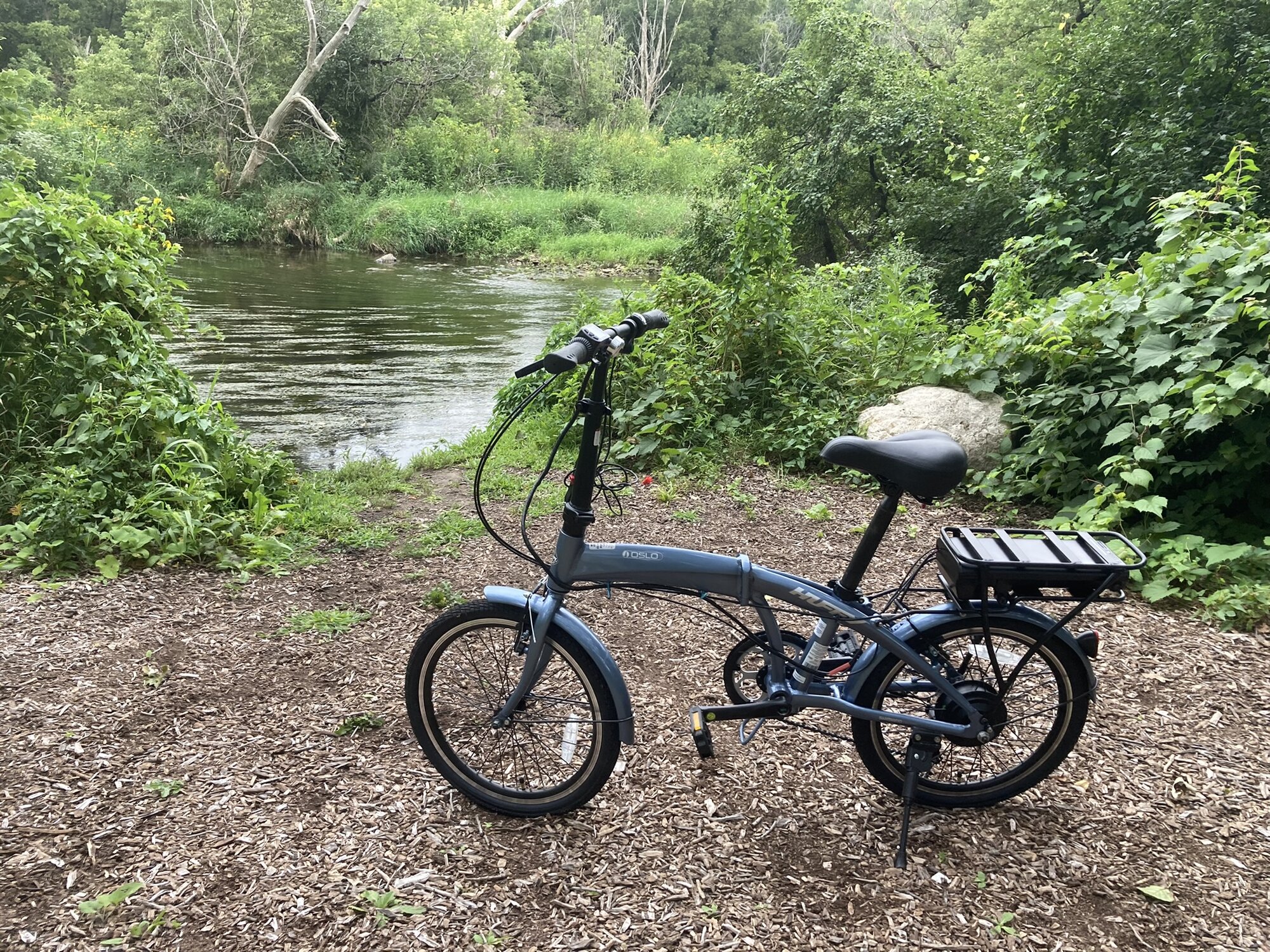

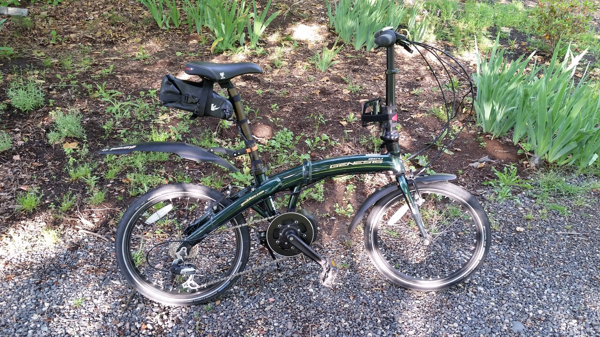

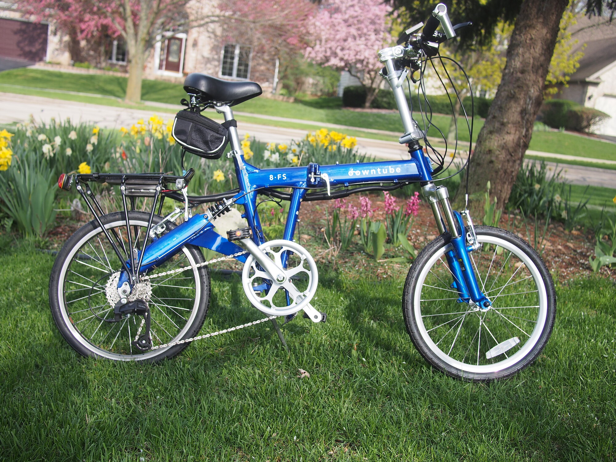

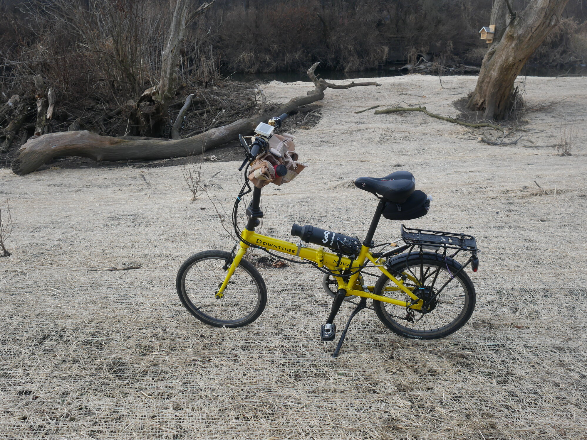

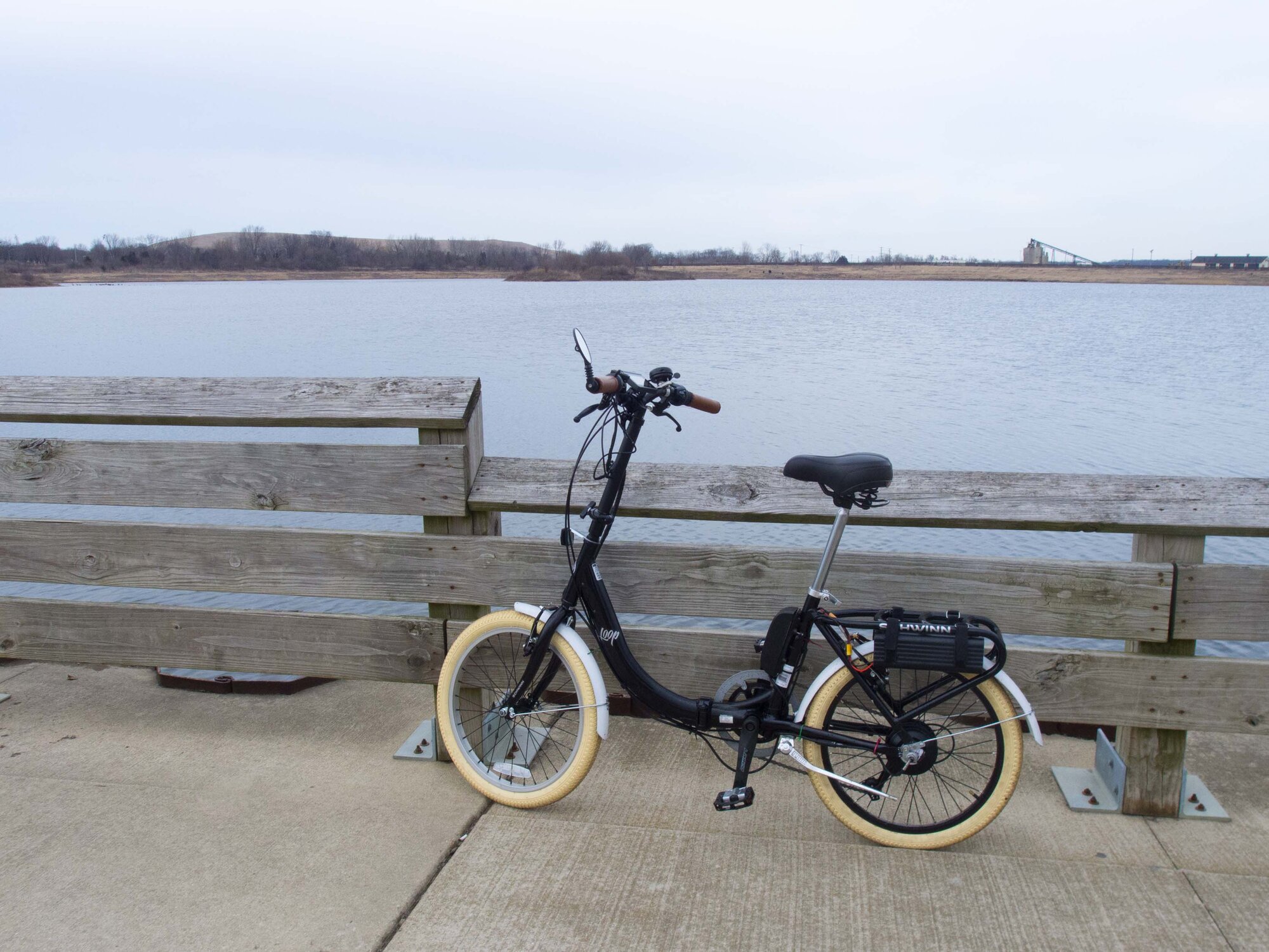

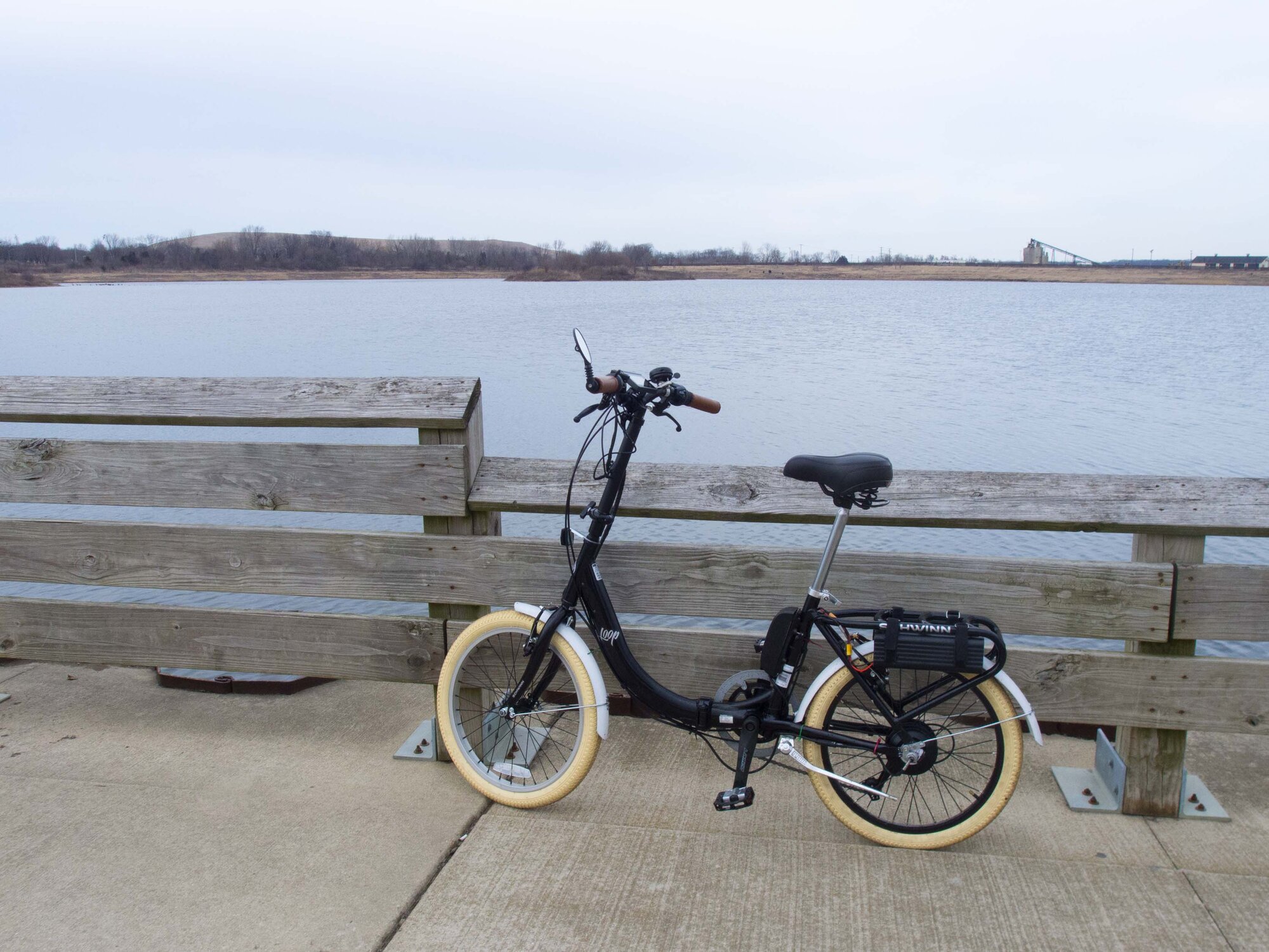

I'm in the USA, and currently have three DIY electric 20" folders. When selecting a bike, put frame integrity at the top of the list. See what's sold in the UK with a reputation for reliable frames.
My bikes have rear hub motors. The first one is store bought. Others three are my DIY. All 20" rear drive bikes. I had enough experience that I just bought the motor and electrical parts separately, not as a kit, mainly because they don't sell many 20" motor kits, BAtteries can be ebike batteries, custom batteries, or even tool batteries. They go in a bag on the rear rack, although the yellow one is using a frame battery, It costs me about $300USD for the motor/electricals, Batteries range from $50-300USD. In contrast, I bought the first blue one for $389USD complete as a working ebike, but spent another $100 to make it a good ebike, It just happened to be on clearance because it wasn't a good bike.
If portability is the main goal, consider 16" wheels, and DIY allows you to use smaller batteries as needed. You can have a spare for longer trips.
My bike weighed 35lbs/15kg. I could probably make it a little lighter with non steel cranks , a cambium seat and a carbon handlebar. Maybe shave 2lbs? The pedals could be lighter as well. Top Speed 36mph throttle only on a pure flat road and climbs hills like a goat. I live in nothing but hills so I needed a bike with the ability to climb well. This little bike didn't meet a hill it couldn't climb.

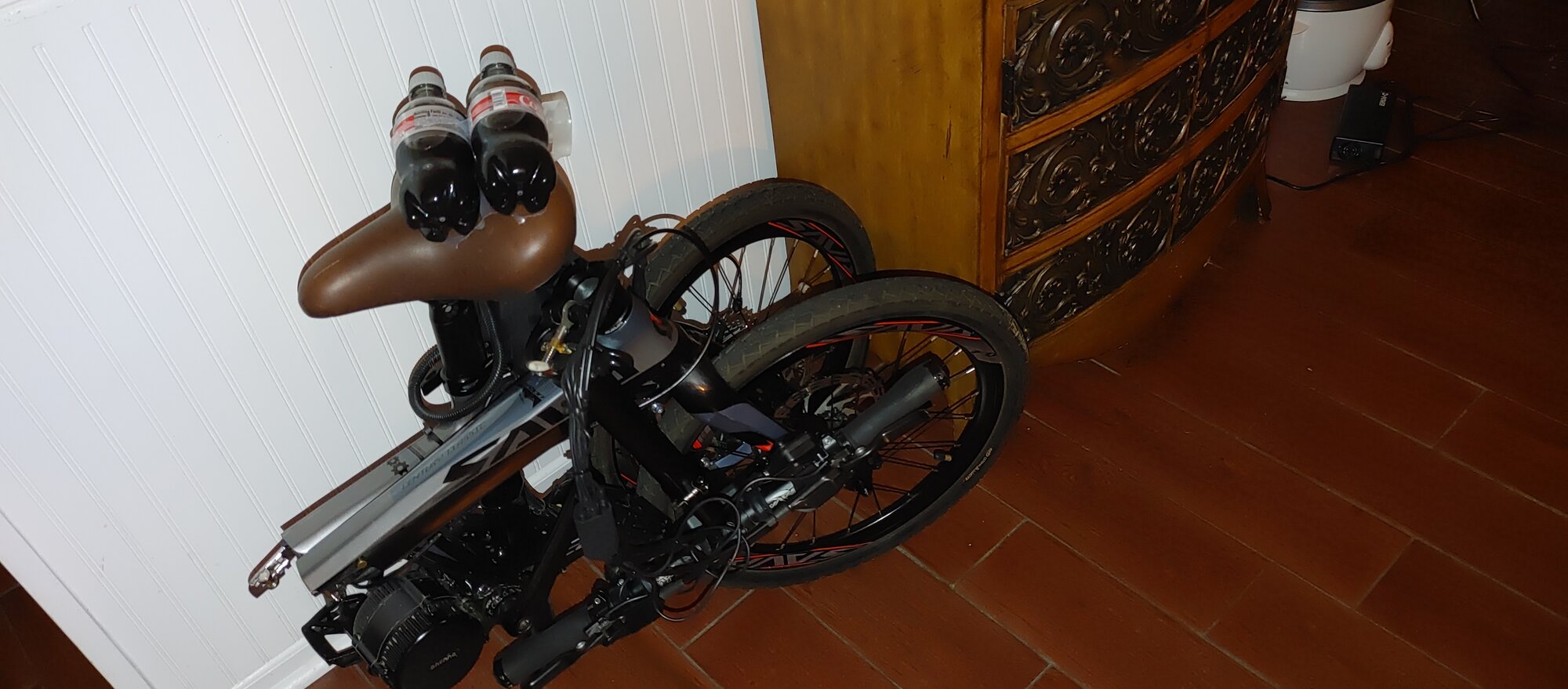

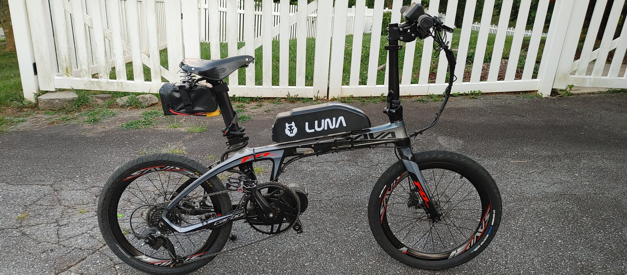

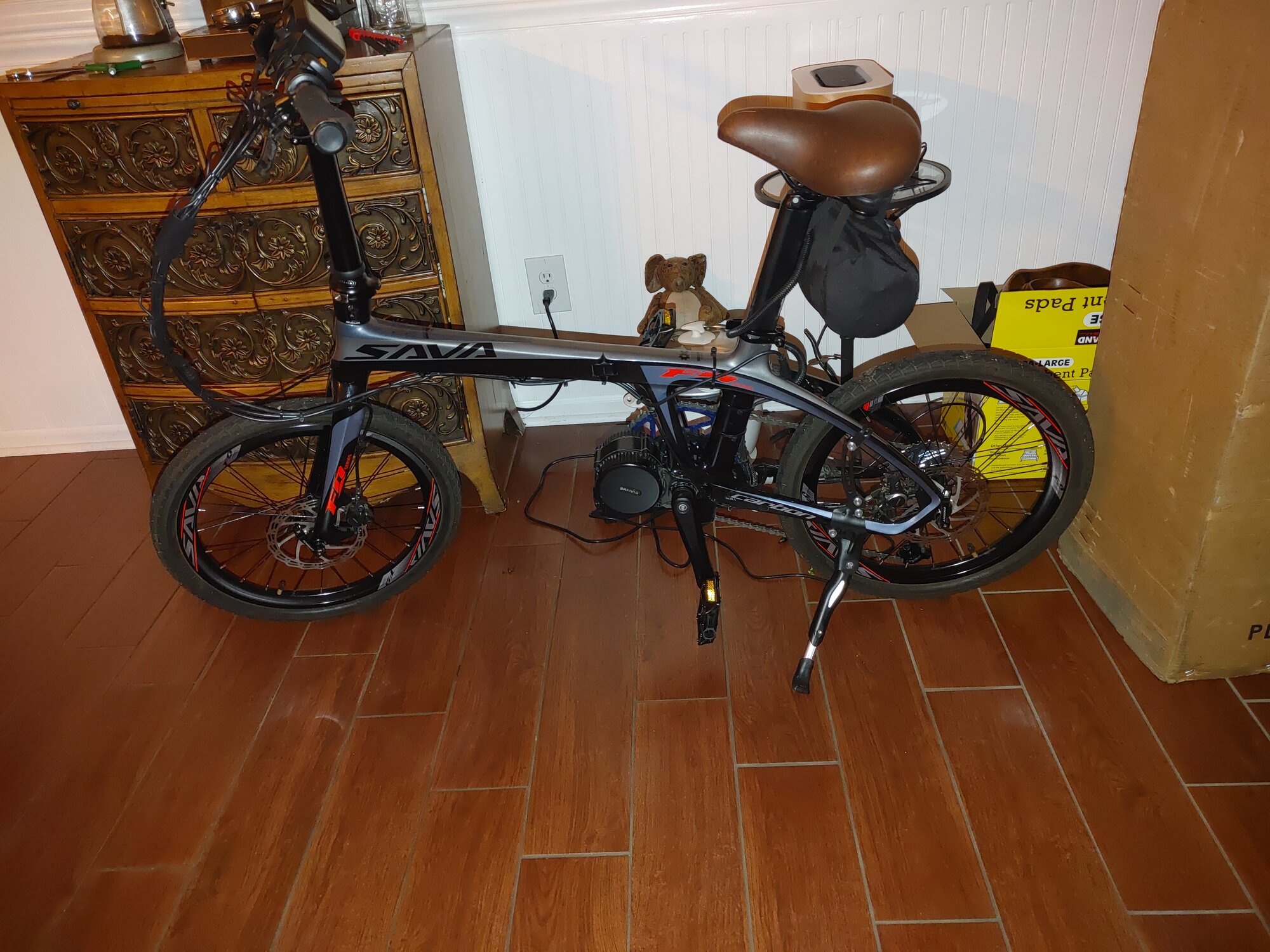

It's a cute unassuming bike but it felt like a V6 in a honda civic. 750 watt BBS02 and 52V 8ah saddle bag battery pushing 1300 watts max. These folding carbon fiber SAVA 20 inch bikes are pretty robust. I think they're running about $1300-$1600 on sale right now. I sold the bike on ebay to a private pilot who brings the bike on board his plane in a large canvas duffel bag.

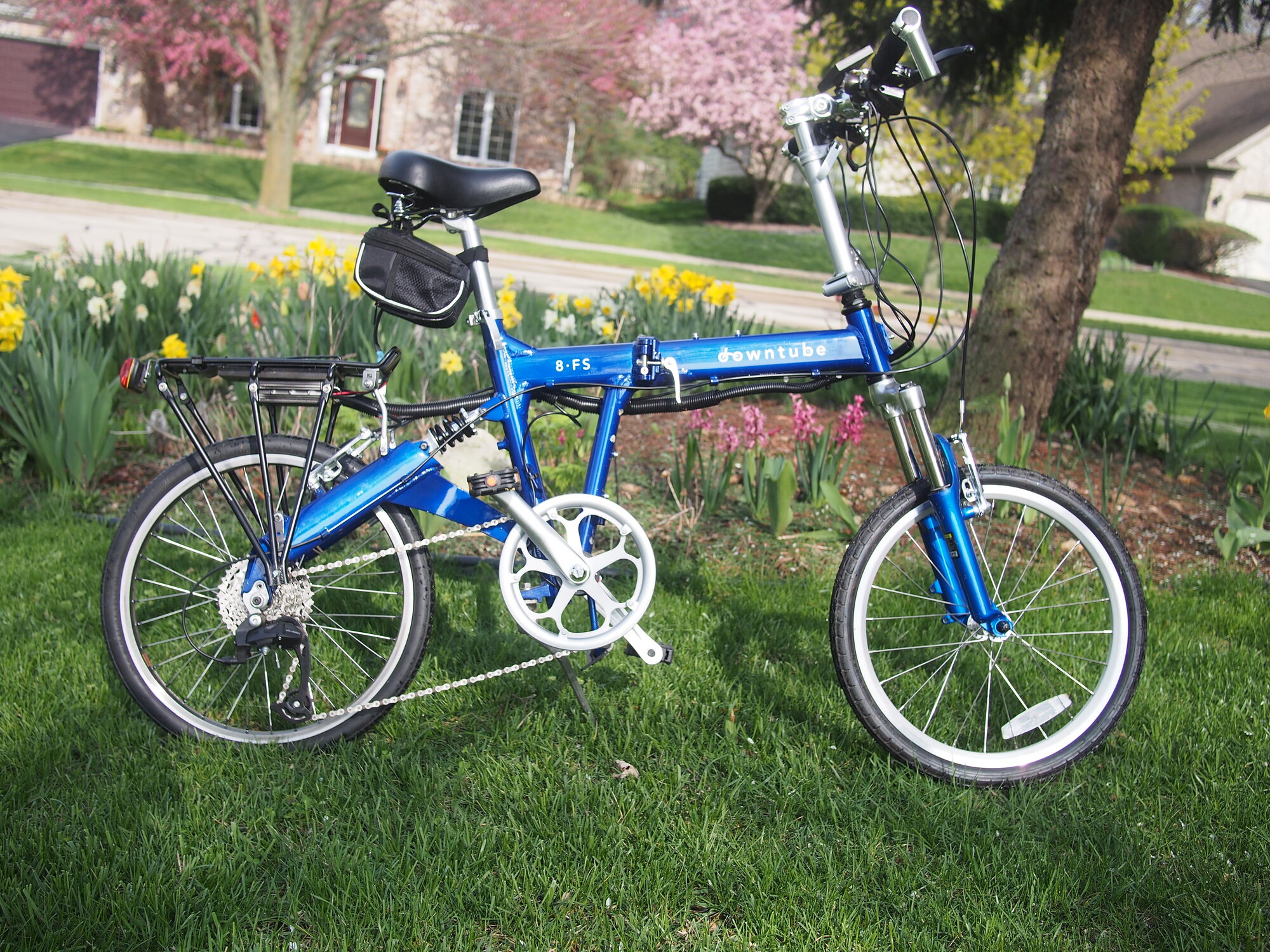

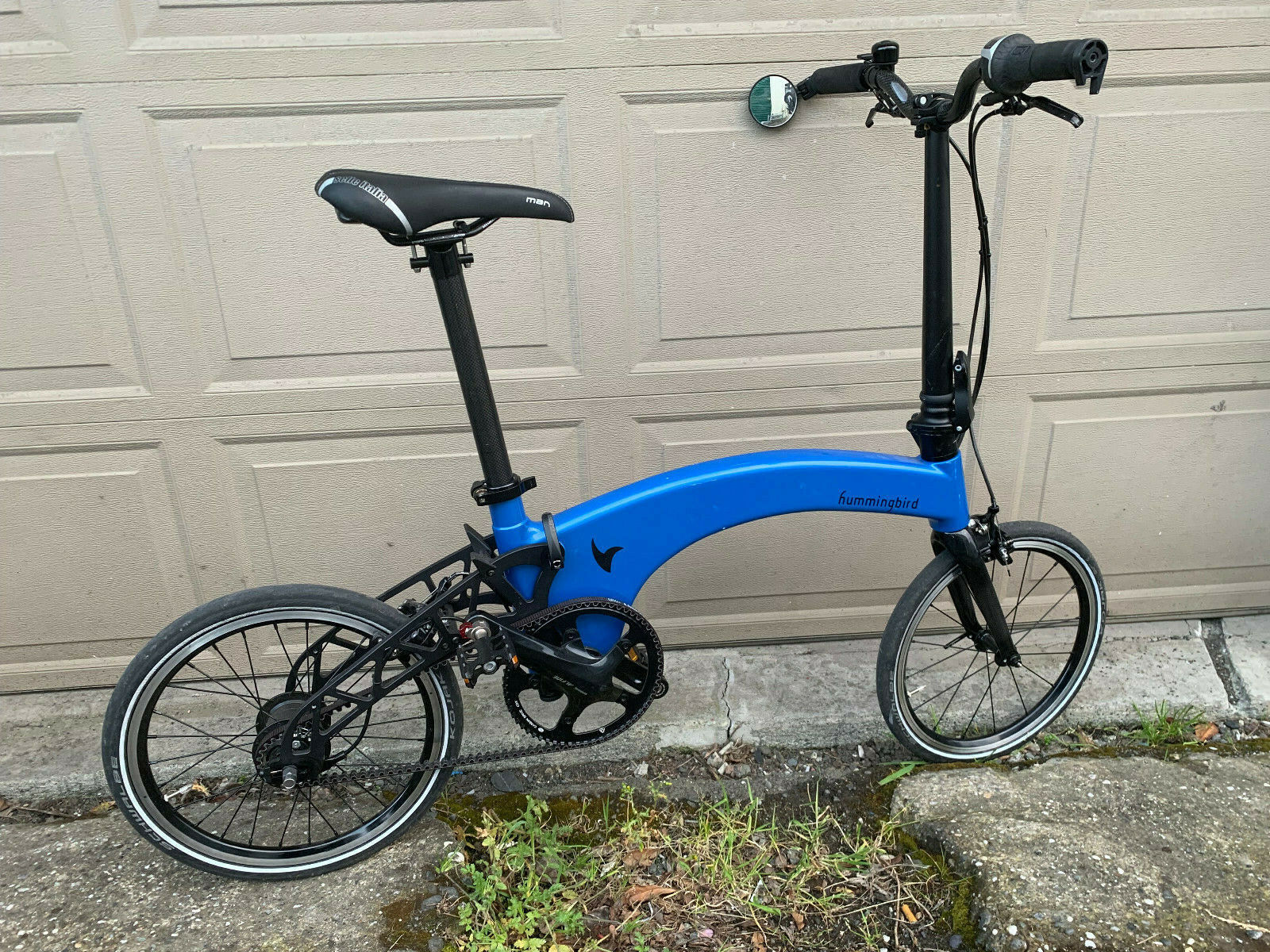

My next build I'm looking at the hummingbird folding bike (see blue bike) . Although they already make an e-bike version but it's tad underpowered for my taste. I'll probably do another BBS02 mid-drive or possibly a high end geared hub motor. Not sure yet. I like the IGH the hummingbird has and it has a standard sized bottom bracket. I sold my SAVA carbon folder with 600 miles on it with the motor and it ran great. I think without the motor and battery it weighed 22lbs.
HERE is the bike in it's final build state when I sold it with both batteries it weighed in at 22kg or 49lbs. This is the heavy version I could've made it lighter. Notice the heavy spring brooks seat and the heavy suspension stem. A really fun bike. I should have painted the frame battery black. Everyone thought it was a luna bike. It's not , just the battery was from luna.

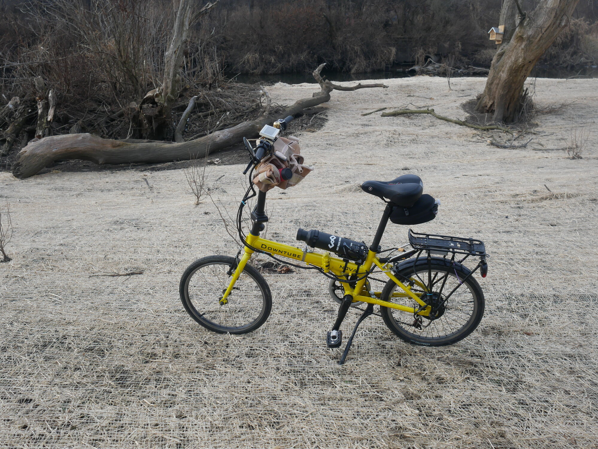

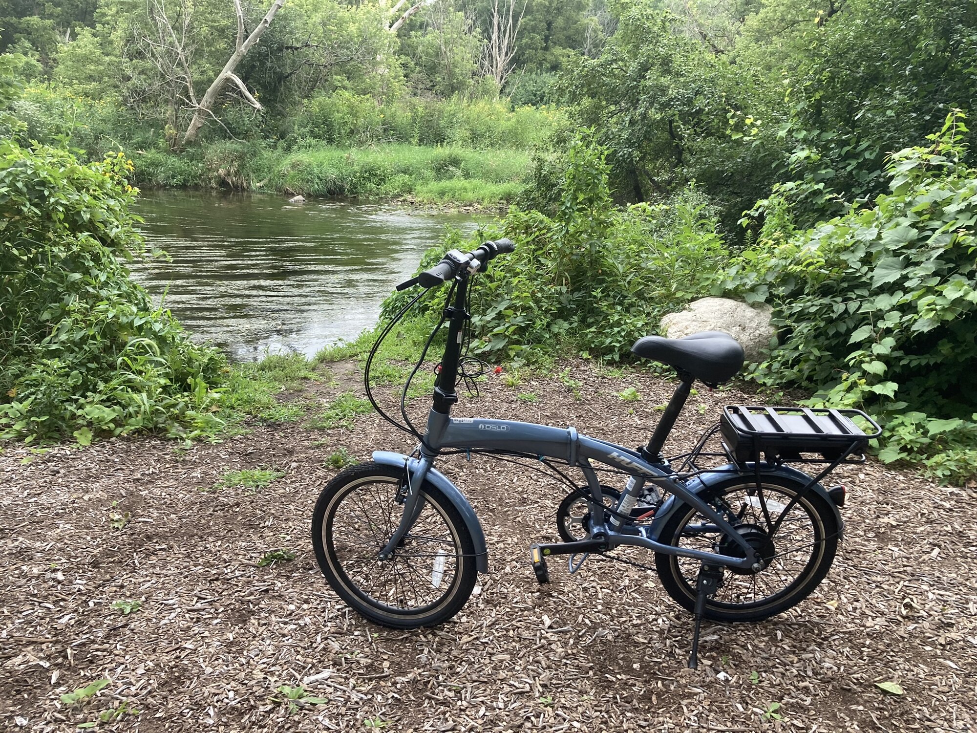

View attachment 140056View attachment 140053 View attachment 140054View attachment 140055

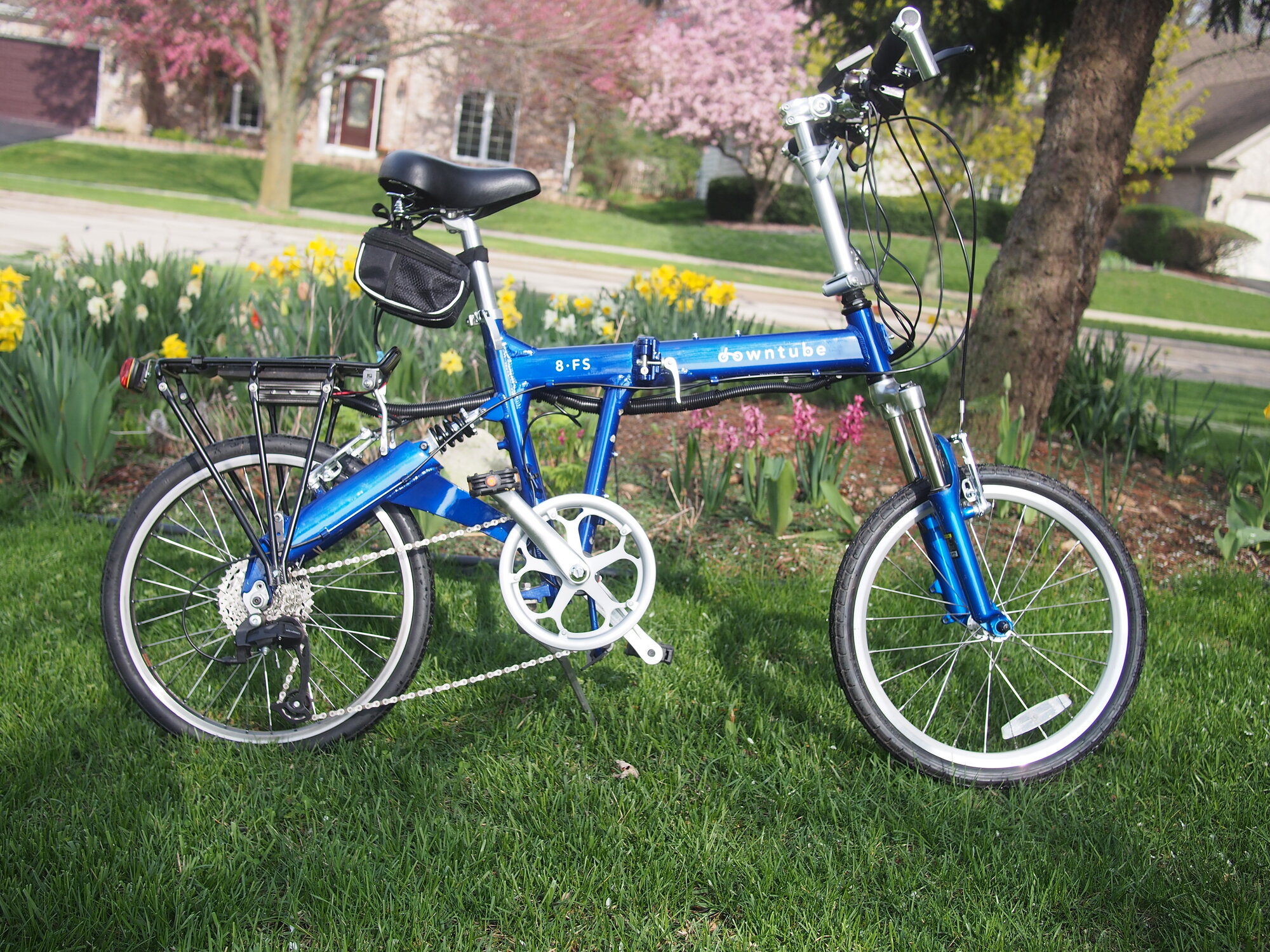

That Downtube fs folder is a nice looking bike, don't think I've seen that before!

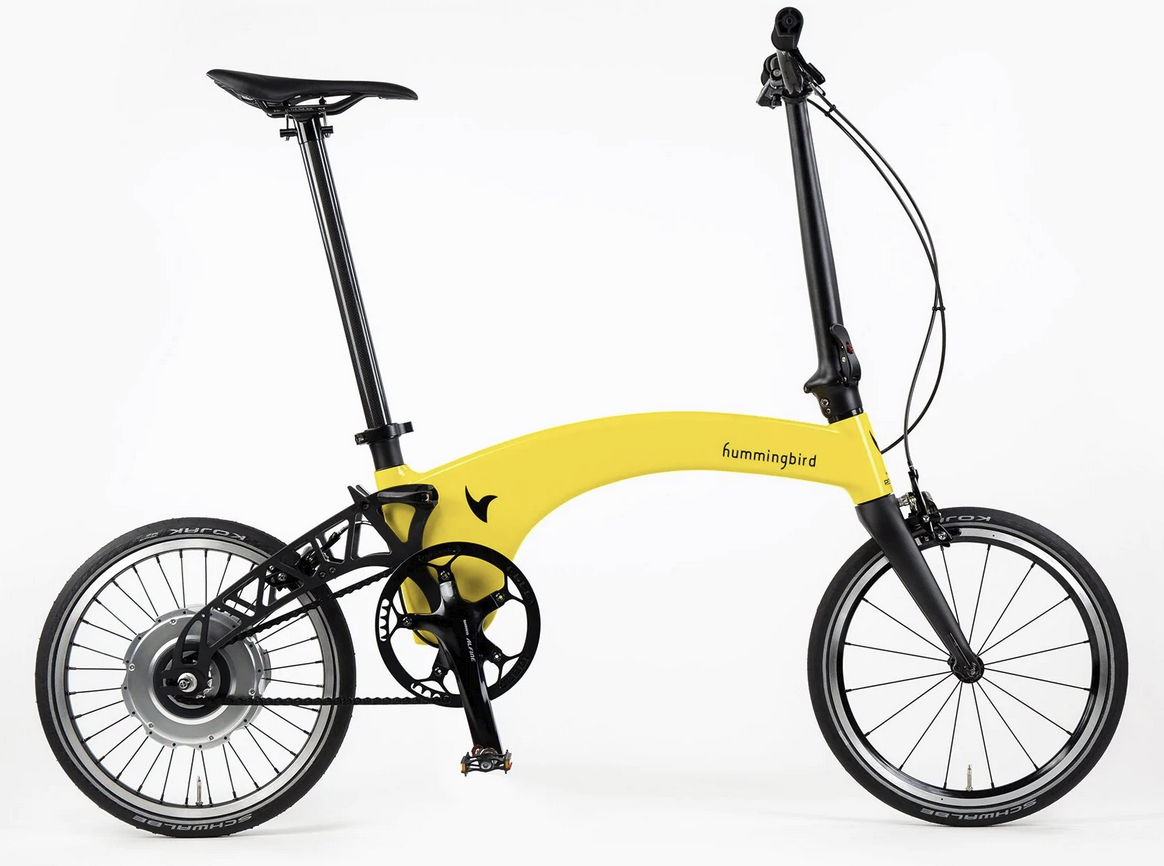

Then look nowhere else ,this is lightest ebike folding bike on the market @ 250watt , It's pricey but probably one of the lightest best built folding ebikes on the planet. You can upgrade the tires at checkout if needed.
Screenshot 2022-11-14 at 18-19-04 hummingbird-folding-electric-bike-gen-20hummingbird-bike-ltd...png

Sadly at nearly £5000 (or nearly $6000) it's just a few £ over my budget but thanks for the suggestion.
That's more expensive than a Gocycle, which is made in England. When you first setup the ebike with the app, you are asked whether to set it to EU or US regulations.
I just looked at the specs. It is quite a bit lighter than a Gocycle, but the battery capacity is half. I doesn't look like a good value, to me.
They (Hummingbird) claim 60km/37mi range with the battery and it's 16lbs/7kg lighter than the GoCycle. That's quite a weight difference.
*23lbs/11kg hummingbird vs *39lbs/18kg gocycle.

There was one (Hummingbird) on EBAY US without a motor for $3500 us/ $3000 gbp , I was gonna snag it but the owner went out of town and pulled the ad. I contacted him and when he gets back he's gonna contact me. It's the belt drive version with the IGH hub. I planned on installing a BBSHD on it.

It ran fine for me and braked quite well. In fact 600+ miles on the equipped brakes. I actually ran the bike on a small race track here in Asheville that looks like a small version of Daytona speedway with high banks. It was a closed track. I ran the bike at full speed with no issues. Was it scary , yes it was but I was in full gear, helmet , gloves ,pad , etc. I also only ran my bike on off road trails or long stretches of highway. I'm a respectable e-bike rider.
The bike in question cost $1600 new it's not a cheapo $300 bike. It's built by SAVA whom trained in Germany on how to build one-piece carbon frames. The new owner of the bike whom is a pilot and engineer installed an IGH hub. I'm awaiting his updates as we speak. I wasn't sure if he went rohloff or shimano 3-4 speed.
Furthermore you keep mentioning "Luna-tics" in reference to the e bike seller LUNA for which I have no affiliation with. ONLY the battery on the bike was from LUNA , not the controller , not the motor , only the battery and charger was purchased from Luna.
I hated the LUNA logo on the battery as I didn't want people to assume the bike was built by Luna. ONLY the battery on the frame was from Luna.
The steep hills that bike has gone down using heavy breaks and 220lb body actually surprised me , the brakes held up quite nicely.
This is the donor bike for my build as equipped from the factory. Nothing but the batteries , motor ,seat and headset were added by me.

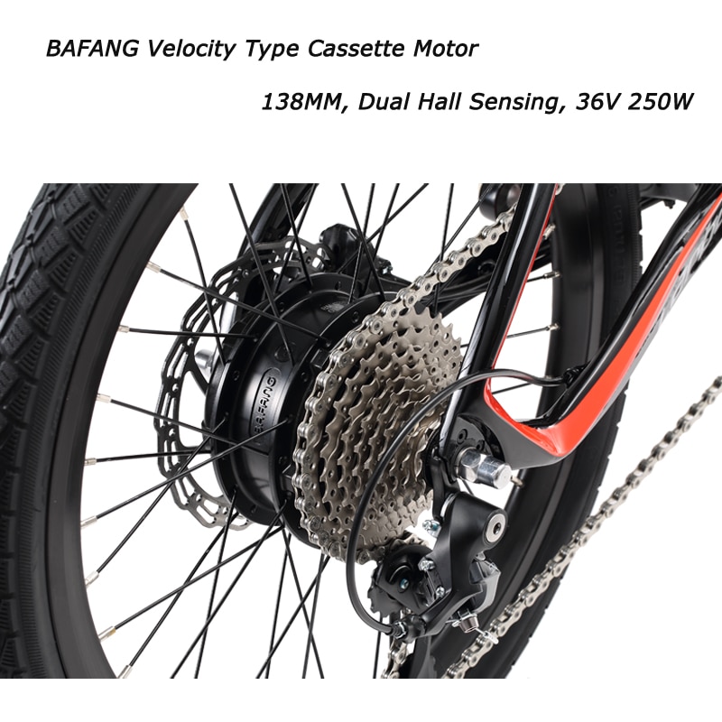

"thick" was referring to the almost hilariously thick and wide tires they put on mass produced Chinese rebranded e bikes. You often see many ebikes that have suspiciously similar frames with different vendor names on them. anyways I think I getting a bit off-topic there ,I apologize.
It appears SAVA has 4 e-bike versions , a rear hub drive , 2 front hub motor drives and a mid-drive version. Personally I would stick with the rear-hub version. I don't have experience with their front hub bike , that may be the one you're questioning about front fork torque?
The SAVA I had was custom built it was a normal version of their bike with an added 750watt BBS02 mid-drive motor. The rear square shape of the carbon frame held up nicely to the torque , no flex under load and fulling climbing wattage. They make very robust carbon frames.
On my bike even thin 1.65 tires handled all the terrain I used it on , but I added thicker 1.95 bmx tires when I sold it. Whatever use case scenario you think you'll need get the appropriate tire size but don't think you need overly thick tires. I'd say if you're planning on riding on the beach , snow , or possibly mud then think about thicker tires. I'm leaning towards the rear-hub version if you buy the pre-built. It's got the bafang version. I've never heard of the yuebo t400 mid-drive they use , maybe someone else can chime in. Their rear hub version is a good solid motor from Bafang.
Here are the two front hub styles , with smaller 14in tires/rim
