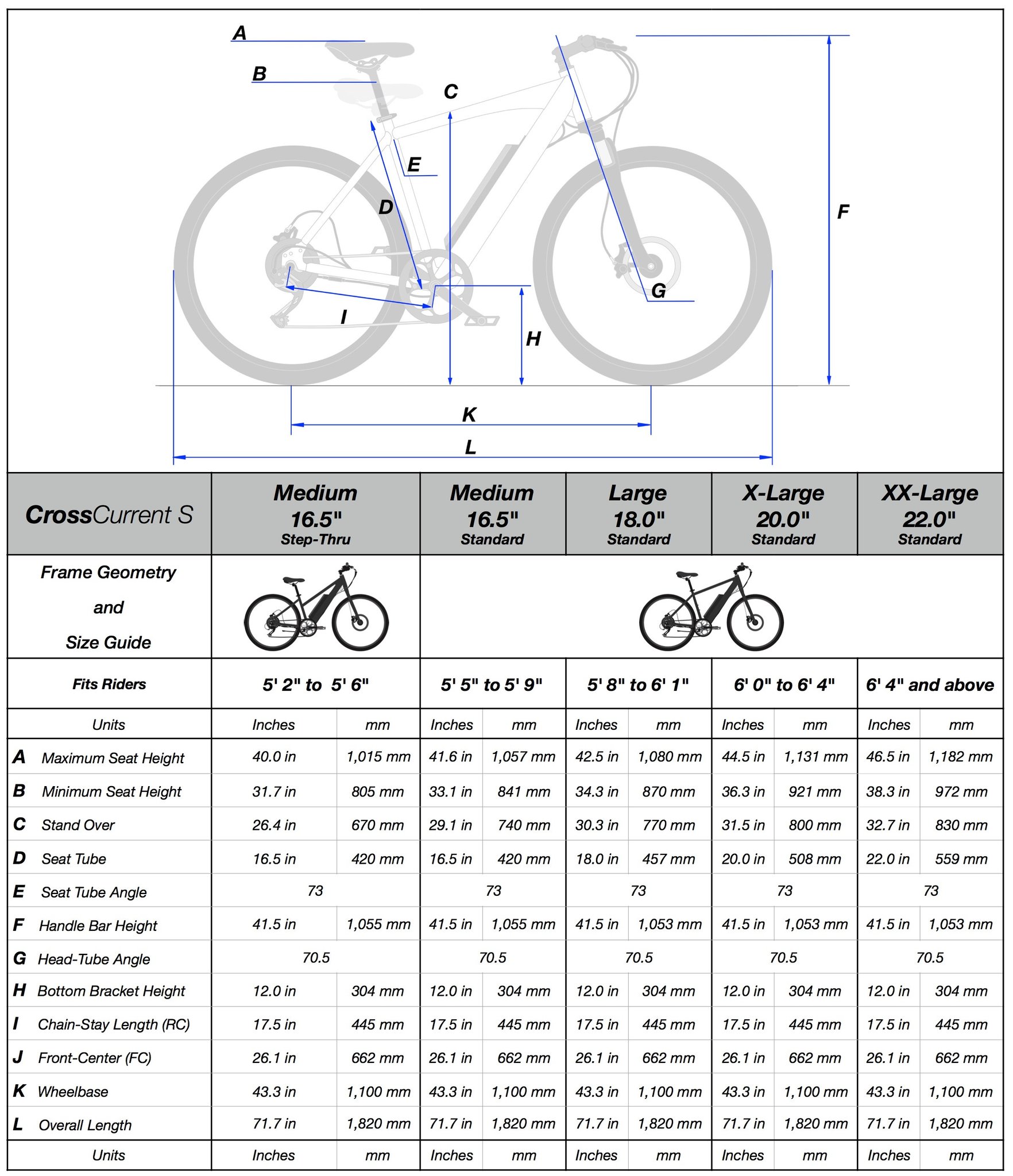

Juiced has frame size XXL
It looks like Juiced got rid of their XXL size now. I have a 35" inseam and looking for a bigger bike as well at 6'1" (in my case I think the XL would probably still work ok).
